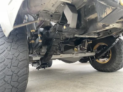

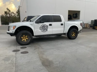

All wrapped up. Sitting a smidge high in back but also doesn’t have spares or tools back there. 18.5” total travel with 9” of bump travel. Can’t wait to try it out.

Looks great dude. You'll actually WANT to drive this thing off road now.
It's pretty crazy how many trucks look the part but still drive like trash... Took me a few trips but the new to me Ranger is finally fun to drive offroad!

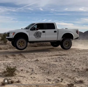

Took the truck to ocotillo this weekend to see how the rear felt. So much better, but now it needs more shock tuning. Front and rear could use some more compression...

the rear droops out like 69 more inches than the front now. haha

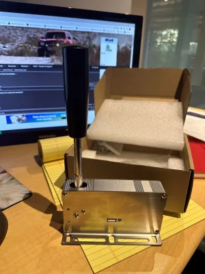

while i wait to see what i can do about my front end and pulling more travel. I am upgrading my shifter. I currently wired the manual shift to the buttons on my steering wheel. Well, those are useless when turning. So i am adding this sim shifter into the truck, which should work way better since i am use to art carr shifts. Lets see how dumb this thing is. lol
