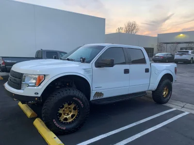

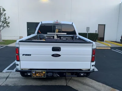

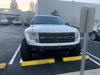

Since i am actually getting work done for a change on my truck, thought i would add a build thread.
I got this truck about 2 years ago pretty much as you see it. I wanted something i can take my kid and dogs to the desert in without having to tow anything. Had some ups and downs with this, but will try and provide a bit of my journey.
Specs
Front End: is a BMS mid travel kit with 3.0 coilovers/3.0 bypass and 2.0 bumps. Has kibbetech swing set steering with ram assit.
Rear End: is Currie full floater with deaver spring under and 3.0 bypasses with a kibbetech custom bedcage.
Motor: 3.5 twin turbo ecoboost, upgraded intercooler, intake, blow off valves with tuner
pros of this truck is it looks cool.
Cons: just had motor rebuilt, just had trans rebuilt, have gone through 2 3rd members in 2 years, and the rear end only has 4" of bump travel.
Its going to Richer racing in 2 weeks for spring under and notching the frame to gain more up travel in the rear. Then the front will get revalved again and full prep. From there hoping it will be good for the next year or two.

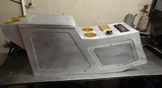

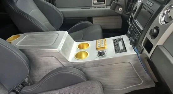

Here are some pics of the center console i had Jubera fab make me. Its now powder coated black.

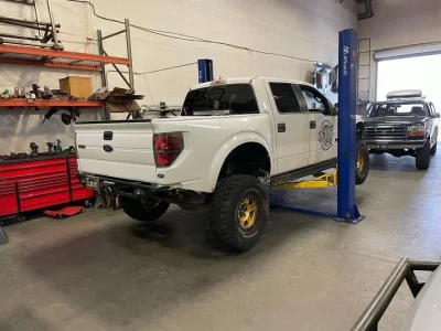

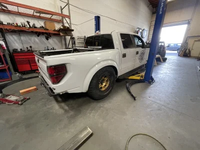

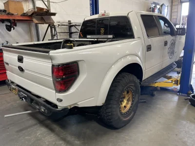

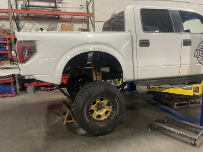

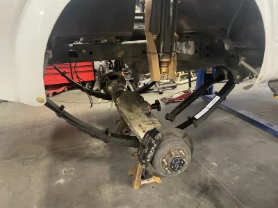

dropped truck off at richer racing yesterday and they are already getting it torn down.
I also am going to have a Detroit true track locker installed as about a year ago i went from an old detroit locker to a spool. I hated the old locker as it woudl lock and unlock at the oddest times, and would roll a good 6" when i put it in park. With only 3" to clear in my garage and no parking brakes i hated the old unit. Spool is so much nicer in the dirt, but this grocery getting is fucking annoying. So a new trutrack unit should fix it all.
Oh for Jonny. He is doing spring under and a frame notch. The truck originally only had 4-5" of bump travel so it was already riding in teh bumpzone of the shock at ride height. The springs were binding and wore out. So hoping the new set up works better for me.
