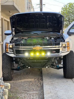

2008 Chevy Tahoe
Dirt king 4wd king travel kit
Wilwood brakes
EBC slotted rotors
Aluminum tie rods
2500 Hd front end swap
McNeil front fiberglass 07-13 Silverado

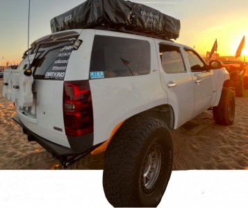

planning to put 4 buckets in it?
also..........

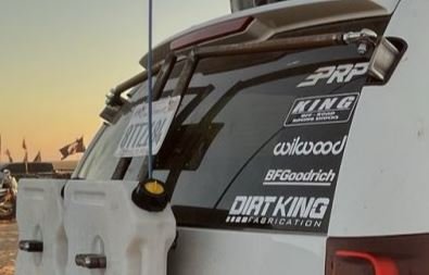

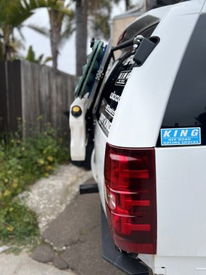

wtf is this contraption??!!?!?!??!?
Yup 4 bucket seats. Didn’t want the shocks going in the back seat.
Haha that is my traction board and rotopax fuel/water mount. It opens with the lift gate and allows me full access to the rear without having to lock or unlatch anything.

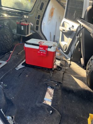

Passengers get a nice center console/cooler for beer with locking tumblers

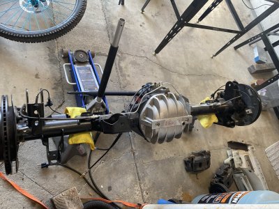

what rear end is it? I was always curious if an H2 rear end would bolt up fairly easy to an SUV
And pics of the rear suspension as it is now?
It’s a 14 bolt SF out of a Escalade ESV. It bolts directly in. Every bracket is the same. You can find the axle under any GM SUV with a 6.2 or 2500 versions. But all the trucks and SUVs are built on the same frame. The SUVs just have a different rear suspension which is why they are called GMT920/930 and not GMT900 but all built around the GMT900
The reason I say H2 is the rear links are all the same part numbers, just never had a chance to measure the bracket spacing on an H2 to know if it was a feasible swap. I know it’s 8 lug but it wouldn’t be hard to get a set of shafts made
