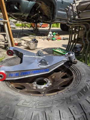

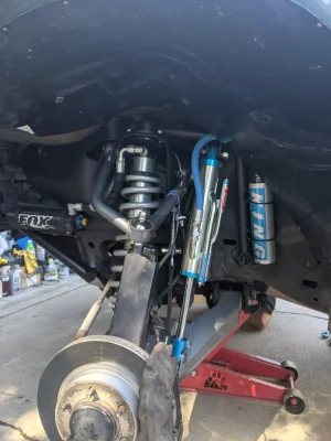

I knew for a while I wanted to long travel this truck. Friends were trying to get me to fully link it. The idea was tempting, but I really enjoyed the 6ft bed, both for sleeping in, and truck life.

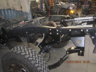

Thankfully there was a solution! The wonderful and brilliant boys at RJ Fab had come up with a cantilever kit, and my heart was set. I was able to plan it with those amazing guys to get the whole rear end done while I was away for work. And they absolutely killed it.
Best part was the truck still looked stock. No way to know she's packing ~16in of travel in the rear.

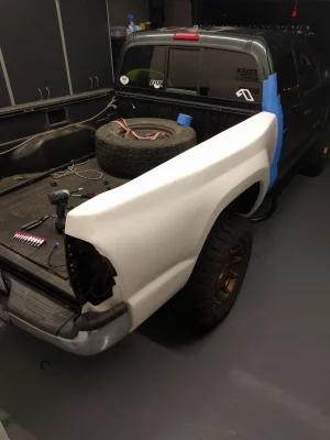

I managed to come across some McNeil glass on tw, so that seemed like the next logical step. IMG_20190116_180115_01.webpIMG_20190204_151323_01.webp

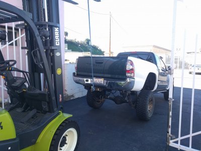

A friend with a forklift let me play around and really see just how much travel there is

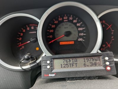

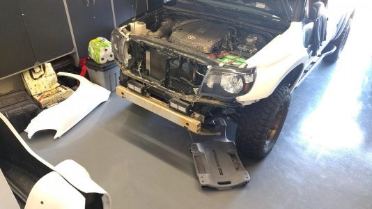

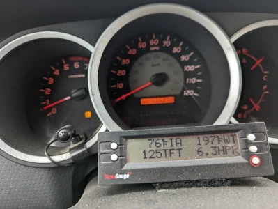

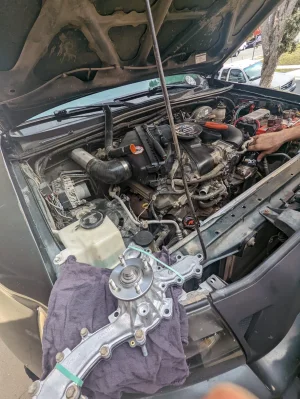

After having consistently high coolant temps during the desert cleanup, I decided to bite the bullet and swap to a larger radiator. Thoughts that my skids and glass were making it hard to keep cool.
Turns out, that wasn't the problem...
With 136k on the clock, my next guess is a bad water pump. So now we wait for parts to arrive, and hopefully push the worries away.
As usual, more done than actually posted...
Threw in a new water pump and lower t-stat right before the holidays. Finally got the radiator buttoned up. Only took 3... (Thanks UPS for your wonderful handling policies.)

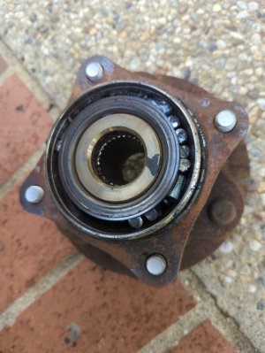

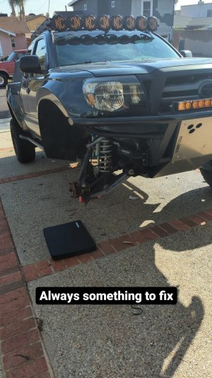

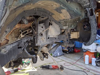

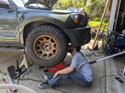

Then this morning I had the joy of a wonderful grinding noise that could be heard from a block away as I tried to pull out of my driveway.
Turns out my wheel bearing was completely shot... Spent the morning swapping that sucker out just in hopes that I could go smog the truck.
All in all its a small price to pay for running around and chasing the Bad Lines Gang.
Probably time to change the other bearing as well!
I bet you are stoked you caught it around the corner from your house vs in the desert.
Are we going to see you at KOH?
Gotta order another one. I guess I got lucky because the local Toyota dealer only had one in stock.
I'm willing to bet that Barstow trip really put the death rattle in it, but yea very glad I caught it at home.

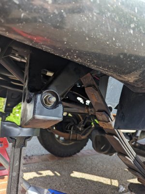

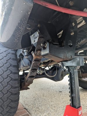

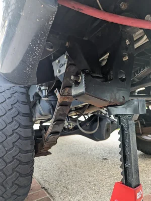

Since I've been talking so much with Camburg, I was finally able to get them to give me a hopeful fix to an ongoing problem. The shackles that were put on the truck have never been square. It's not that far off, but considering how often I have to pull stuff apart, it's definitely not helping.

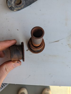

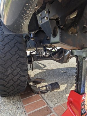

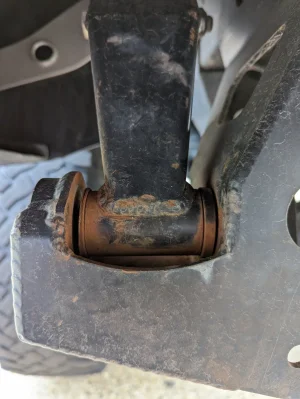

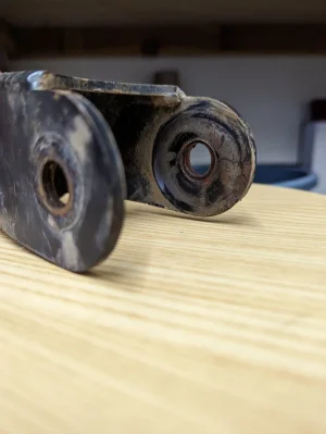

The rear shackles love to eat bushings. Been averaging about 12k on a set. Spent the last two days under the truck tearing down and replacing some definitely worn out bushings.
All nice and wallowed out. The driver side was completely worn through.
Hopefully the new set of shackles makes these bushings last a little longer.

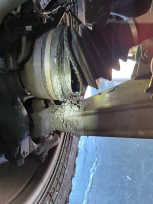

Finally back in the states. I pull the truck out to change the oil and find a hole in one of my CV's.
Ended up swapping out both sides with some new orange boots form the guys at RCV.

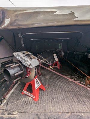

THEN THE DAY FINALLY ARRIVED! After months of waiting, I finally have my Camburg rear axle at home.
I can't even say it's in the garage yet. Still not sure how I'm going to get the behemoth out of the truck bed. Time to learn how to tear down a full float axle so I can get the housing prepped and painted for install.

Well it was redeemed haha. Still not sure who how or when it'll be installed. I have a stack of parts that's been growing for 9 months since I placed the order. Doesn't mean it all won't end up in the back of a cabinet. Hopefully not though. I can use the regear.
