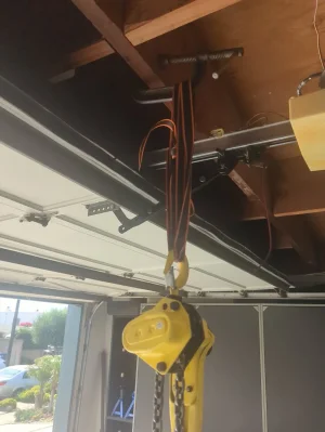

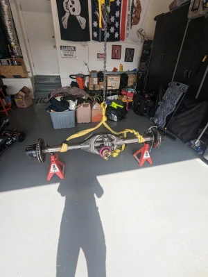

Out of the truck and on to a dolly. Only took some sketchy rigging and trying to remember what I learned in my knot tying class in college
View attachment 12766View attachment 12767
Brooooooootato...Were you listening to Bon Jovi " Living on a prayer" at on 23 while you were tightening that C clamp!
I'm with you brother. hhaha
It was a little nerve wracking. Especially since I was the only one home, so I had to hope it didn't shift on the sling as I was pulling the truck out from underneath.

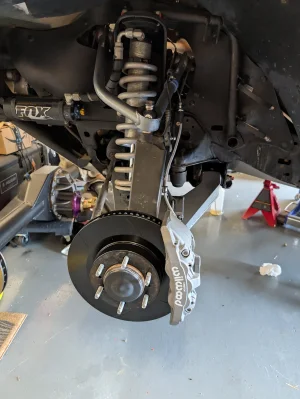

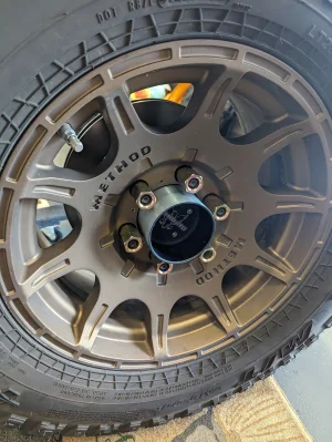

Some small updates. Won a Wilwood care package at the '23 cleanup. It helped me finally push to do a big brake kit on the front of the truck. Also got some preperation done for the camburg axle to be installed. Upgraded to a tundra master cylinder and brake booster, and had a friend shave down the axle snouts to fit a tacoma wheel bore.PXL_20240826_175943876.jpg
