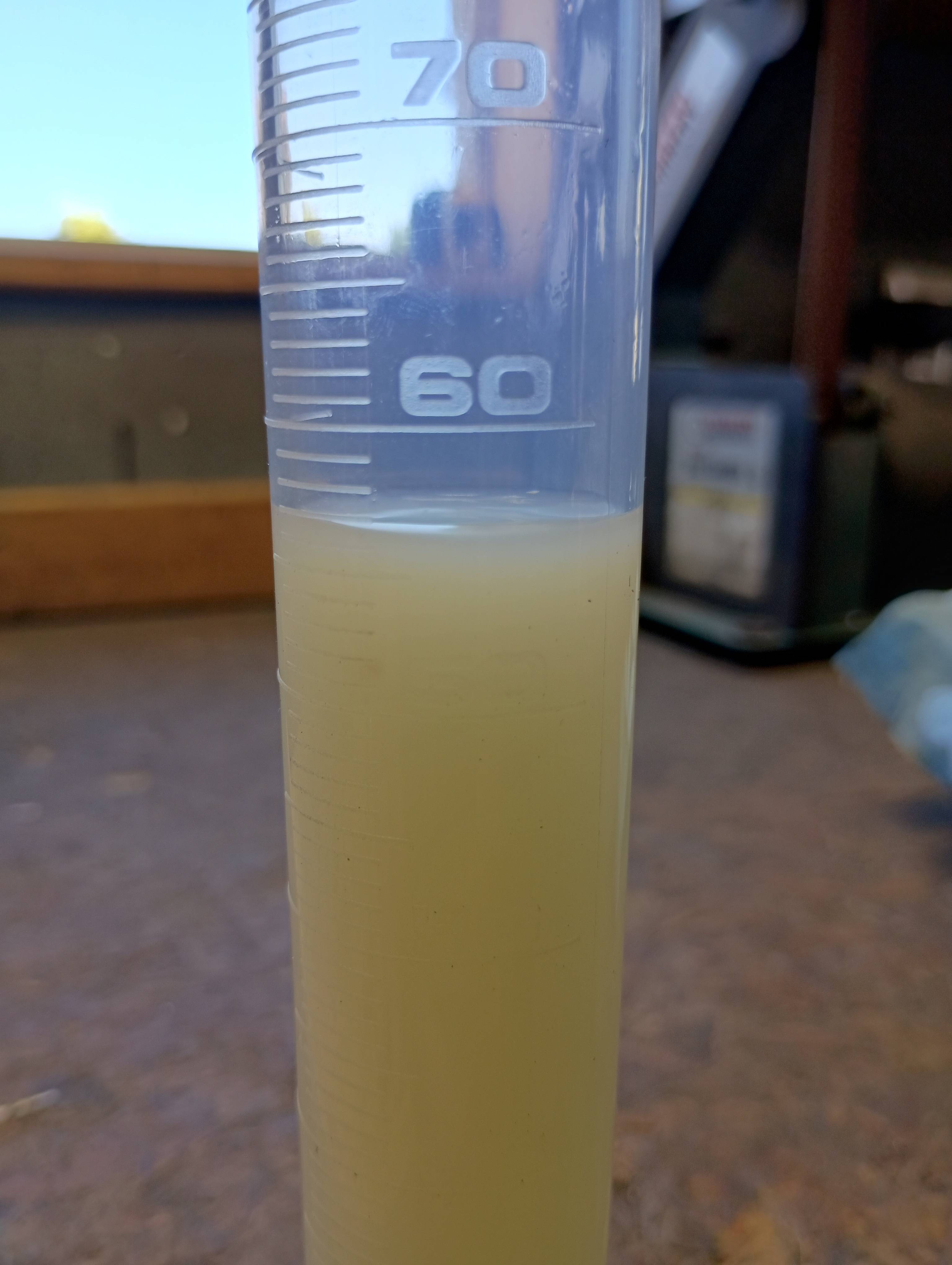

tested the china (advertised 42lb) injectors off ebay
got 57ml on the tester ~ 35#
pattern was nice and volume was ~4ml variance
i doubt these are where my tuning issues.....
i installed and test drove the de-capped ford's. drives real nice still and will make a couple pounds of boost. it starts to fucking RIP for just a moment and then falls flat still. i think coils!
ford 38ml = 22#
de-capped ford 94ml = 55#
chinesium superjectors 57ml = 35#

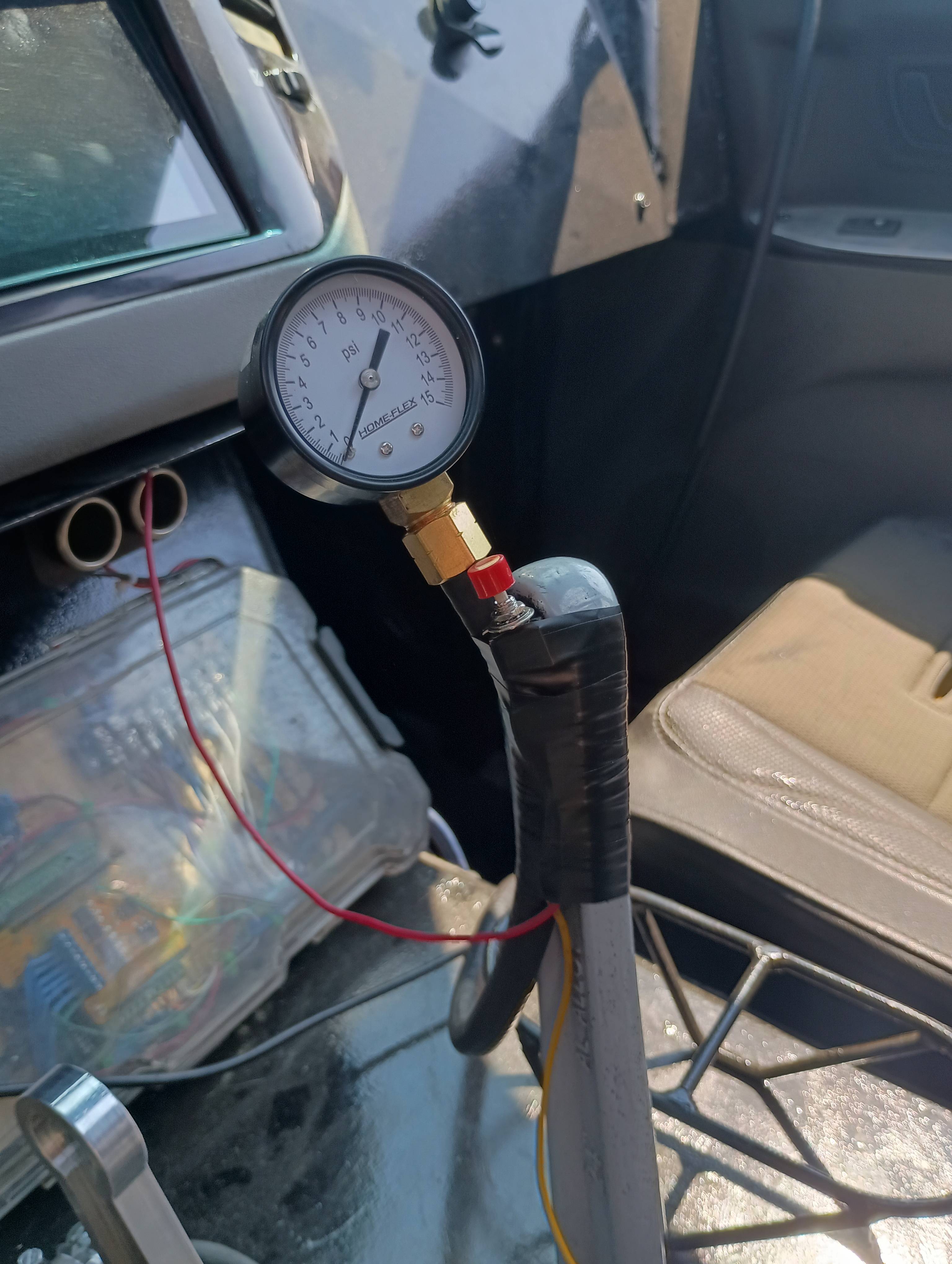

man, this motor just still runs restricted!!!!!! wtf
the little turbo is spinning its little guts out and i get like 5psi
should be fucking blowing the jewels right out the bottom of the motor :unsure:
i am about to bypass the intercooler to see if it is full of shit
my 4.2l and 66mm can run 15 at half throttle. :giggle:

I'm going to hook up a pressure gauge before the intercooler tomorrow. I feel like it is a massive choke or something like that....
Like there is no throaty air sound on the motor while driving and grabbing a bunch of throttle. Just mute until about 4000. If I shift low enough and it dips under 4000, the turbo just stalls out and the climb begins again.
