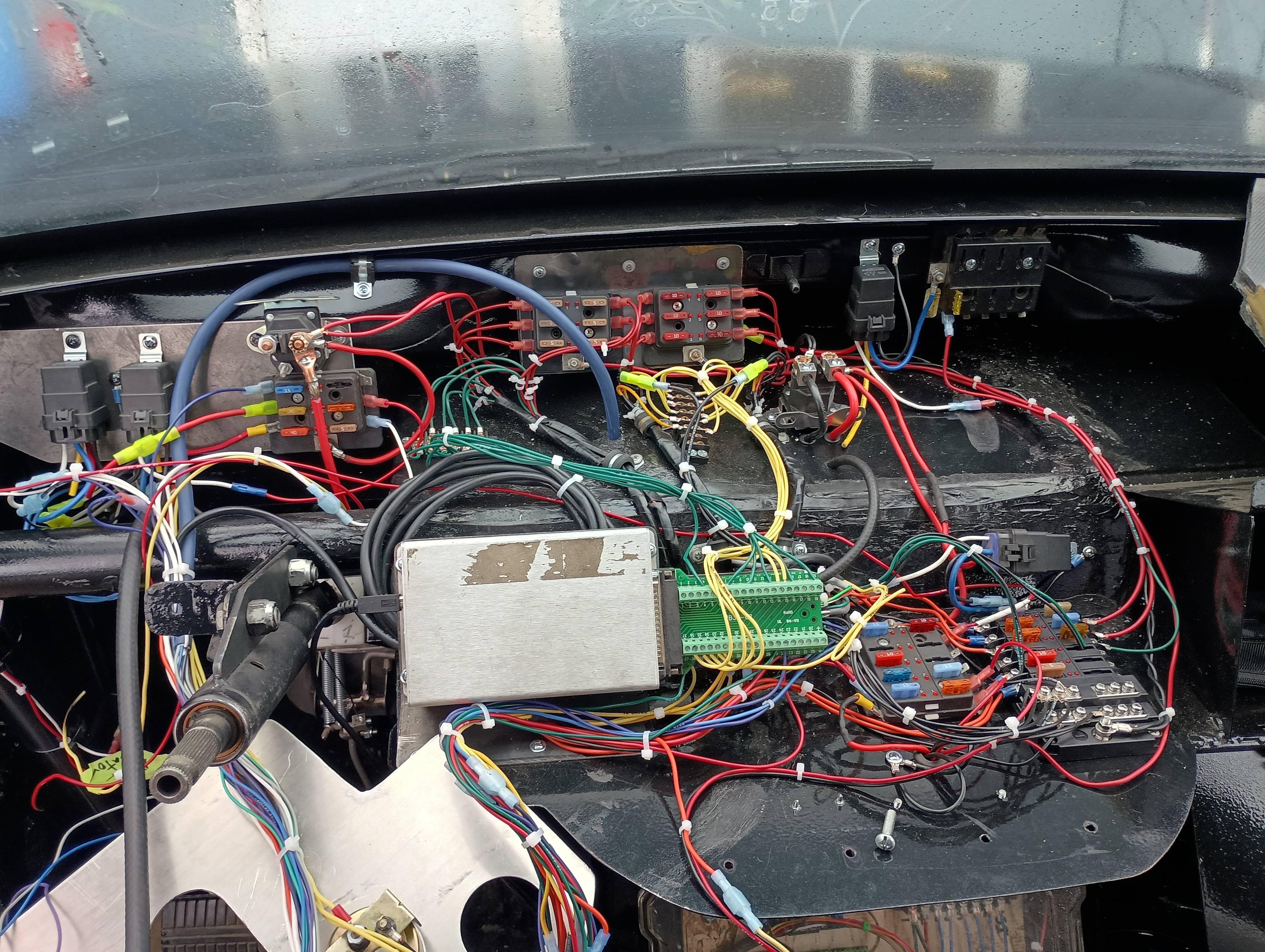

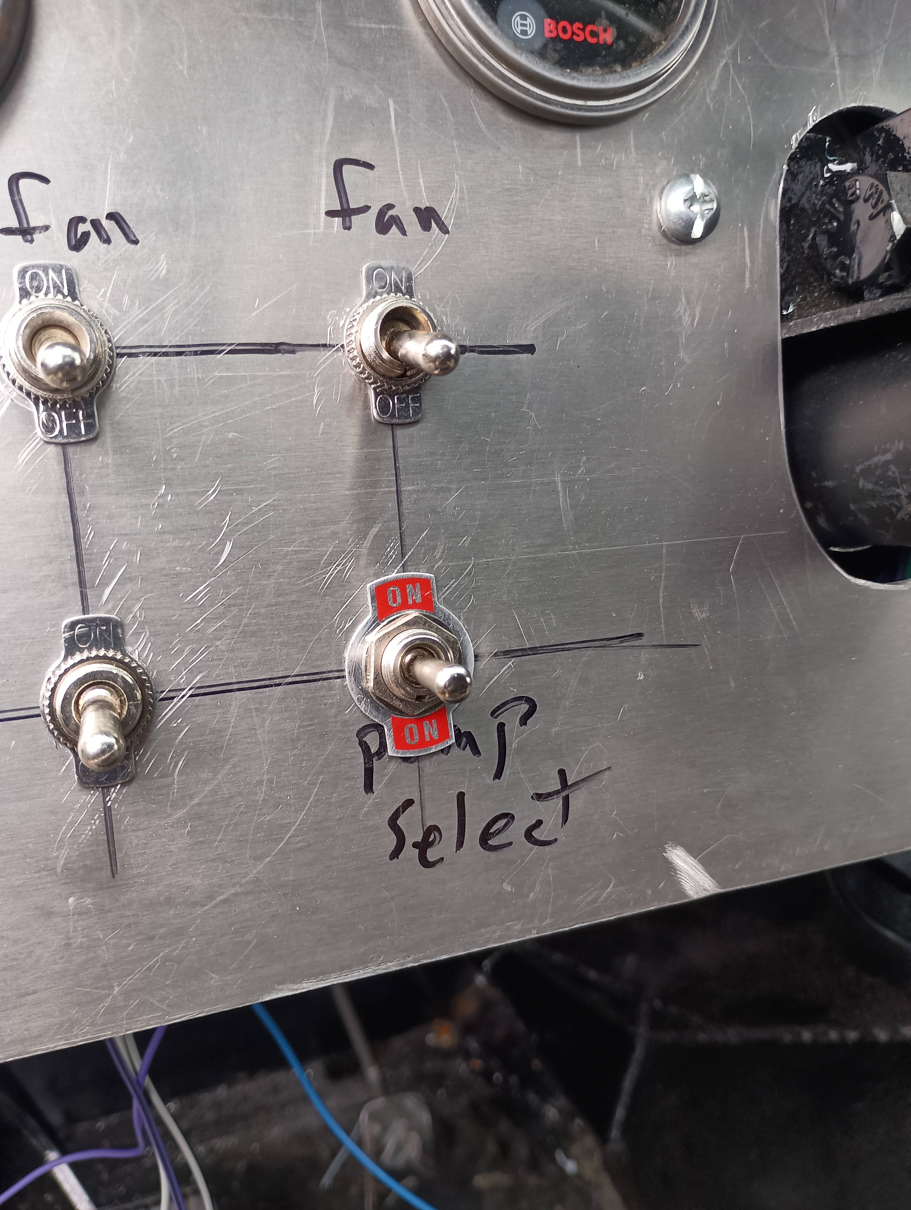

i really enjoy wiring. it is nice to make things super easy to reach and check out. the courier never had any issues in its years.
the dash panel comes off with 2 screws
the main dash has 4 small sheet metal screws and it pulls right off
1 dirty alternator power for dirty little 12v pigs ( fan motors, big lights, ect )
2 injector fuses
3 COP fuses
4 clean right off the battery tit
5 clean 12 volts
6 clean switched 12 volts

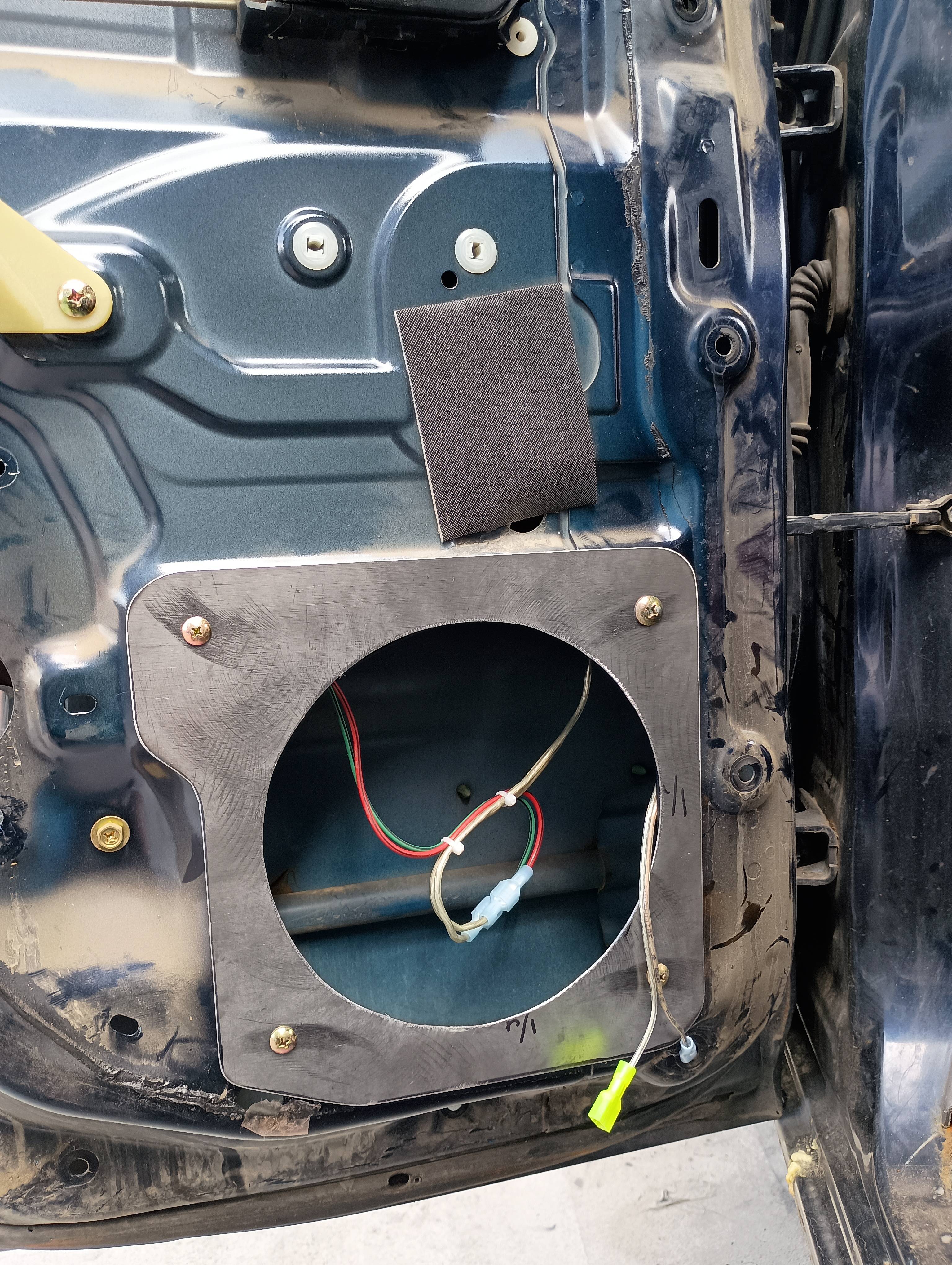

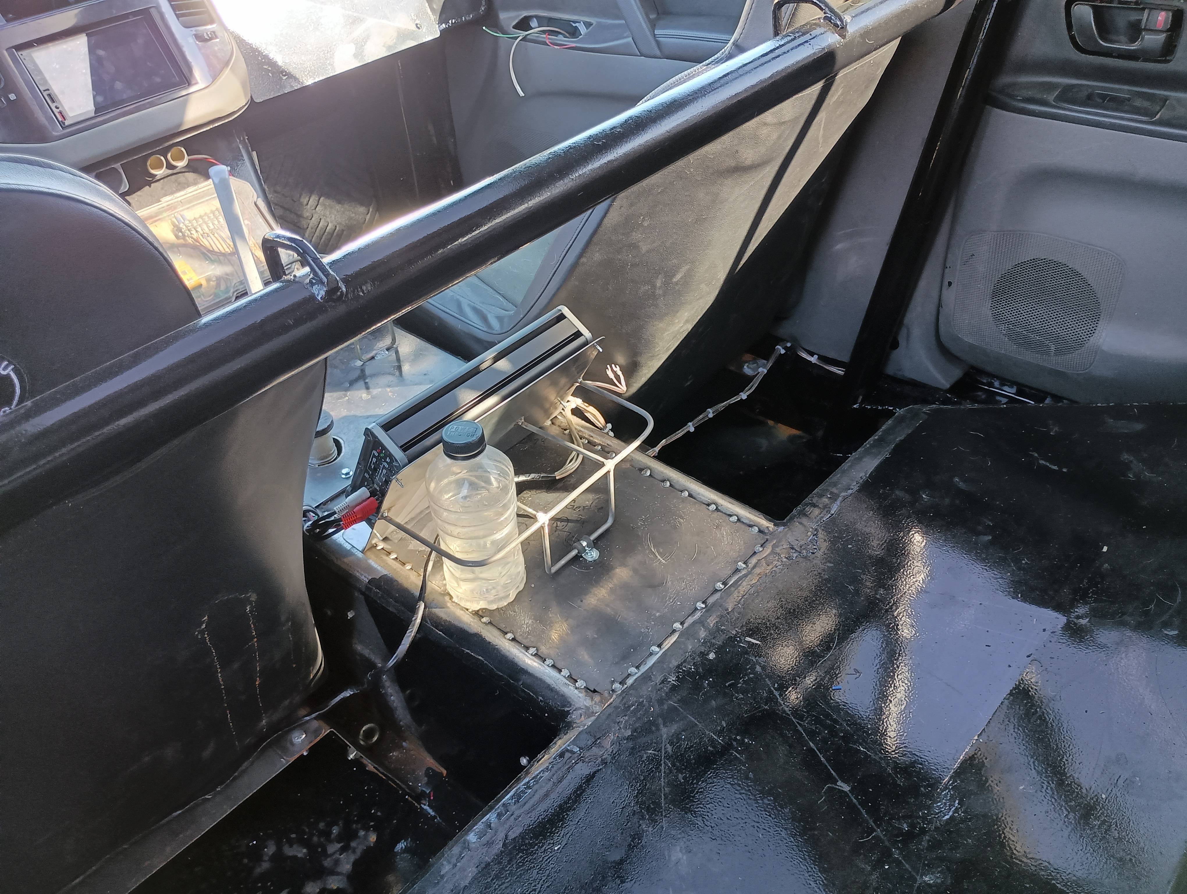

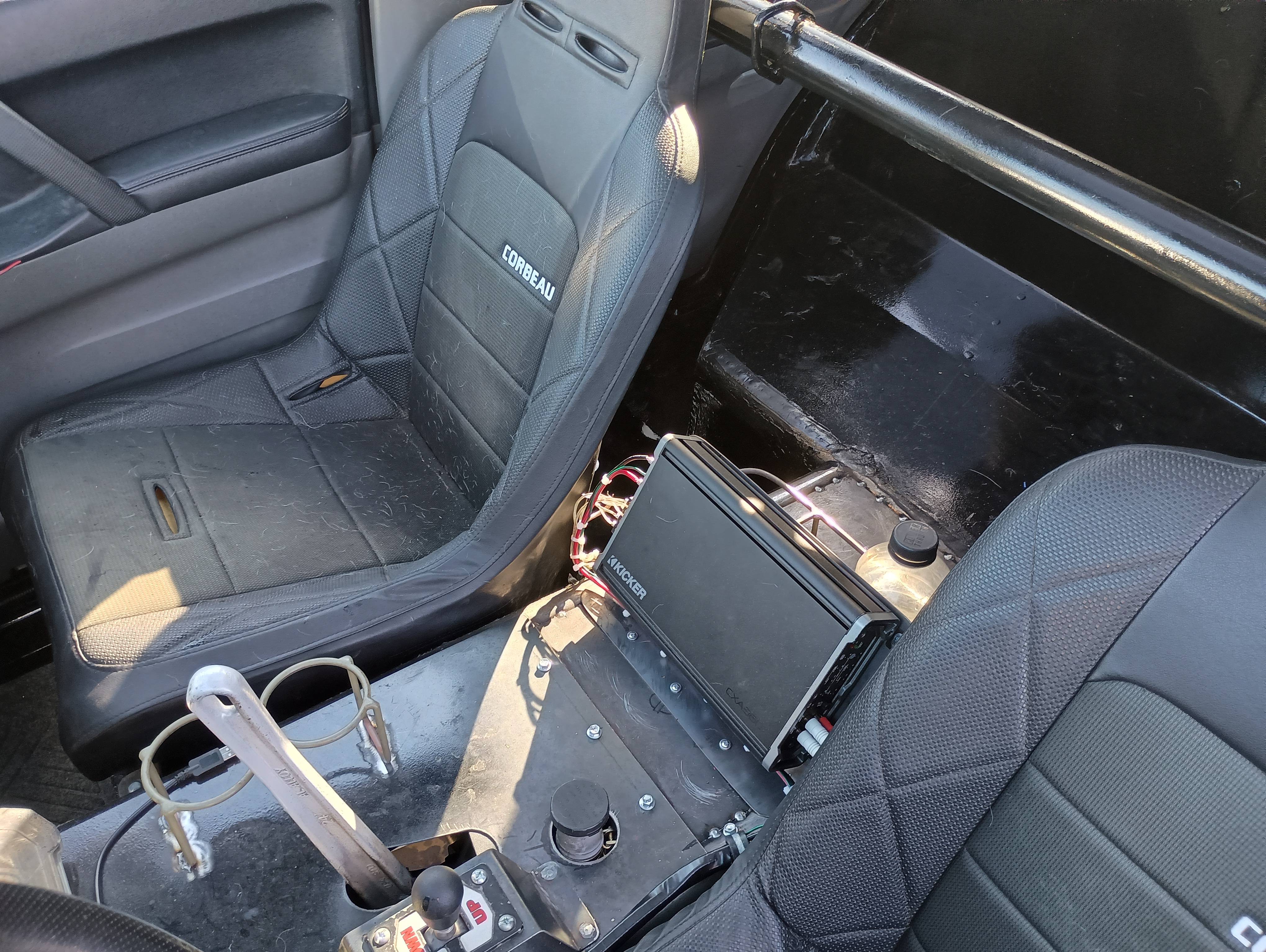

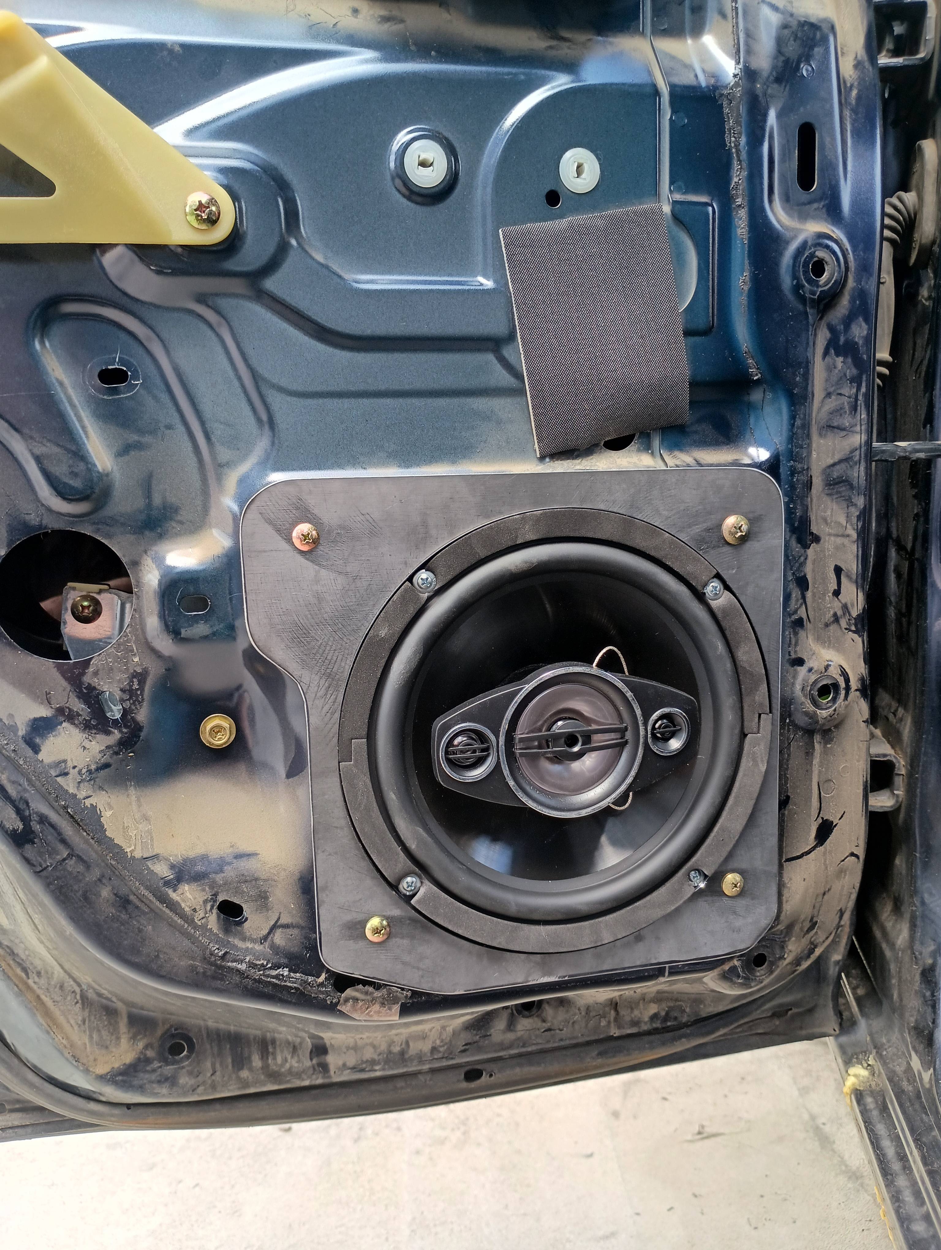

got the amp mounted and double duties as a rear cup/bottle holder
just need to get the rest of the cable clamps in there for the speaker and power window wire harness
