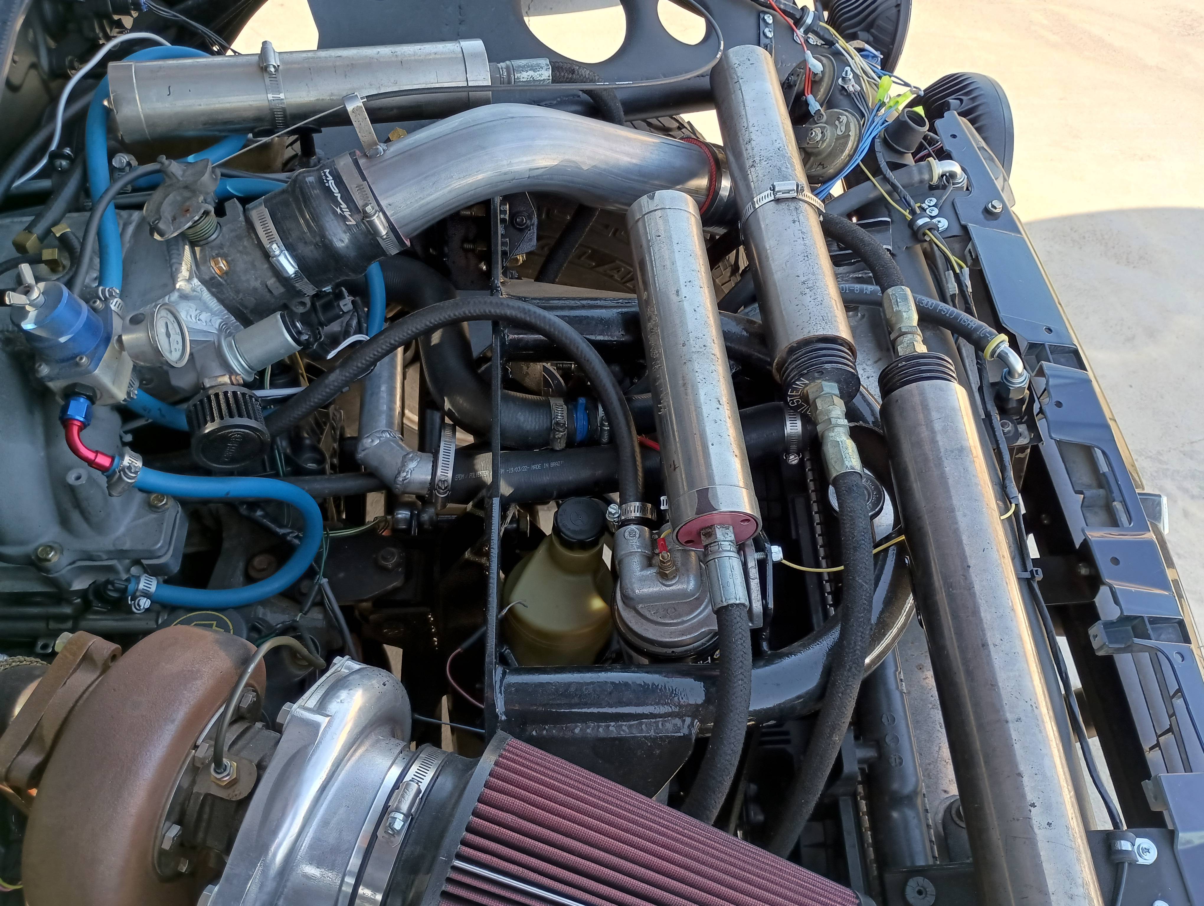

man, this power steering pump is got me kinda low
in its limp mode i think it is pretty low powered. the wheel has a very lag/resistive feeling to it if you try and turn at any normal speed. once moving THEN the power comes on....
i have an arduino i have controlled it with some and dont think i have yet to see full power
everyone is saying 60-70 amp. i feel it is running maybe 10-20 amp at best. wont even hear it bog the engine at idle while steering
GIVE ME THE POWER YOU FUCK!

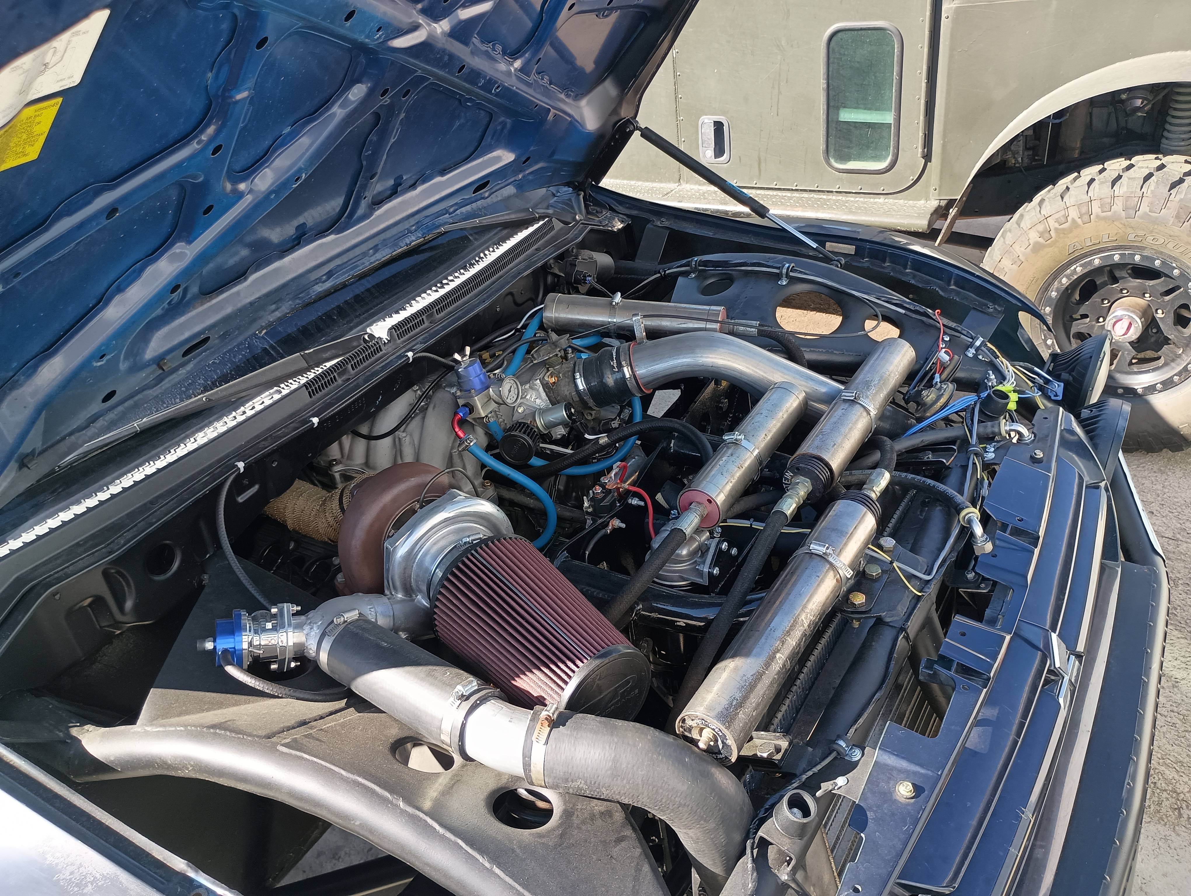

finally got the Monty safe enough to hit the slower roads in town
drives very sluggish for some reason, but with enough torque to zip down the road
the turbo makes noise but no boost! how is that even possible?
i think i am going to take off the muffler and see if it runs different better
it will rev up fine :unsure:
i really dislike the electric steering pump so far.
if i was flush with cash i would buy a new one over this used ebay one, but it sounds good while running so i will try some more with it
i really want to get a pressure gauge on the line to see what the hell it is putting out and how laggy it is too

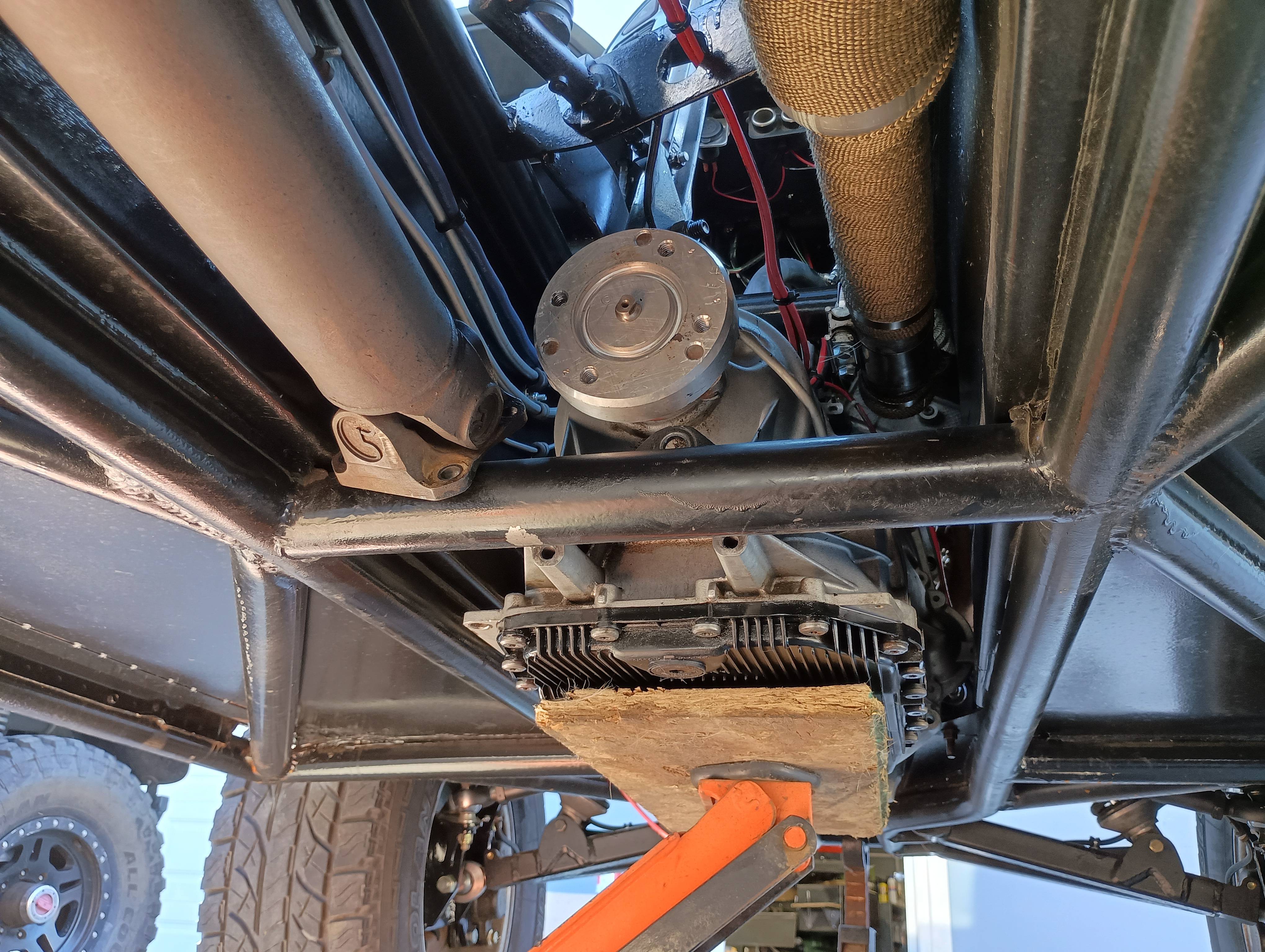

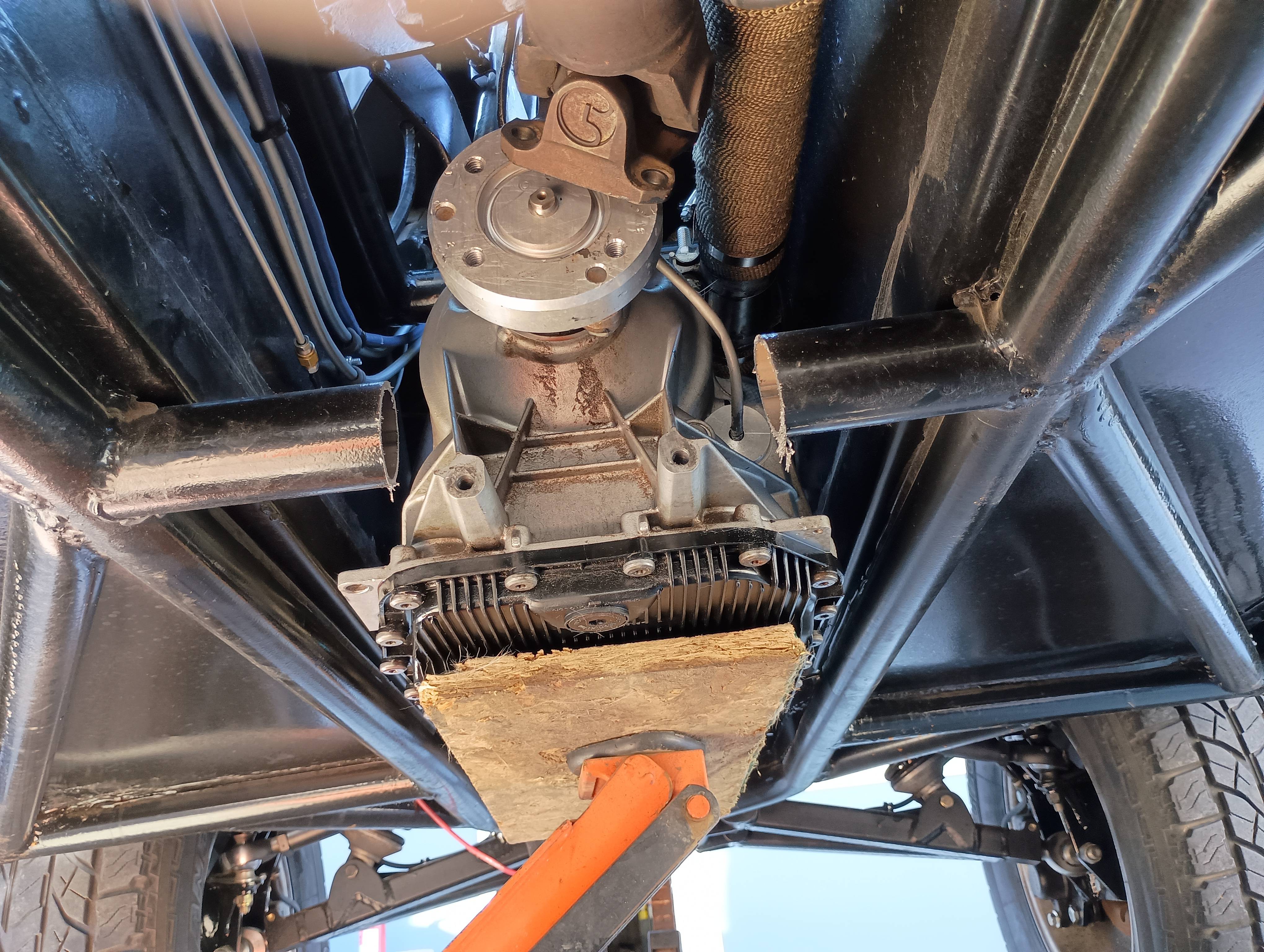

anyways..... the fun thing was at the scales. this thick little girl with all the trimmings is 4350#
front 2150
rear 2200
drives nice and straight and very quite on all the bumps!
i stalled it up some in first gear and it slides the front tires. lol
the spool with the 37"s are very much in charge of the front tires

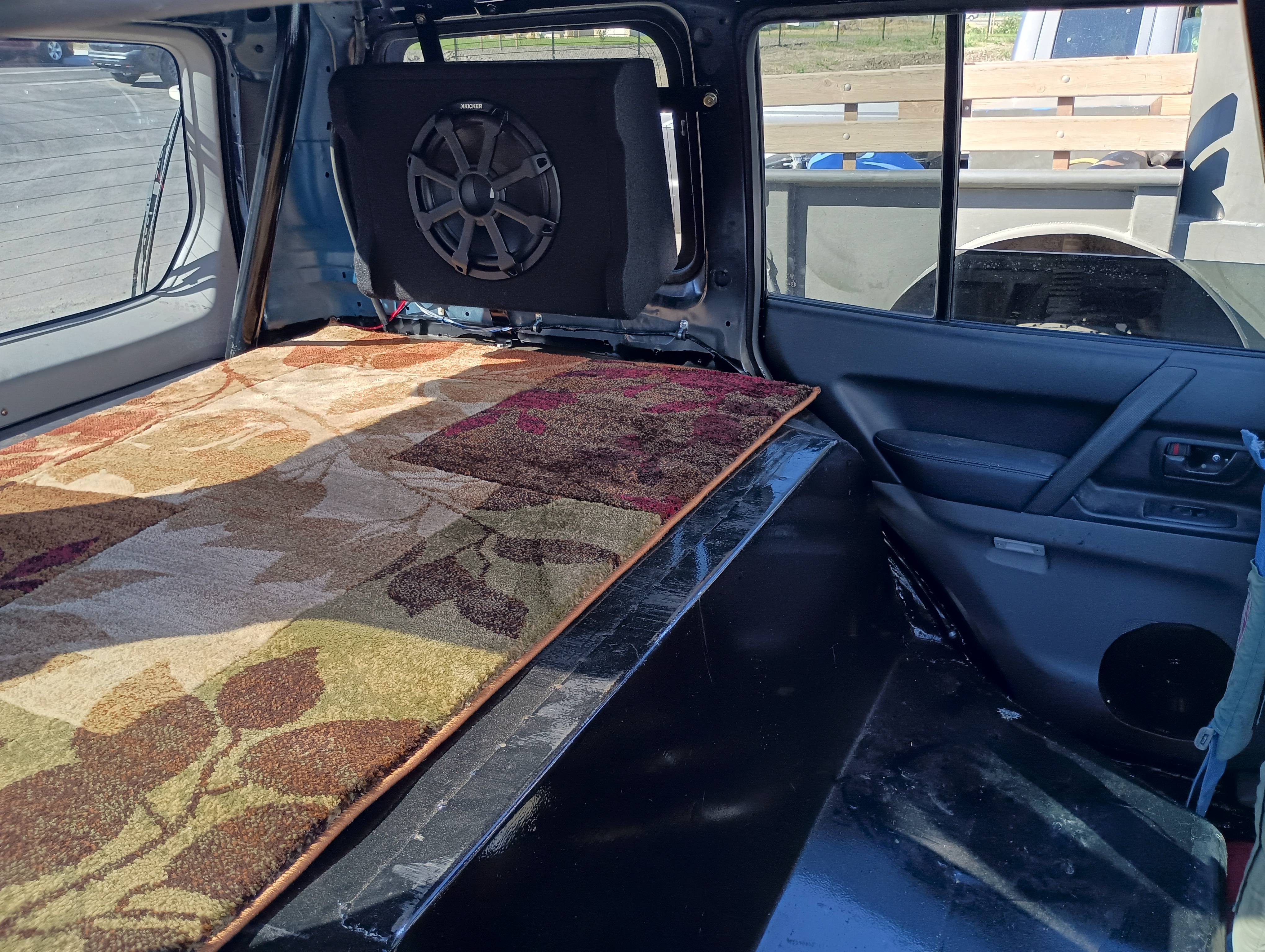

about time to make the rear cushion and back rest

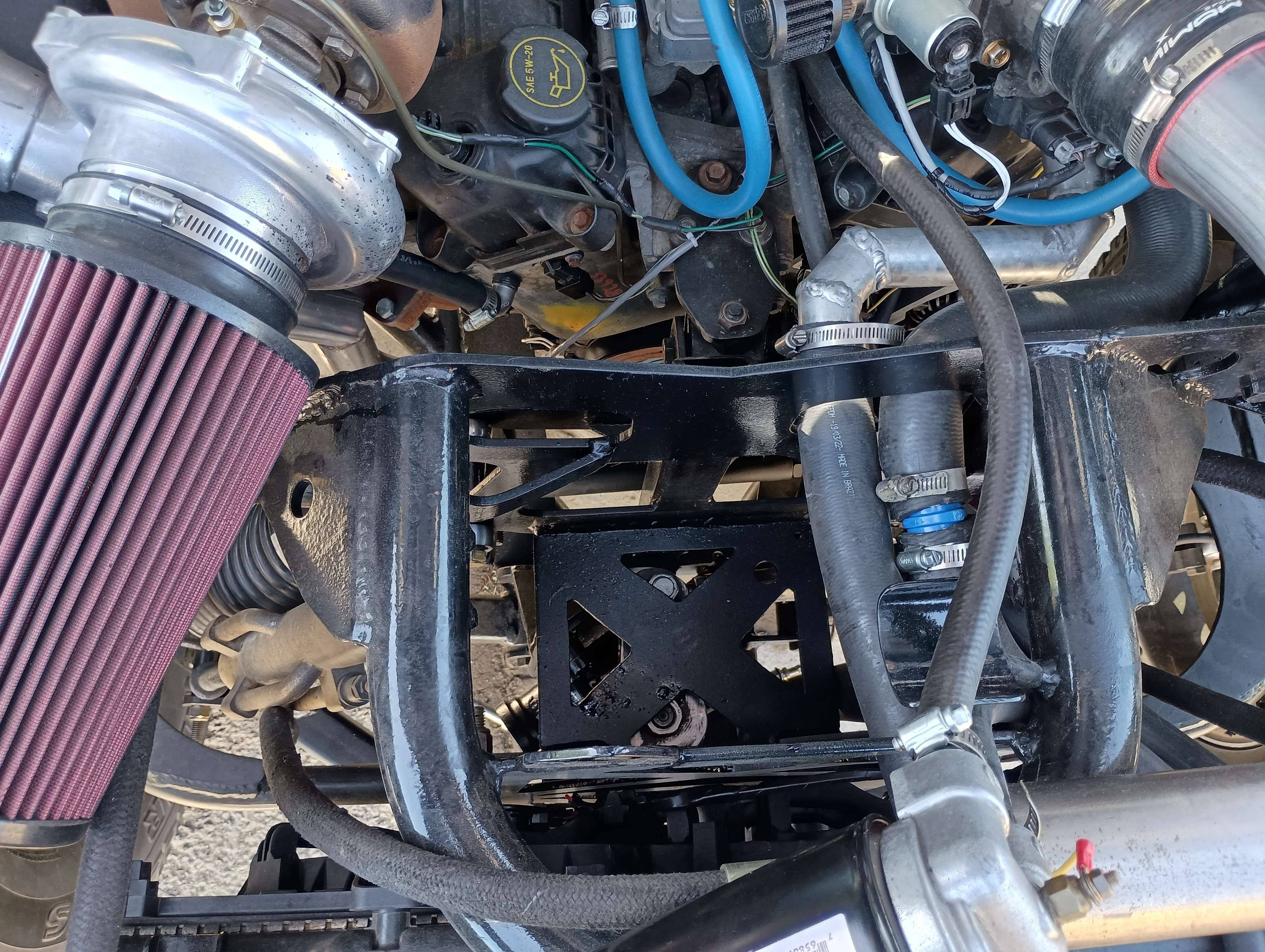

also need a mans heat shield between the turbine and fuel line!
transmission and paddle shifter is working perfect.... other than a slight flare when down shifting into first gear. i just need to downshift just before stopping
