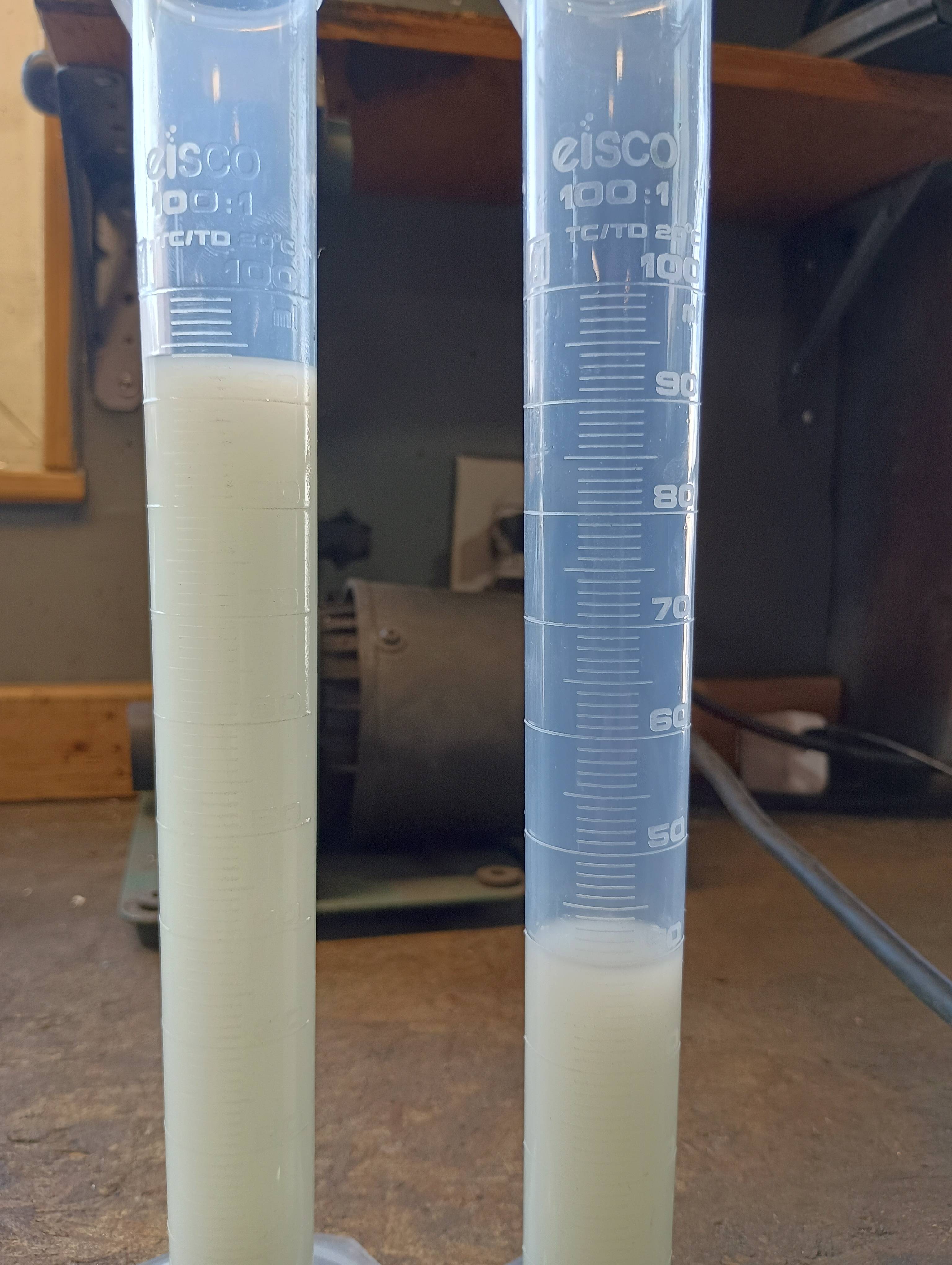

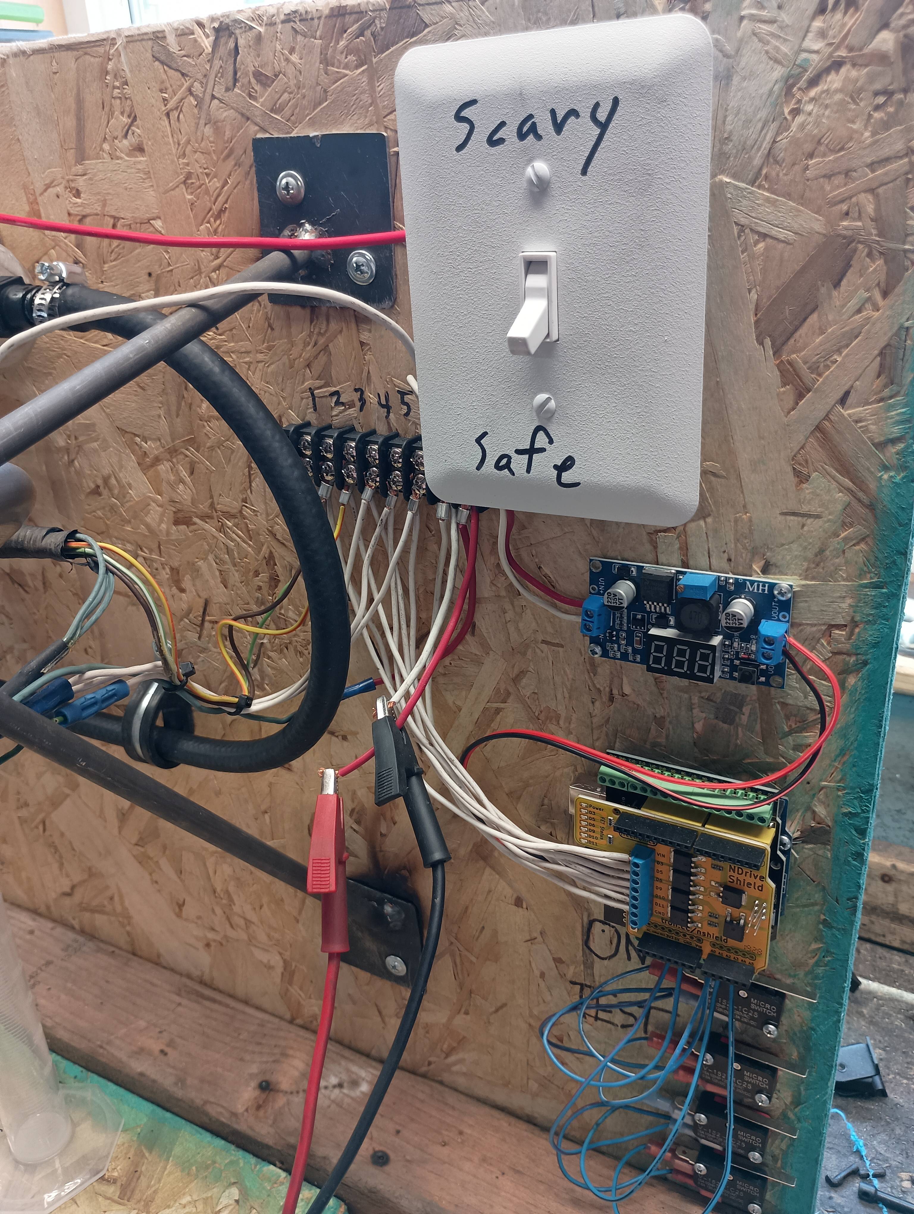

ok cool. i got the tester working good
i was planning on using mineral spirits for the test media. i got all silly and thought about saving the world by using the eco friendly substitute for this. that was dum and made basically toothpaste out of the injectors. so now back to "fuck this world" status the injectors work as they should.
dont use the fake shit
me and chatbots code for the tester
Code:
const int idle    = A0;     // 900 rpm = 133Ms loop / fuel load 3Ms + 1Ms dead time runsmooth sequential
const int torque  = A1;     // 3500 rpm = 34Ms loop / fuel load 8Ms + 1Ms dead time runsmooth sequential
const int reving  = A2;     // 6000 rpm = 20Ms loop / fuel load 12Ms + 1Ms dead time runsmooth sequential
const int test    = A3;     // run a 19Ms loop for 10 seconds at 85% duty on, all outputs simultaneously
const int pwmPin1 = 3;
const int pwmPin2 = 5;
const int pwmPin3 = 6;
const int pwmPin4 = 9;
const int pwmPin5 = 10;
const int pwmPin6 = 11;
const int off = 0;
const int on  = 255;
void setup() {
  pinMode(idle, INPUT_PULLUP);
  pinMode(torque, INPUT_PULLUP);
  pinMode(reving, INPUT_PULLUP);
  pinMode(test, INPUT_PULLUP);
  pinMode(pwmPin1, OUTPUT);
  pinMode(pwmPin2, OUTPUT);
  pinMode(pwmPin3, OUTPUT);
  pinMode(pwmPin4, OUTPUT);
  pinMode(pwmPin5, OUTPUT);
  pinMode(pwmPin6, OUTPUT);
void loop() {
  if (digitalRead(idle) == LOW && digitalRead(torque) == LOW) {
    // A0 and A1 both held low
    runHighDutyCycle();
  } else if (digitalRead(idle) == LOW) {            // idle  133
    runSmooth(129, 4);
  } else if (digitalRead(torque) == LOW) {   // torque  34
    runSmooth(25, 9);
  } else if (digitalRead(reving) == LOW) {   // reving  20
    runSmooth(8, 12);
  } else if (digitalRead(test) == LOW) {     // test
    runTest();
void runSmooth(int cycleDelay, int squirtDelay) {
  int pins[6] = {pwmPin1, pwmPin2, pwmPin3, pwmPin4, pwmPin5, pwmPin6};
  int numberOfPins = 6;
  int delayBetweenPins = cycleDelay / numberOfPins; // calculate delay between each pin activation
  for (int i = 0; i < numberOfPins; i++) {
    analogWrite(pins, on);
    delay(squirtDelay);  // squirt delay
    analogWrite(pins, off);
    delay(delayBetweenPins);  // delay between each pin activation
void runHighDutyCycle() {
  int onTime = 17; // 85% of 20ms (17ms on, 3ms off)
  int offTime = 3;
  while (digitalRead(idle) == LOW && digitalRead(torque) == LOW) {
    delay(onTime);
    delay(offTime);
void runTest() {
  int onTime = 16; // 85% of 19ms (16ms on, 3ms off)
  int offTime = 3;
  unsigned long startTime = millis();
  while (millis() - startTime < 10000) {   // run for 10 seconds
    delay(onTime);
    delay(offTime);
