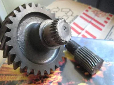

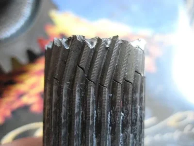

Here is an old thread I found on Pirate4x4 from JeepRecoveryTeam.
What’s the consensus on water in tires for crawlers??
“We've been running ballast - mostly water - in the front tires for a couple of years now. I'm pretty confident that we have enough data to figure what 'too' much is.
Keep in mind that my data is based on a linked 3000 lb rig on 37" stickies with a 5 speed dual ultimate setup. ARB's front and rear.
Bigger tires, heavier rig will make it worse. Automatics, DOT tires, and leaf springs tend to 'give' a little before the parts realize 100% of the torque.
When we ran the toy front, we ran 'bottom of the wheel' to start and never broke anything. We stepped up to 'half wheel' late in the season last year and in the women's comp we were hurrying through a course and wedged the front right under a rock at speed. I thought we broke the housing in half, but only grenaded a 30 Spliner, the only one I broke in 3 years of competing on them.
This year we switched to the Diamond 609's with Bobby's 60 CV's. We stayed at half a wheel with no problems. Around mid season we switched to 'top of the wheel' and immediately broke a front output. (Binding slightly on a down hill crackline). We chalked it up to 2 years of abuse and wheeled two more comps like that.
A couple weeks ago, we broke the front output again in similar 'lightly bound' situation. This info combined from what I've seen in the FToy comps... specifically Matt Messer's breakage of birfs and front outputs when running top of the wheel.... leads me to believe venturing past mid wheel with water is when you can expect to start seeing problems.
An ancillary side effect, the more water you put in, the faster your birfs start clicking. And of course if you run water AND have a spool or welded front, you will almost certainly break something, possibly the mythical 'driveway' break.””440323EC-AF3B-4901-B827-E1933958FB11.jpeg4E5B30E4-15B2-4C2A-A6FA-CF612518E78F.jpeg
Interesting didn't even know that was a thing.
For my shit box, I'm good on the water in the tires. Not sure how much of a difference it would even make but with driving the truck on the Hwy to and from work or the trail.. I can't imagine the that being helpful haha looking at the photos of these axles. I'll take the performance hit and save the axles.

I’d say the main takeaway from that post is that water in tires is very abusive on Toyota parts. If you have the strength it can be a huge advantage gaining that extra unsprung weight but also has the downside of giving the rig horrible handling, I’ve thought about doing this n my Toyota all the time but waiting till my buggy is done to experiment with water
Yes the added weight of the water will find the weakest link when wheeling on it hard. It's a fine line between weight/power/parts strength to find that perfect balance to reduce the amount of broken parts/maintenance required on the parts too.
