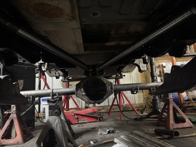

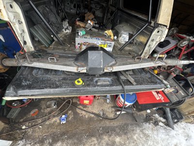

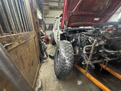

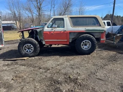

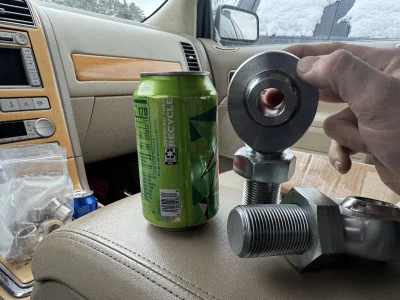

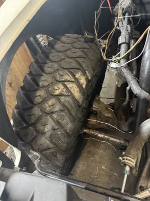

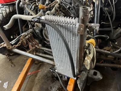

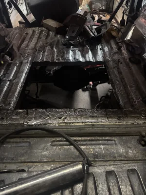

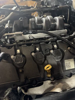

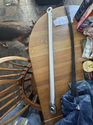

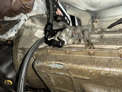

Been picking away at little things while I wait for parts. Trans lines are in and temporarily hooked up. Fuel line is ran to the back fuel cell is sitting where I want it. Hopefully my upper link parts show up soon!
