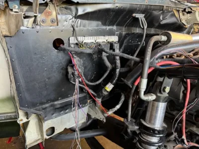

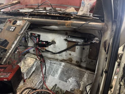

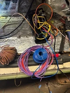

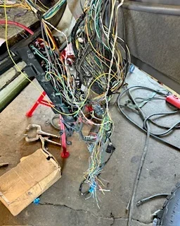

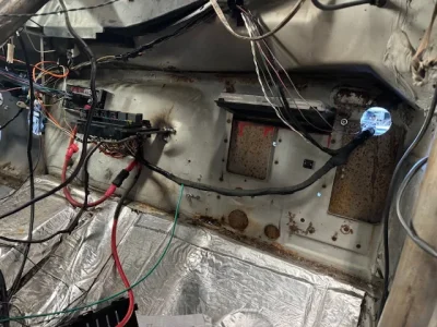

Making progress on my diy control pack wire harness relays are all wired 10 more wires in the pcm than need hooked up Need to figure out how to unlock the pcm my self yet. IMG_0426.jpeg

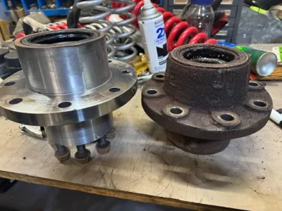

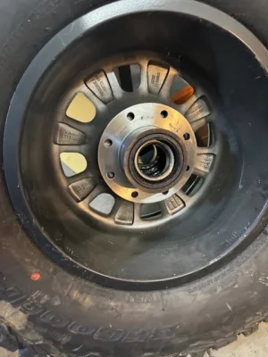

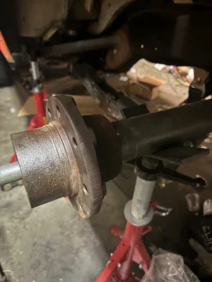

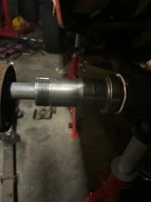

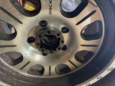

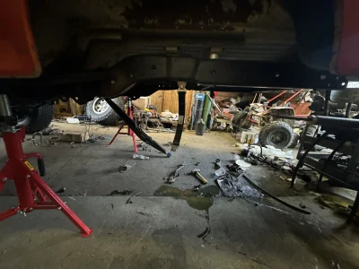

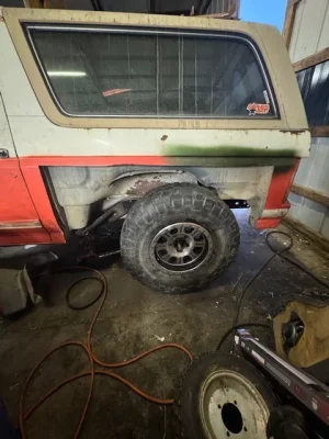

Well made some more progress on the rear axle using 14 bolt spindles and hubs I will weld up turn down and redrill to 5x5.5 to match the front

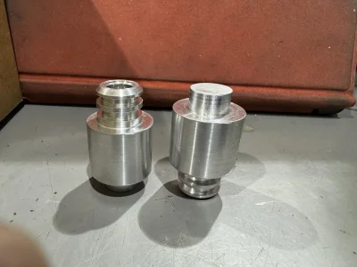

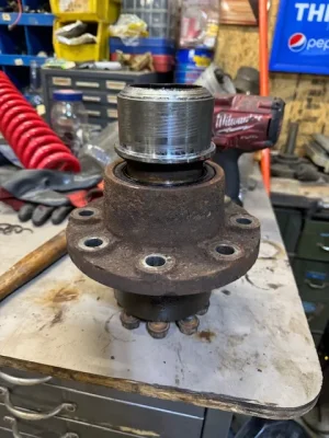

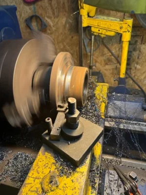

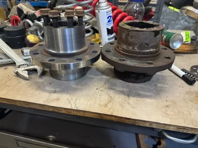

Tonight I decided to turn down the 14 bolt hubs and get them ready to be re drilled

I believe "solid industries" makes 14 bolt hub packages for 9" housing or any fabbed housing. Great prices and have a few different lug pattern options.
Yes rough stuff also does. But I cut up a 14 bolt axle that came out of a $400 parts truck I pulled a ls out of so I’m $0 in to these. Helps I have the machines in my shop to make them as well.
