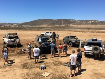

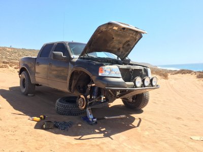

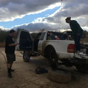

I run small tires and a stock motor, so nothing breaks, there for I never prep. my trucks. in case something does fail, I do pack: steering box & full set of steering arms for when I hit too big of a ditch, brake lines if I hit too big of a bush, tire plugs if the wheel hits the center of the bush, 3ft tubing for prying or making a splint, nut & bolt bag, electrical bag, crapping bag of basic tools, spare drive line, tow straps & old limit straps to link ropes together.
