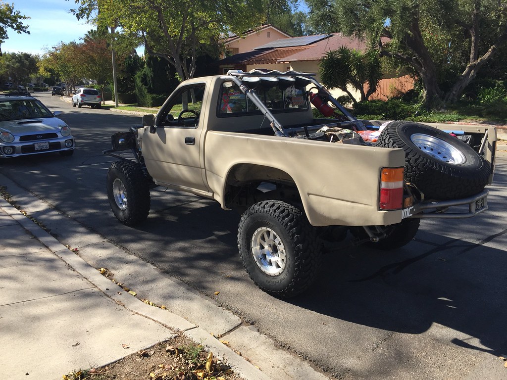

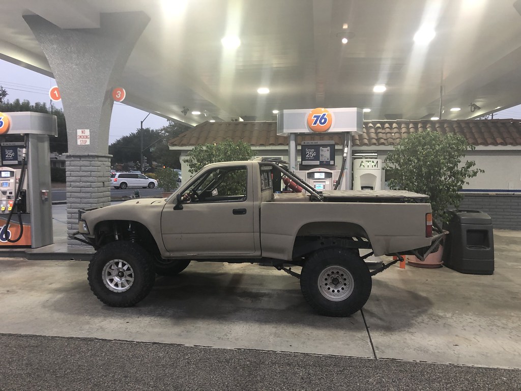

Toyotally Awesome 94 pickup
Damn. Lawn darted my ranger in Pismo a few years ago as well.
Collapsed cab mounts, bent spindles, busted radiator, etc. It's always Pismo... lol
Fack... yea man this was pretty gnarly 2nd gear going pretty good to stopped... Pro tip don't follow @Lutz in his baja bug in the the fog haha
If the truck wasn't caged front to back it would have been Bad Times at Ridgemont High.

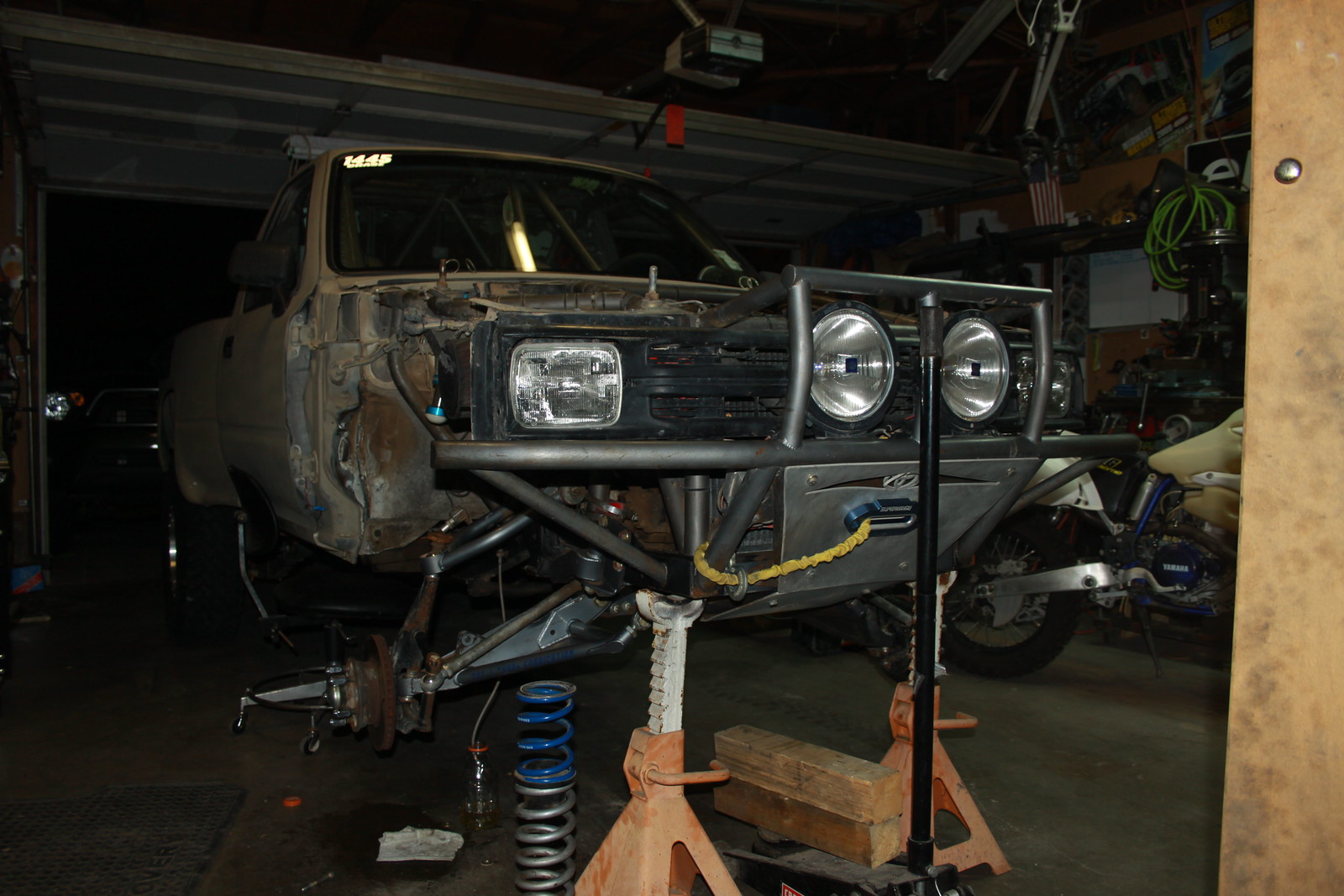

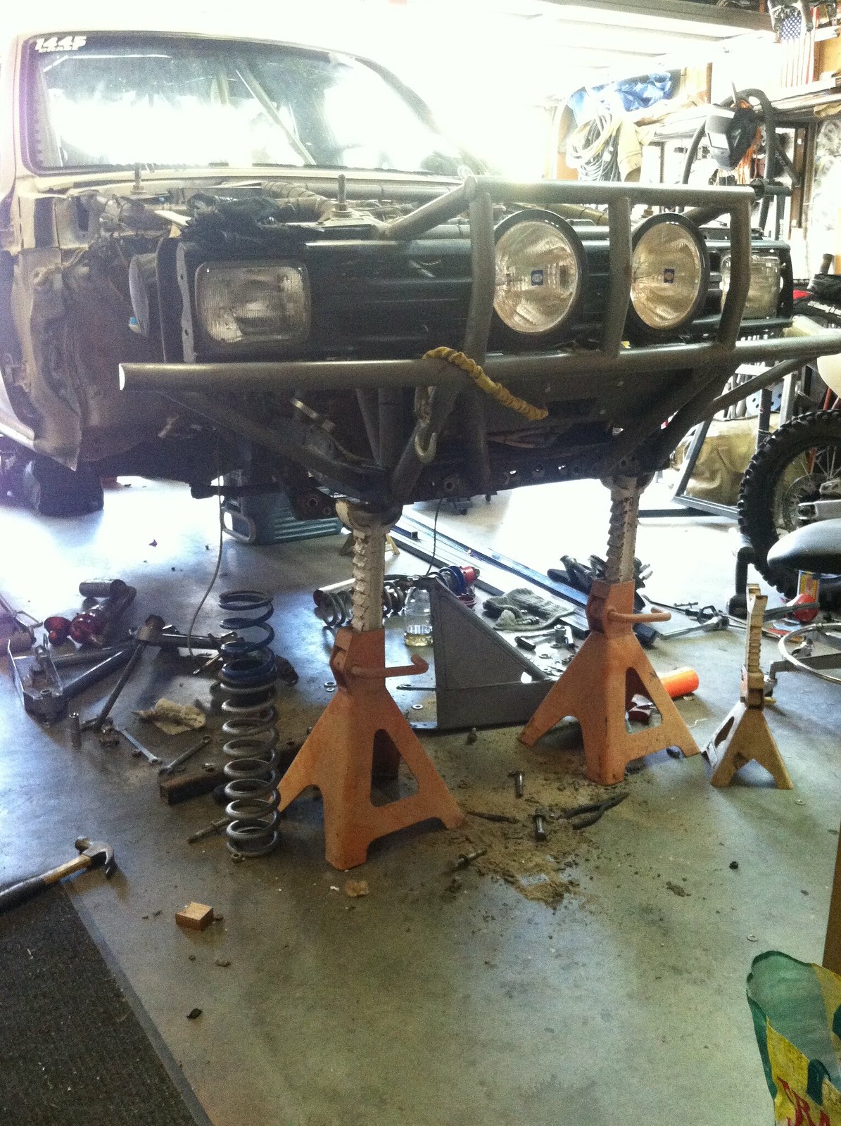

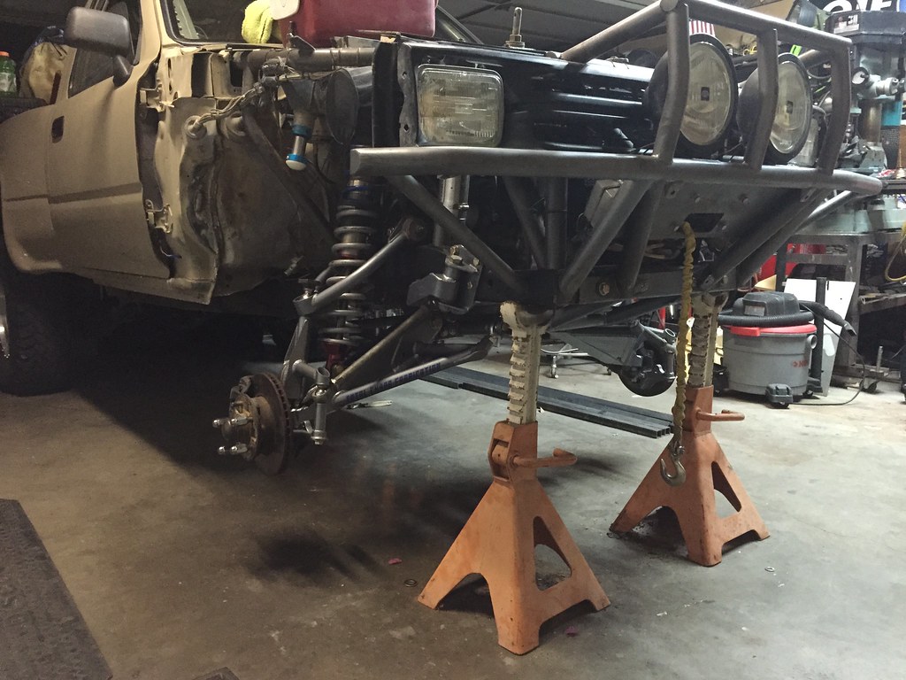

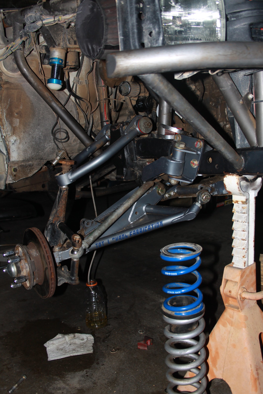

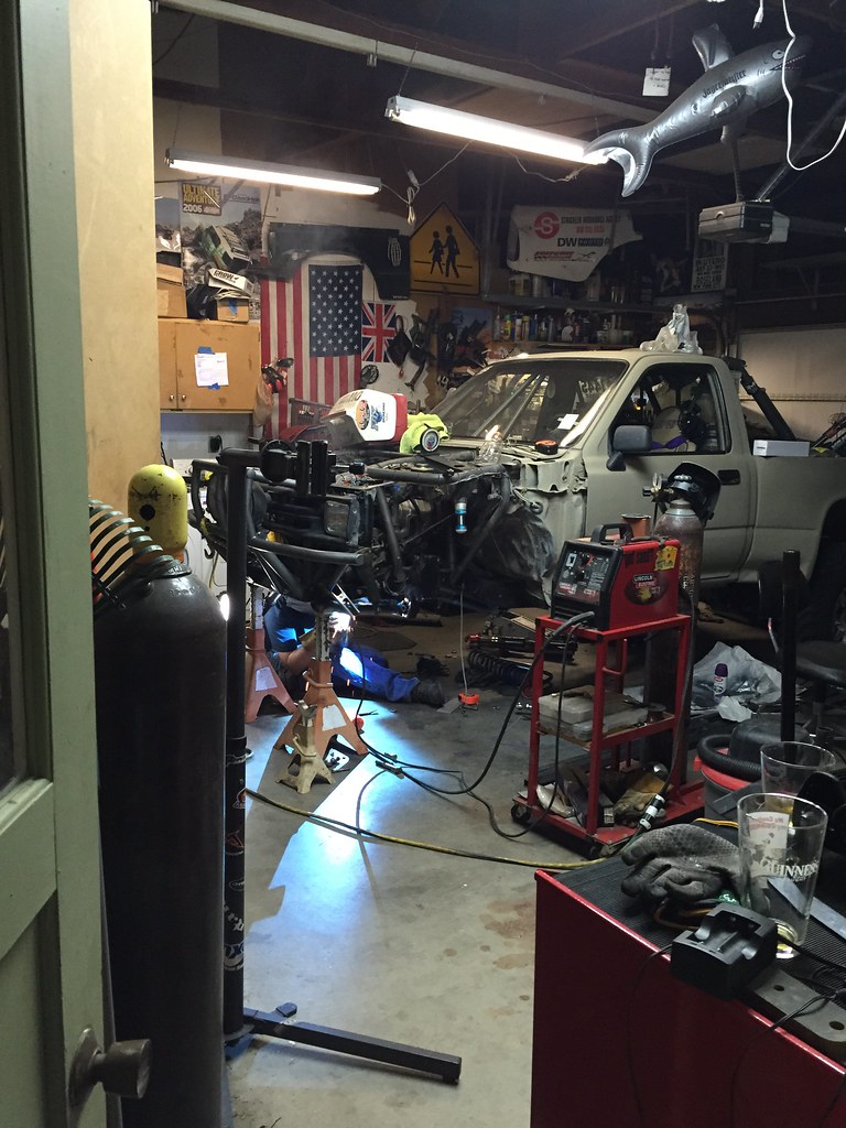

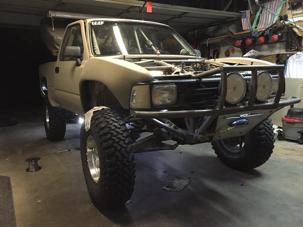

Already started the teardown
Totally Run able!
Time for a fresh Skid plate! lol

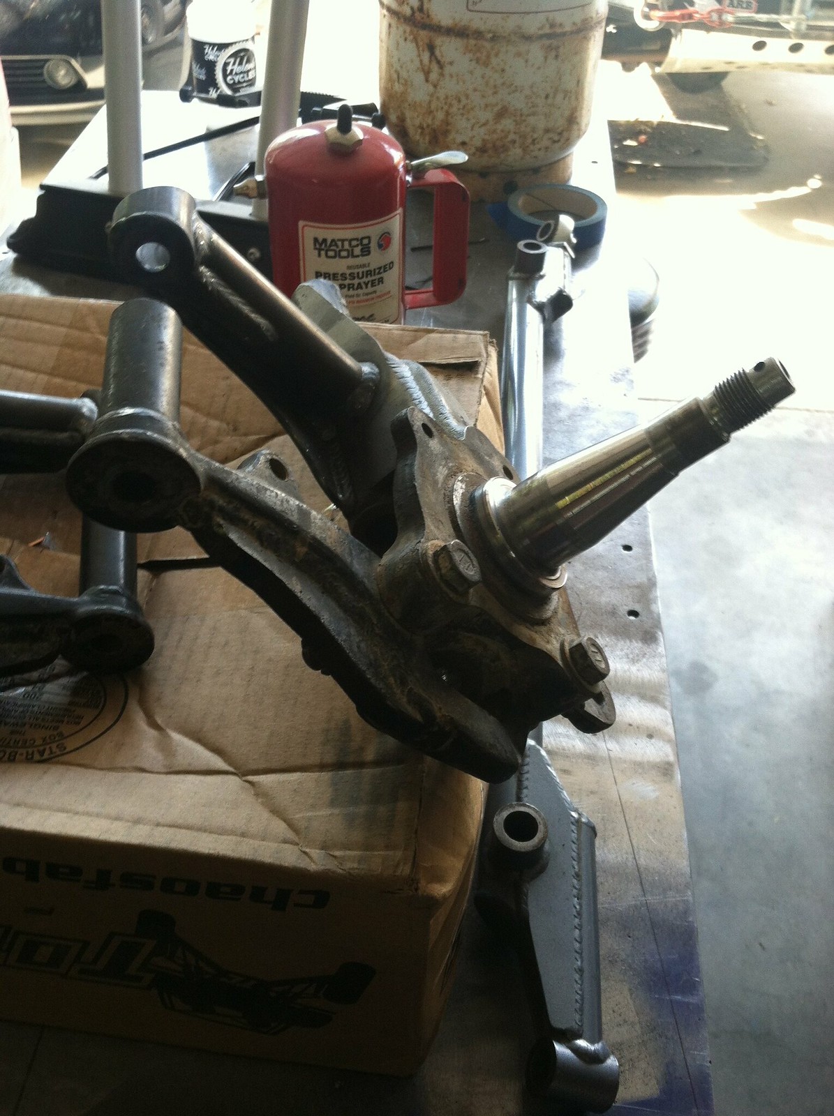

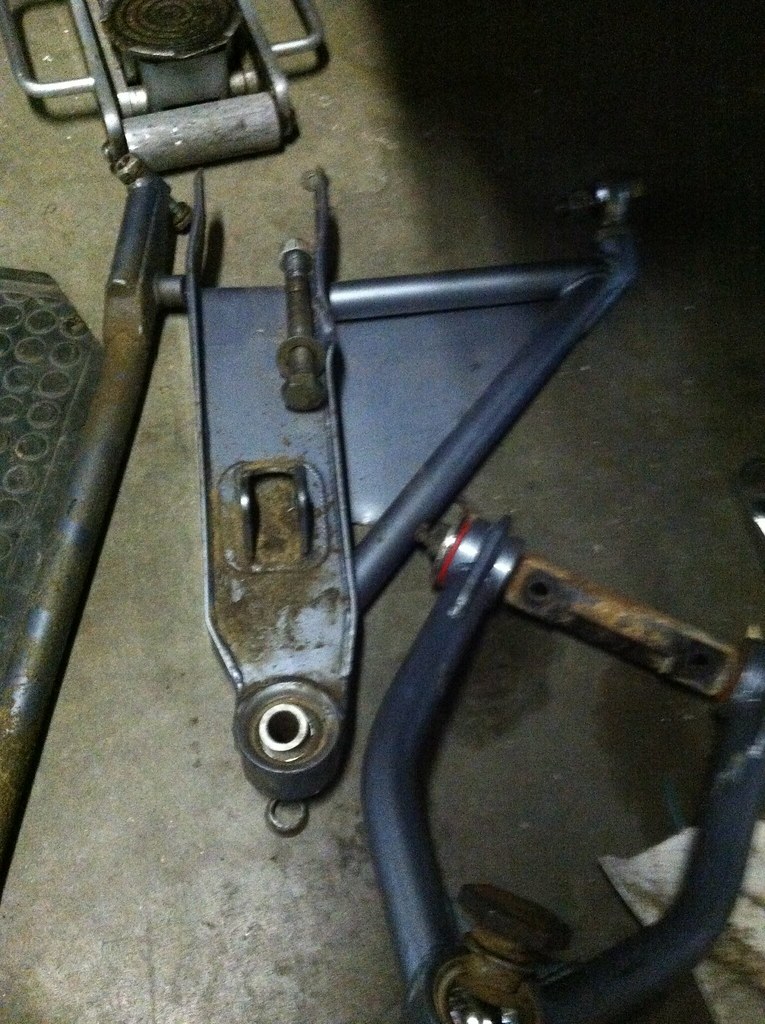

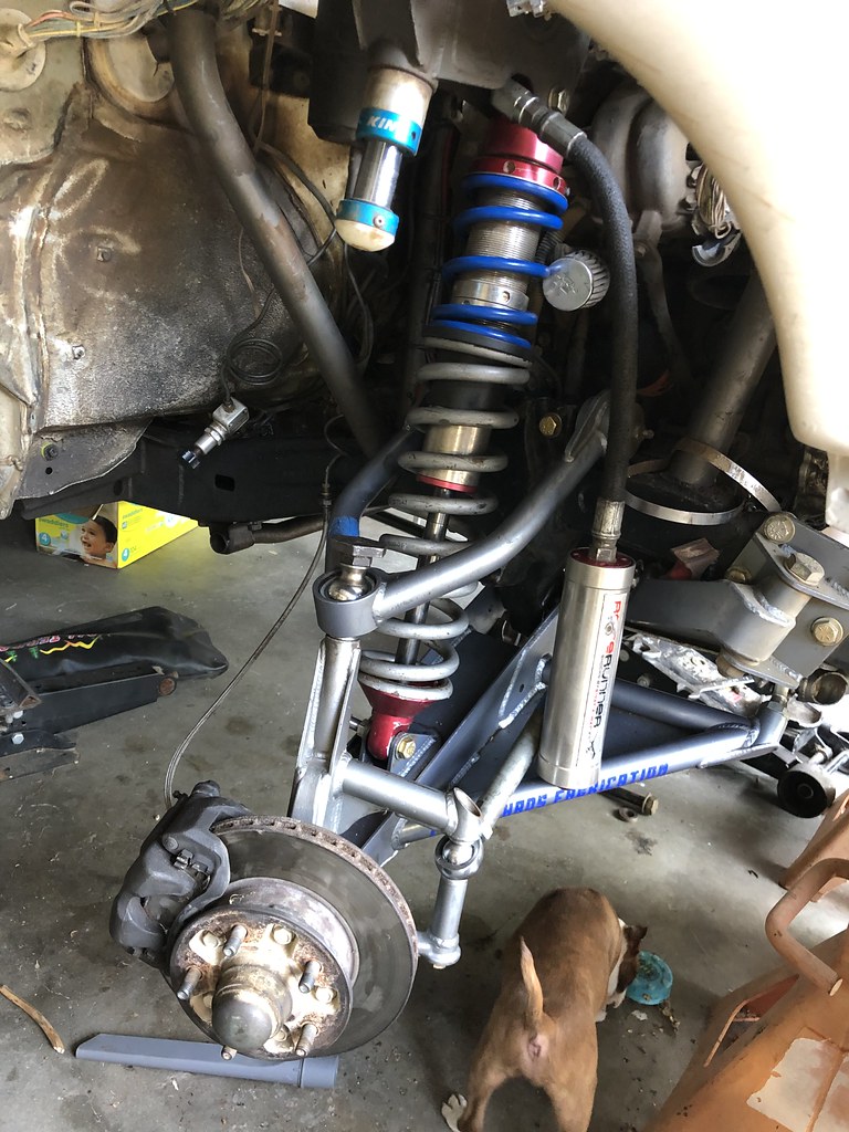

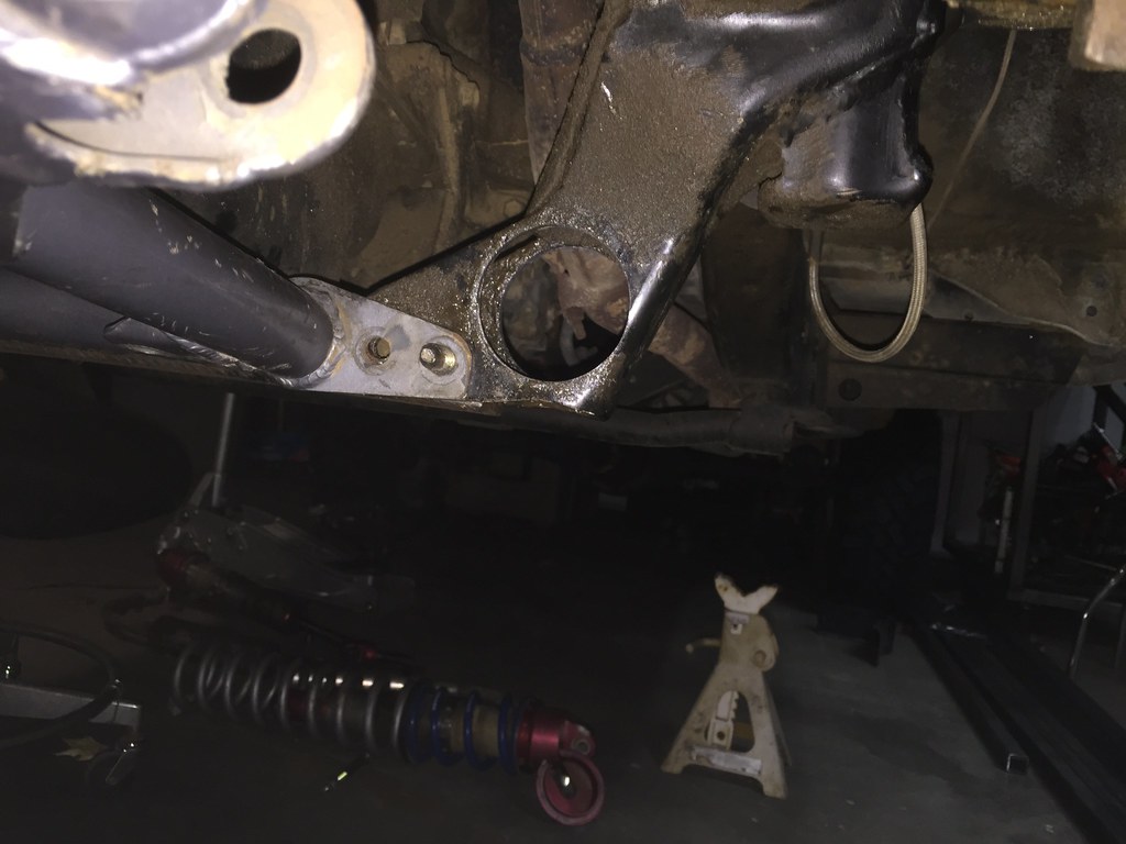

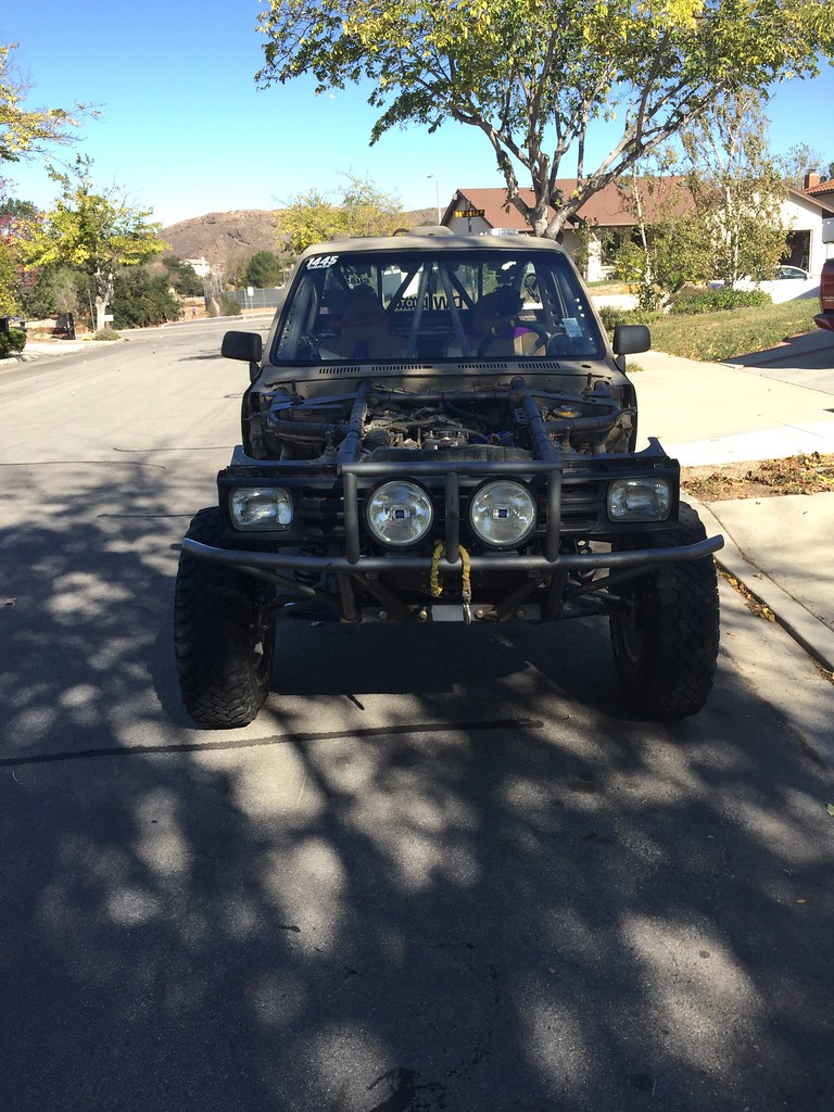

Finally got back to work on the truck...
Realized why I was putting off pulling it appart the rest of the way as I started to write down notes of what needs to be done while truck was down. Not going to be cheap!

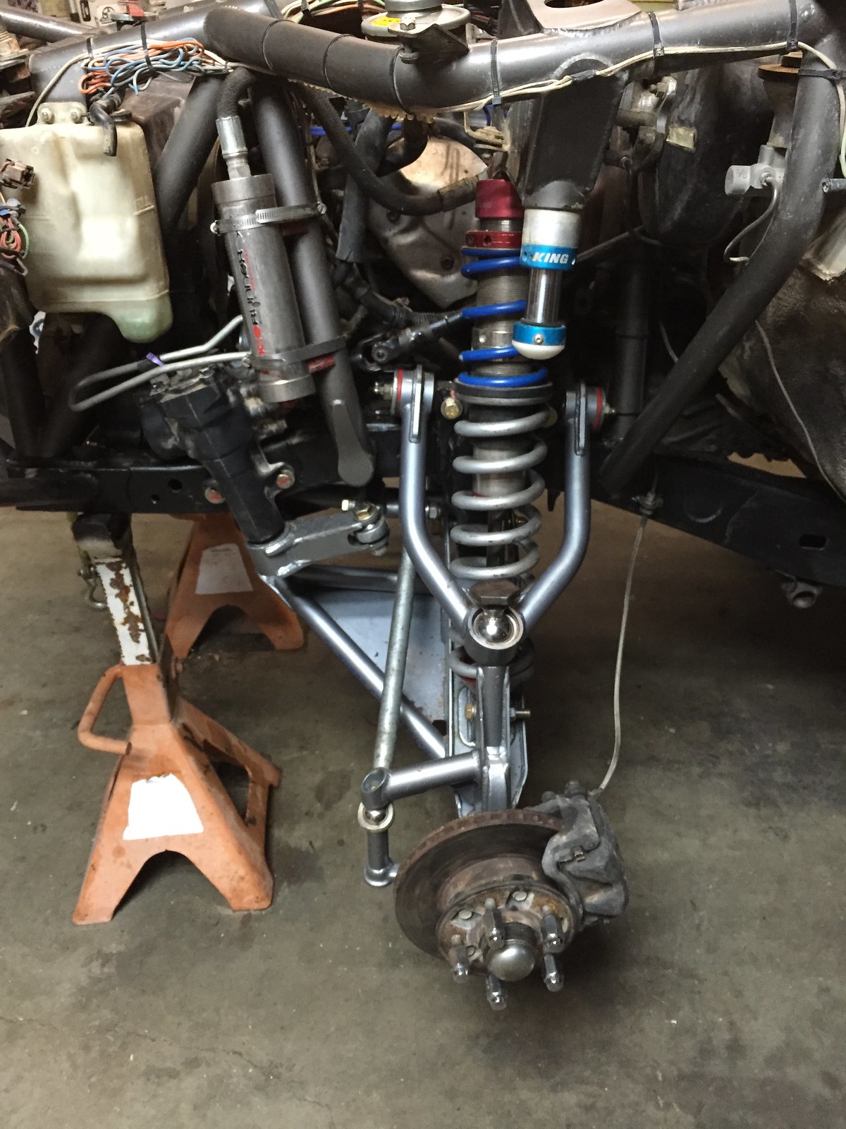

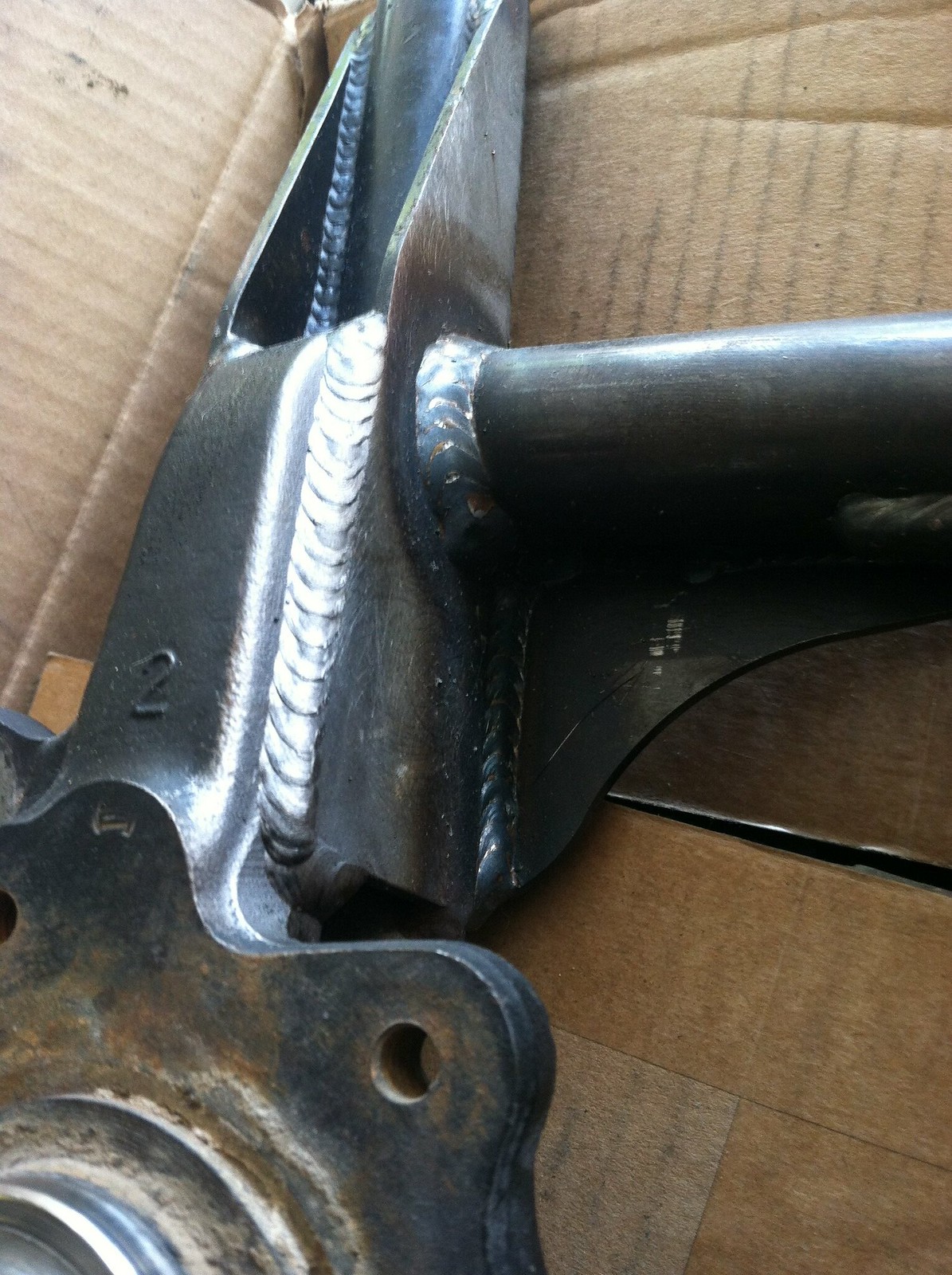

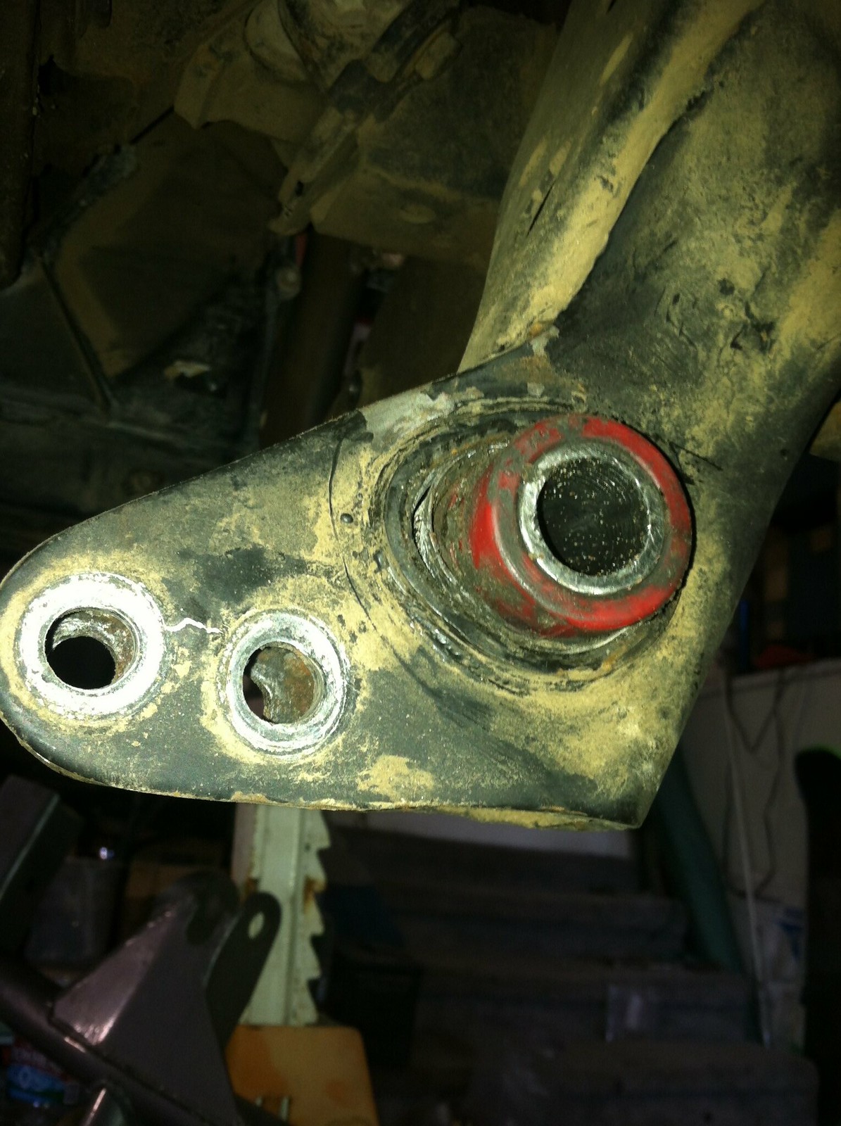

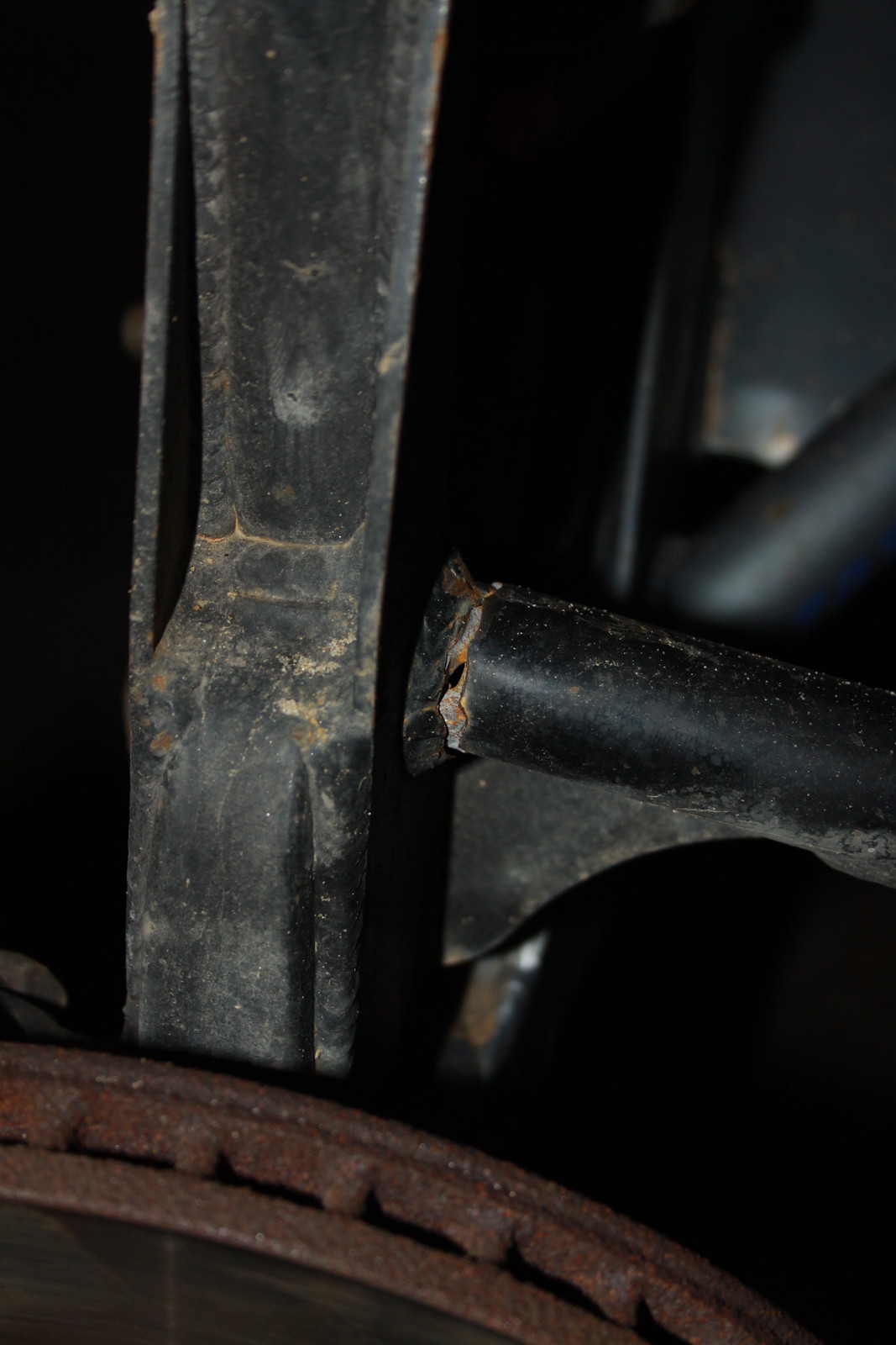

Lower is pretty mangled. (New arm from TC)
Upper looks like it might be bent too (going to TC)
Passenger Spindle is cracked (going to TC)
Strut frame is mangled (going to TC)
King Kong steering center link is bent( new from TC)
Uni balls on uppers are clapped

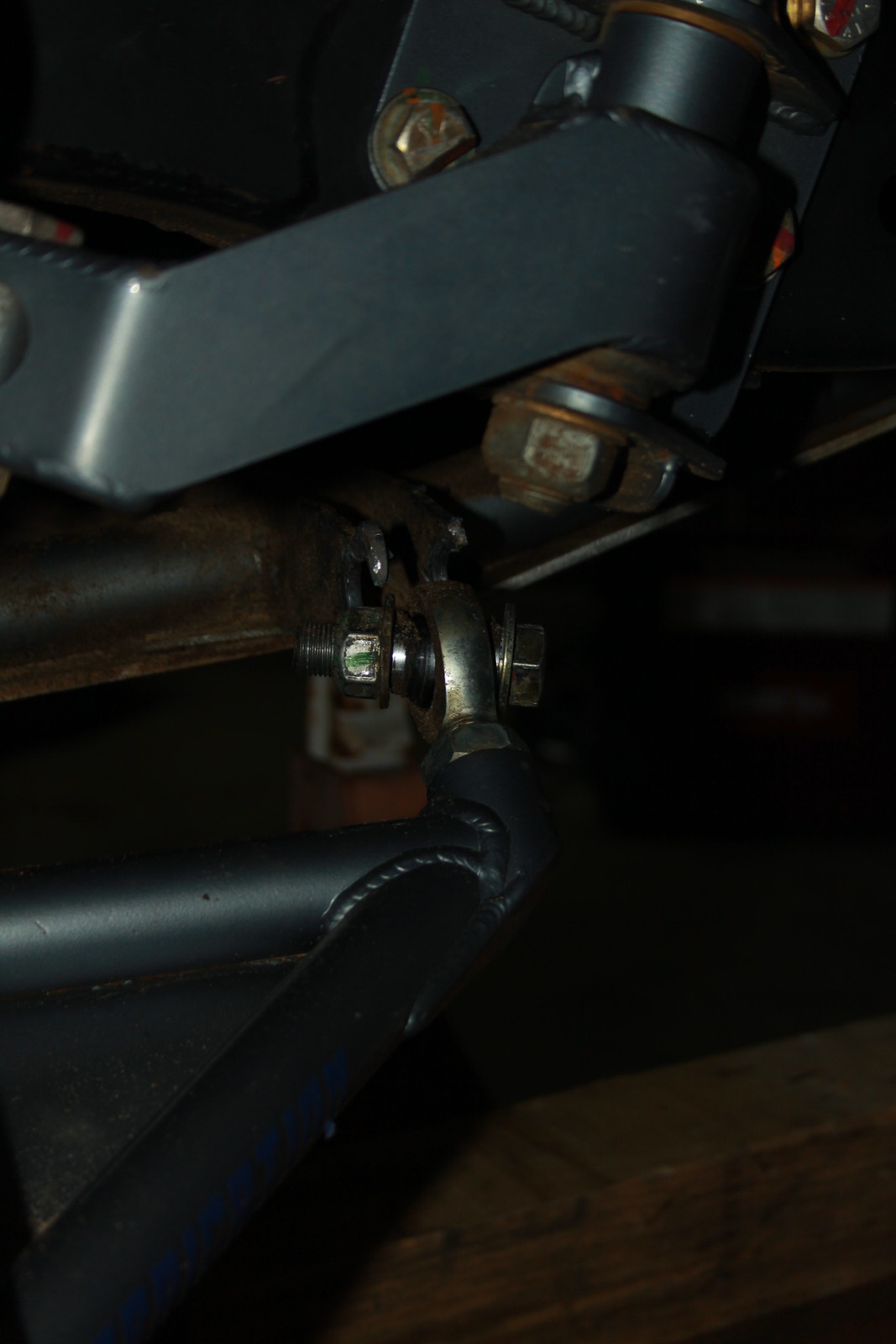

Heims on lowers will be replaced
bushing on lower and uppers

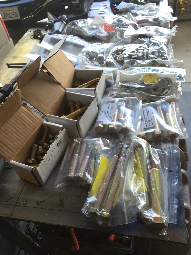

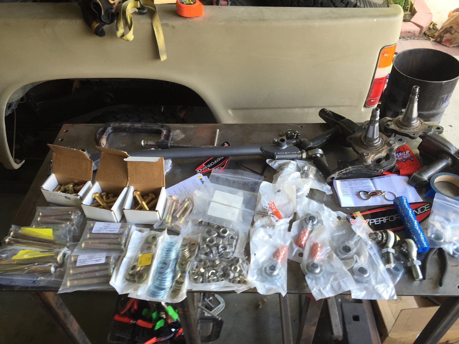

All new hardware for the front ( Including Splndle bolts !#@@$%#% ( bastards are like $40 a bolt!)
Need new misalignments for passenger side upper
Brake booster/ Brake master cylinder seems to be leaking so going to replace those ( was on my list any way)
Bolts on motor mounts are long over due.
Radiator has gotta come out so i can get to
fan clutch
Belts ( haven't changed them since i caged truck)

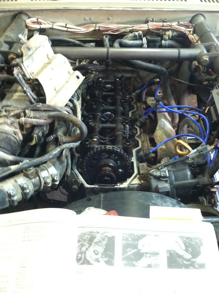

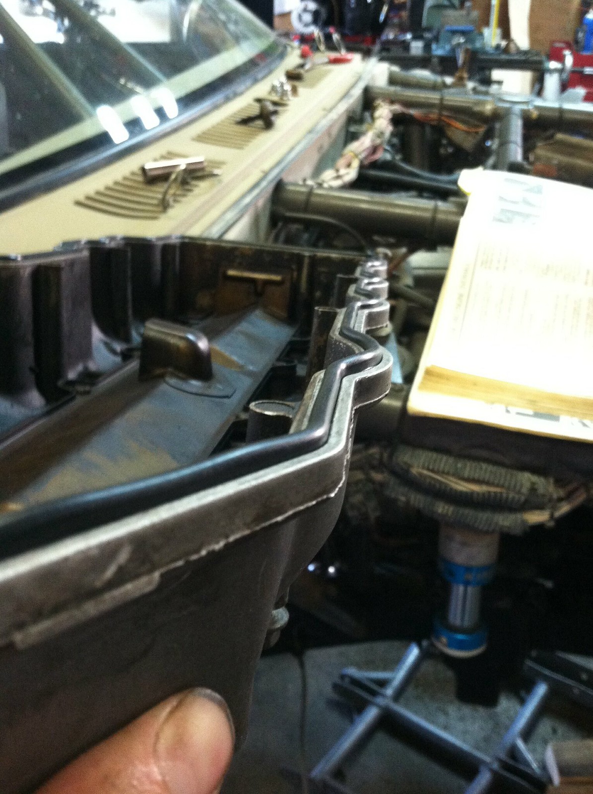

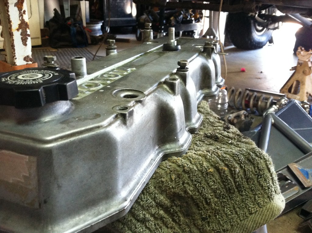

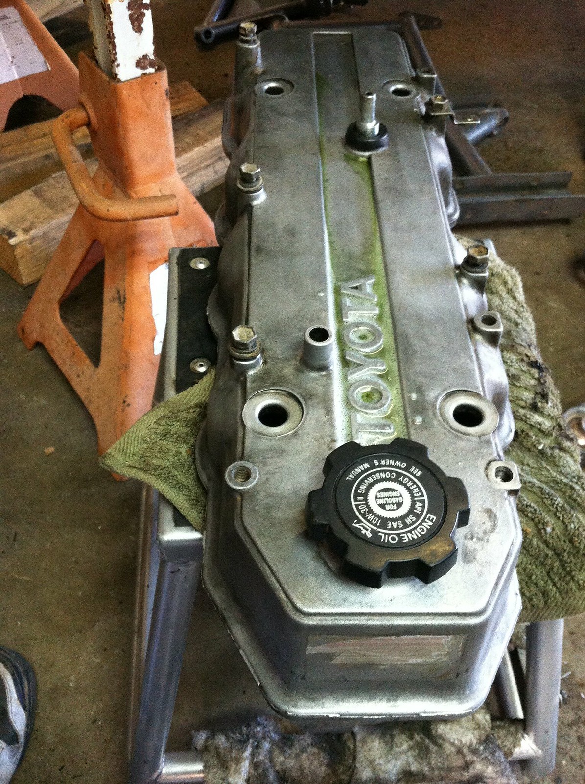

Valve cover gasket thats been leaking like a mofo.

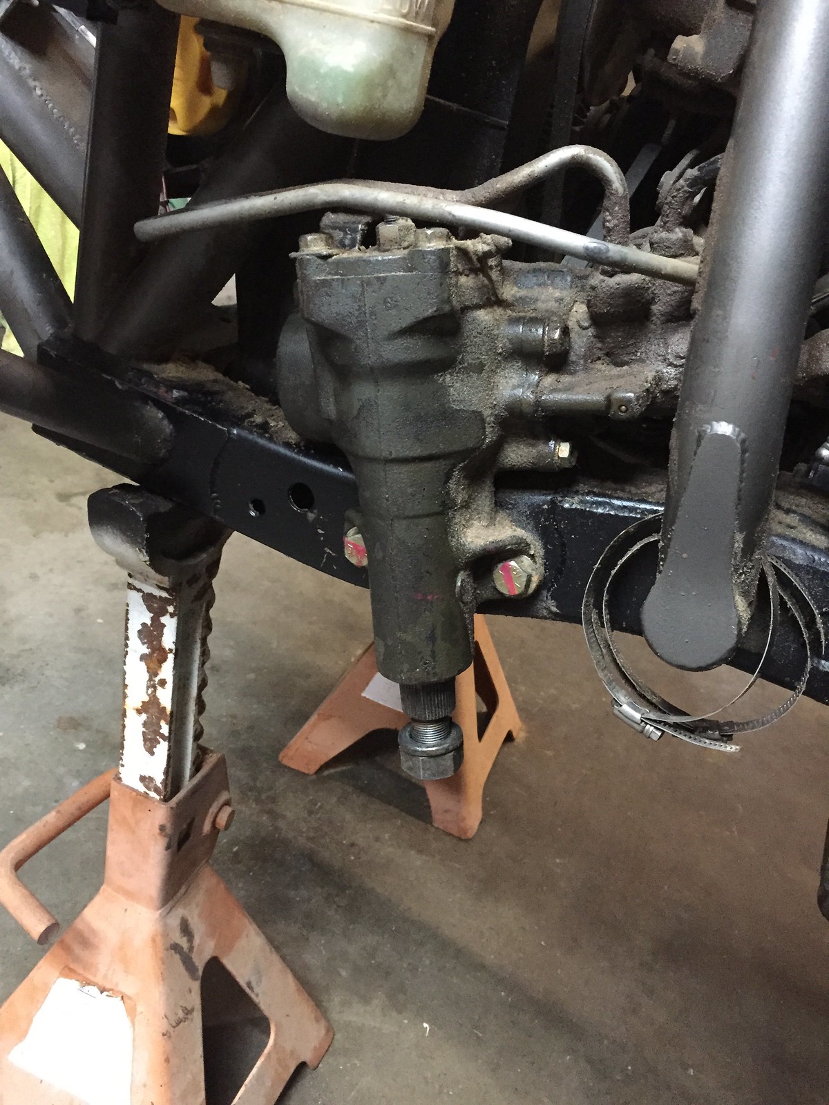

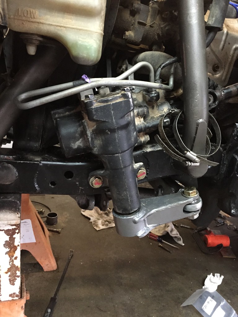

Steering box is also coming off.( leaks pretty bad ) Going to look for a remanned or maybe troll the Junk yard.
new lines Custom power steering (only been putting that off for 4 years)
Wheel bearings will be replaced
Wind Shield is cracked pretty bad after that little mishap. might get a new one of those.
Rear view mirror needs to be pulled and replaced.

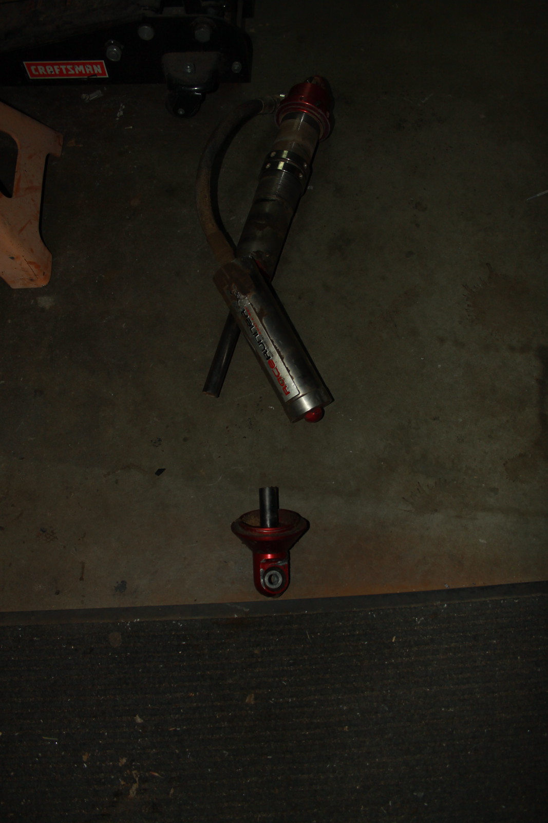

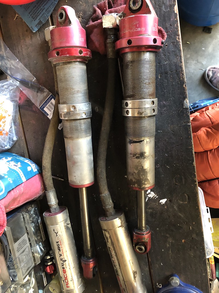

Shocks need to be rebuild all the way around and revalved (Need a new shock shaft for passenger front)
Also need to Cut tab and reweld for my flag and install tie down point so i can mount the pelican sideways in the bed.
Oh and that skid plate lol probably won't be going back on the truck

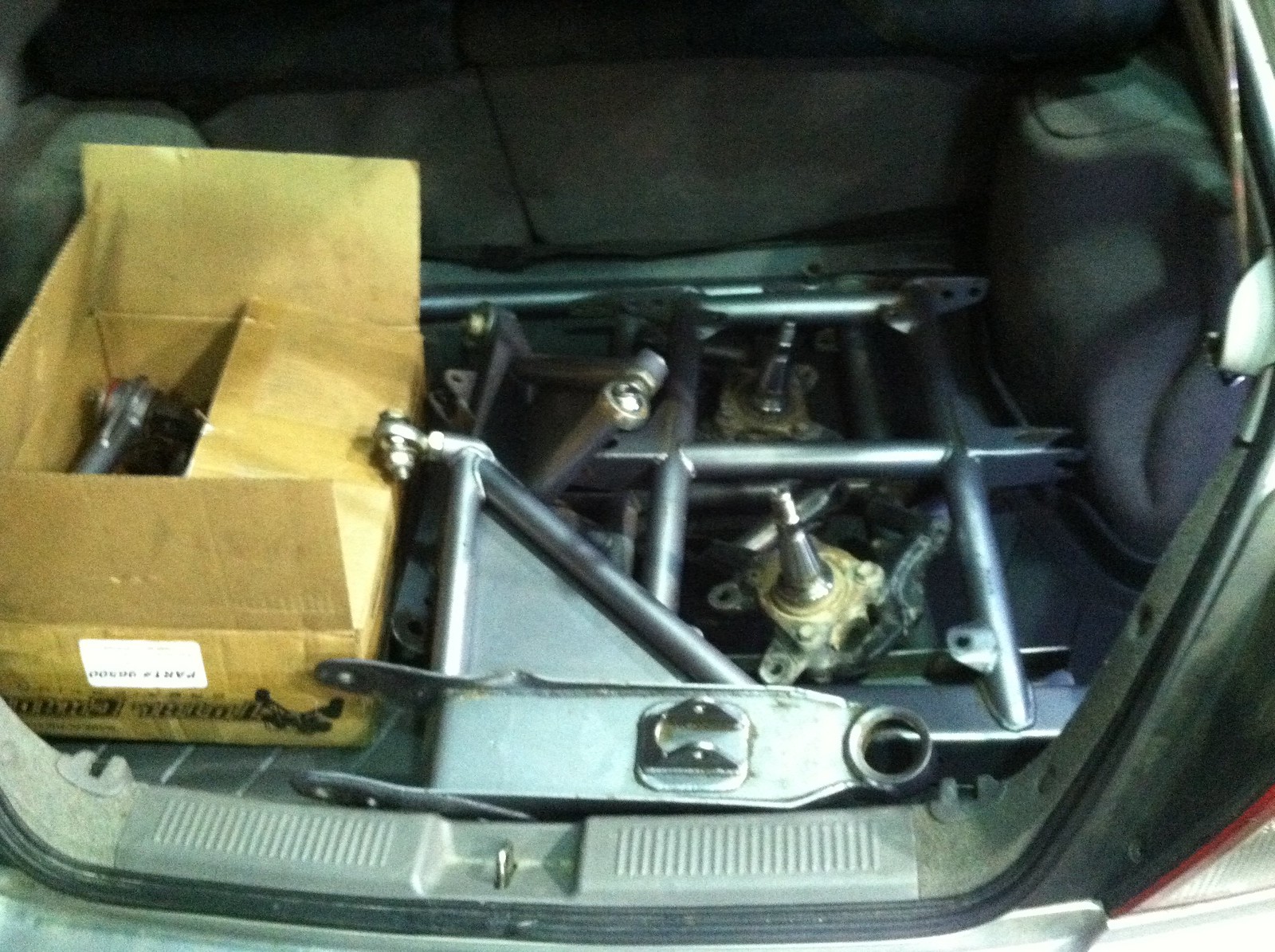

Parts Subie

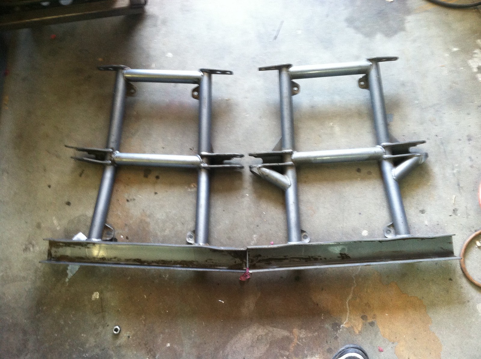

New to me beefed up sub frame
Thanks to Campershellfun
Upgraded/repaired spindles

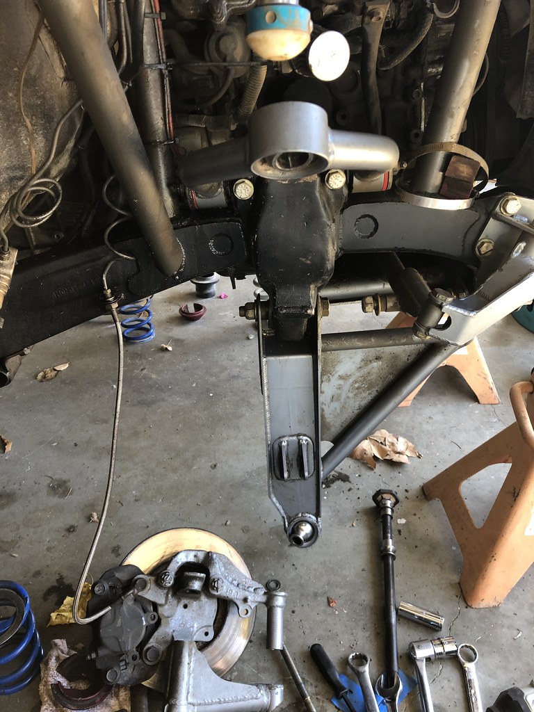

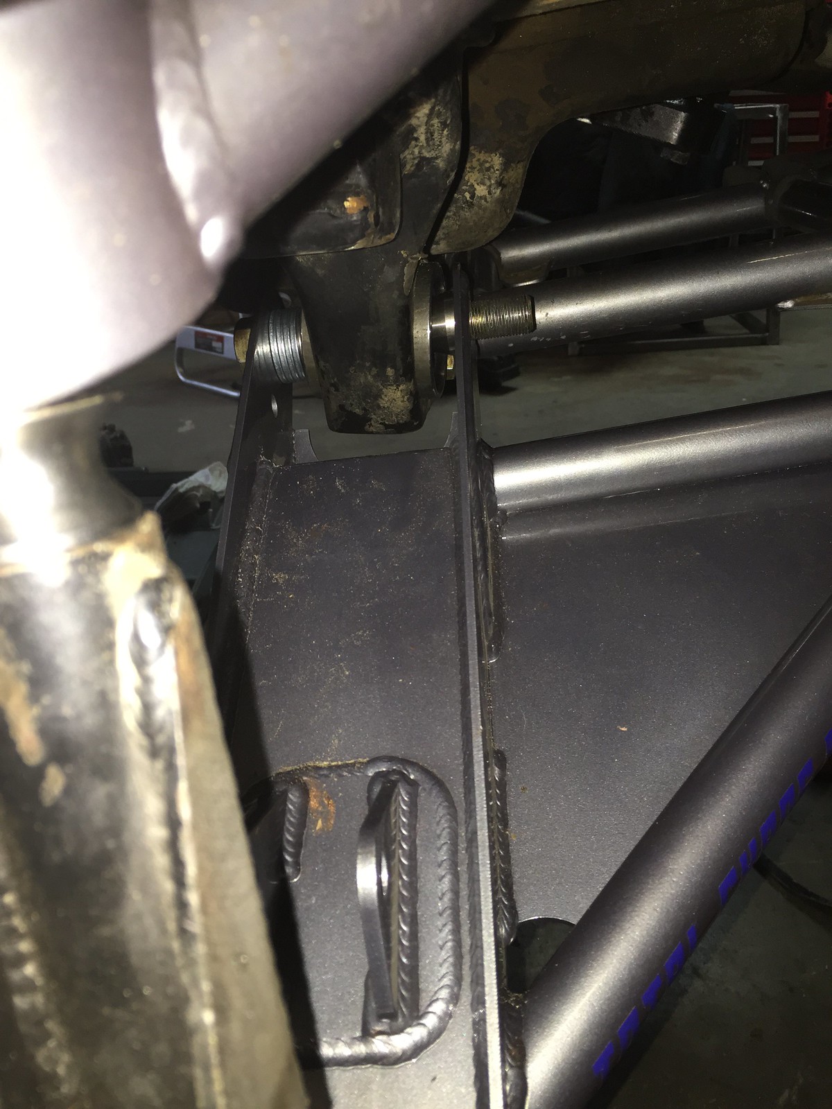

put that all back together... sorted out what i need bolt wise. then decided together the sub frame on. Crawled under there only to fine more bless from my lawn dart experience
Fawk!
Splendid!
Should have just beamed it or grafted a jeep liberty front end on to it.
Until next time...
No going back at this point!
Need to pick up the correct misalignments but after I get the those should be able to burn the uniball cups in and everything bolted up for final install.

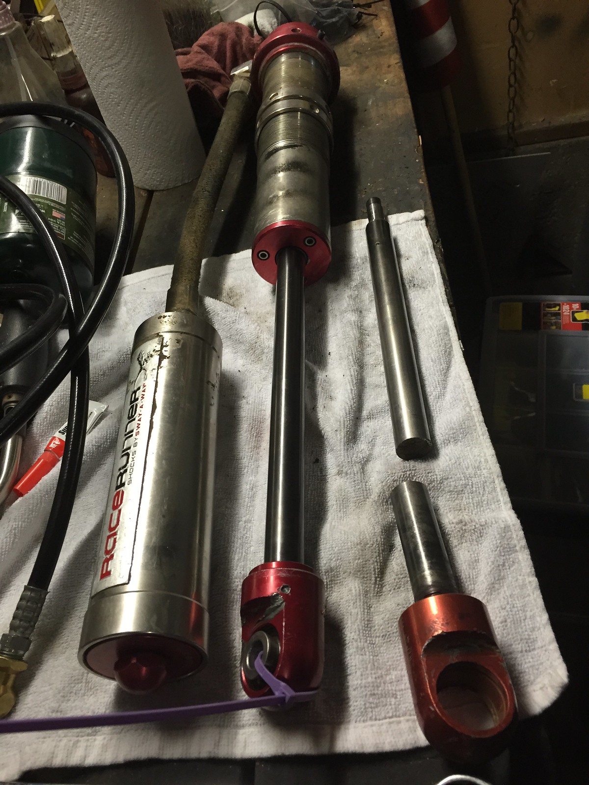

Rebuild shock. New seals oil and shaft.

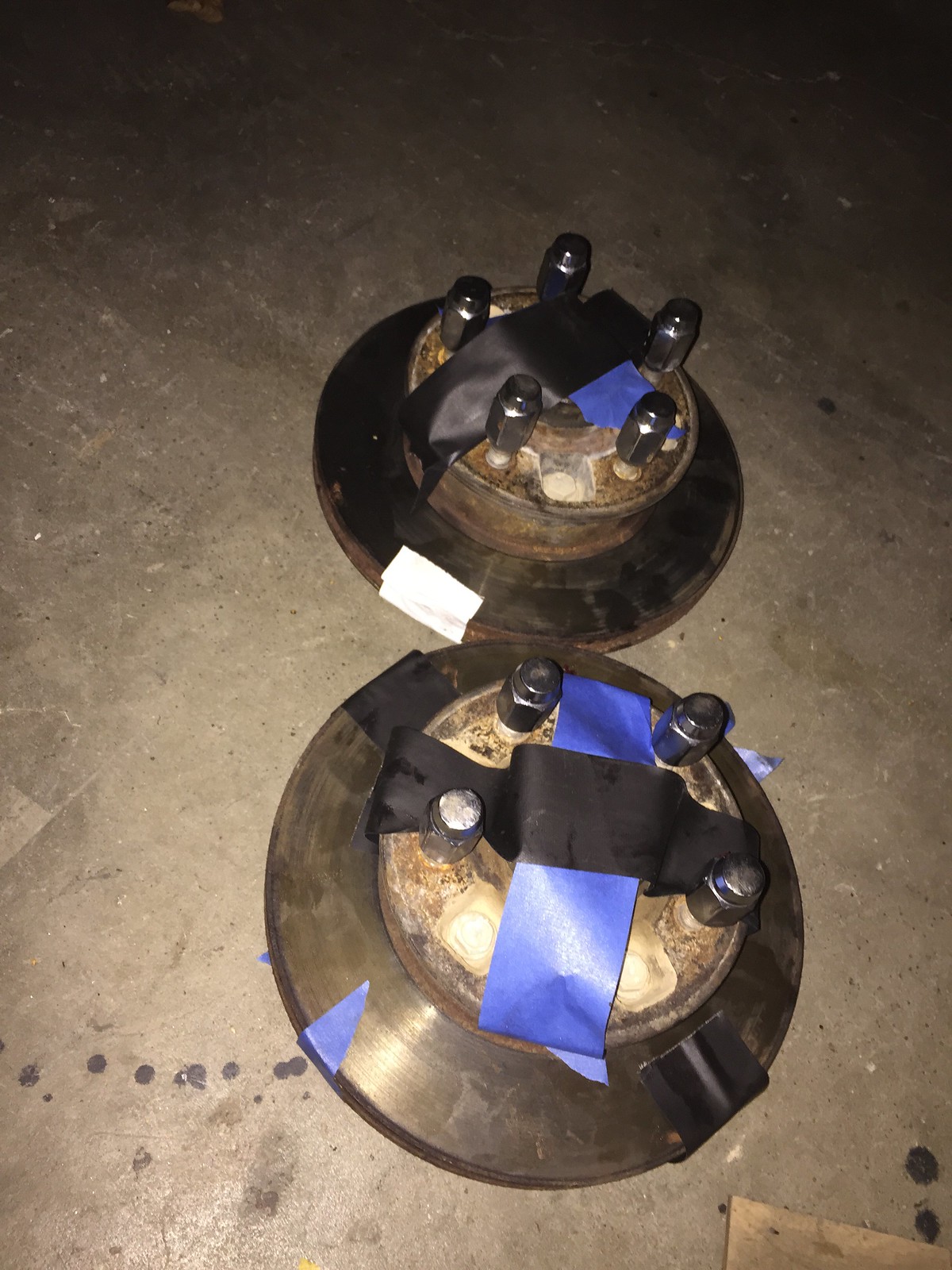

Picked up new wheel bearings..got those all ready to be installed on spindles... old races had some hairline cracks glad i was replacing these.
Small personal victory getting that TC pitman arm off. My HF pitman arm pull would not fit over said pitman arm after grinding the hell out of it still nothing. ended up hitting with some heat and little hammer and 2 pry bars. popped right off!

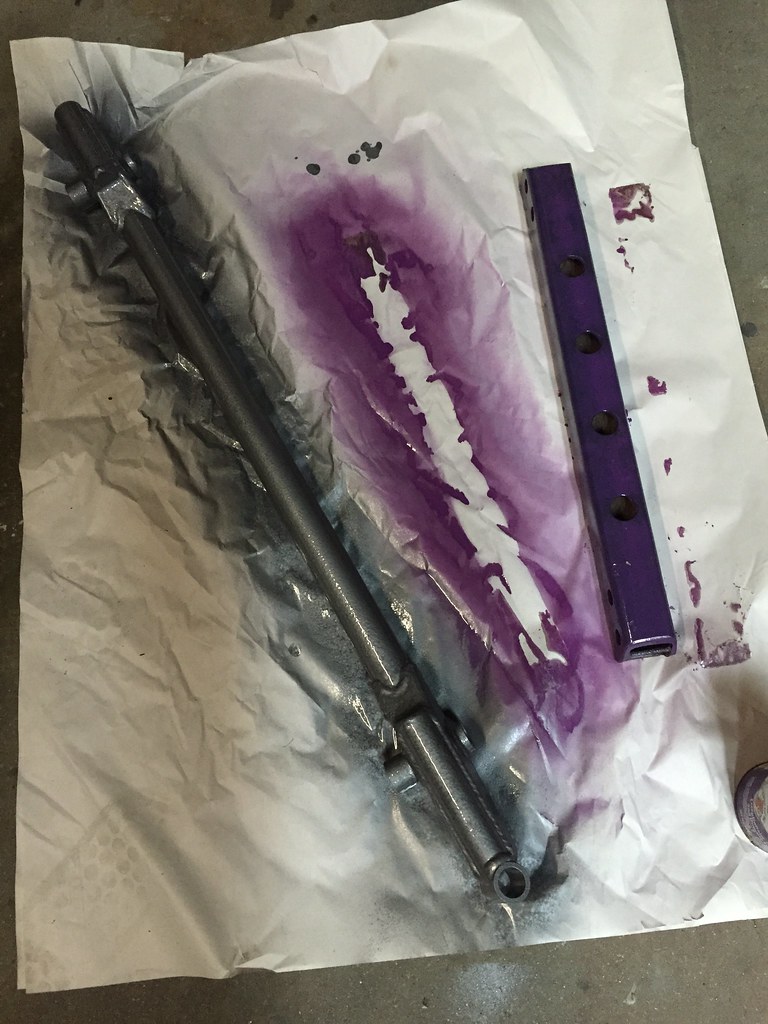

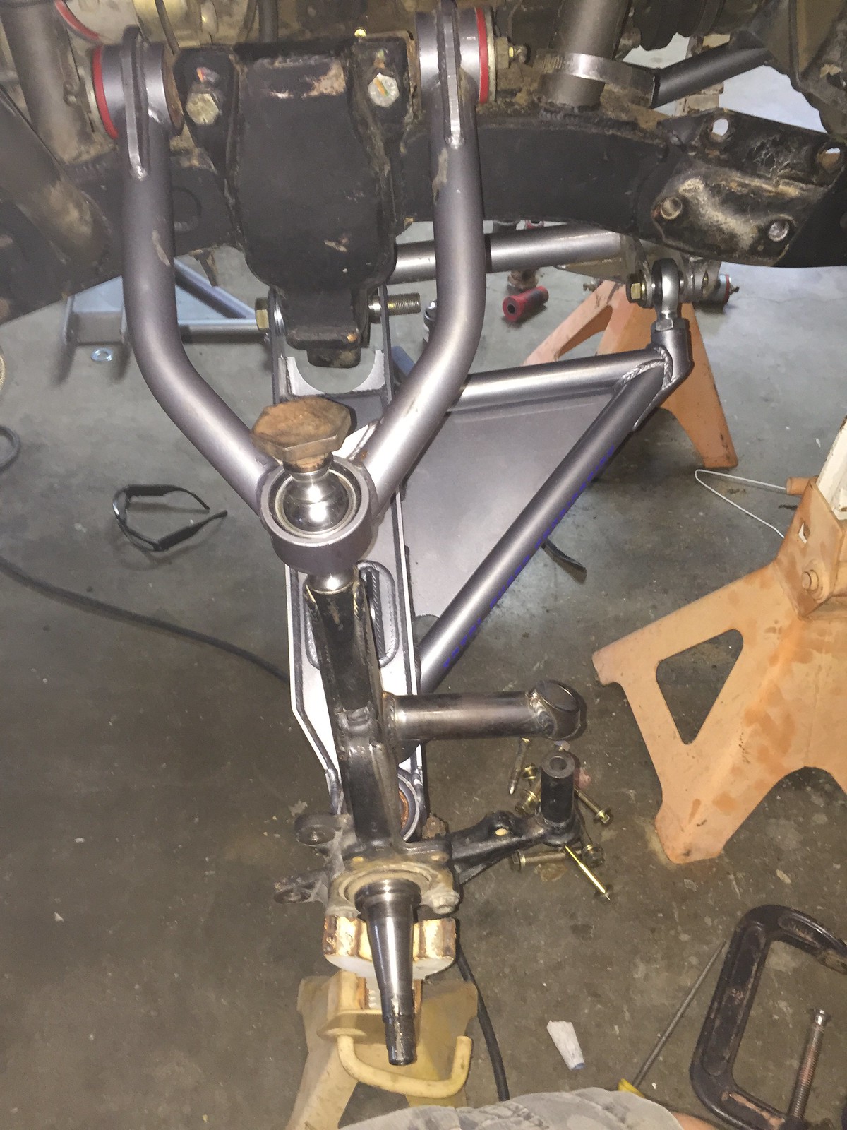

got it painted along with my spindles
New center link and repainting the cross member
This weekend will be back on all 4's!
Thanks to Tucker and Scotty and Young maxwell, and Gimmesand. over last few days she's almost ready for battle.

New steering box installed note that it already has dirt miles lol was in the bed of scotts truck on the Death valley trip haha

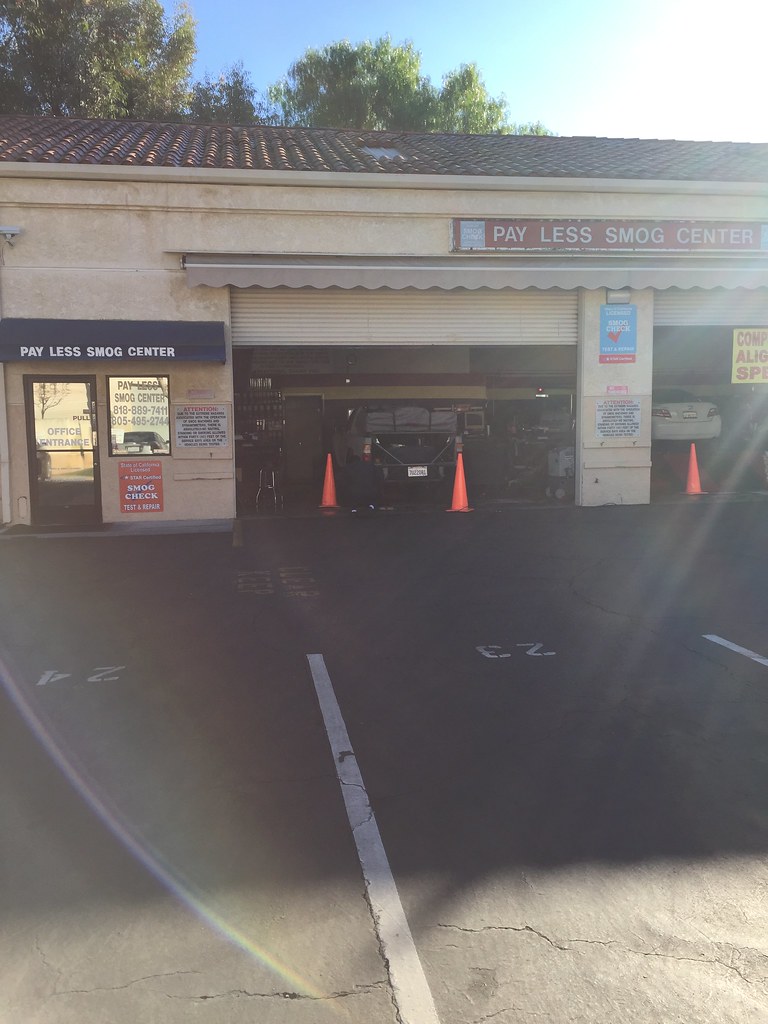

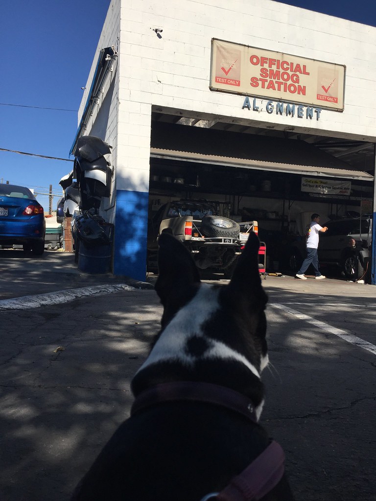

Olive and I failed smog a few weeks back.
Picked up a new high flow Cat. Cruised over to TT motorsports
And boom

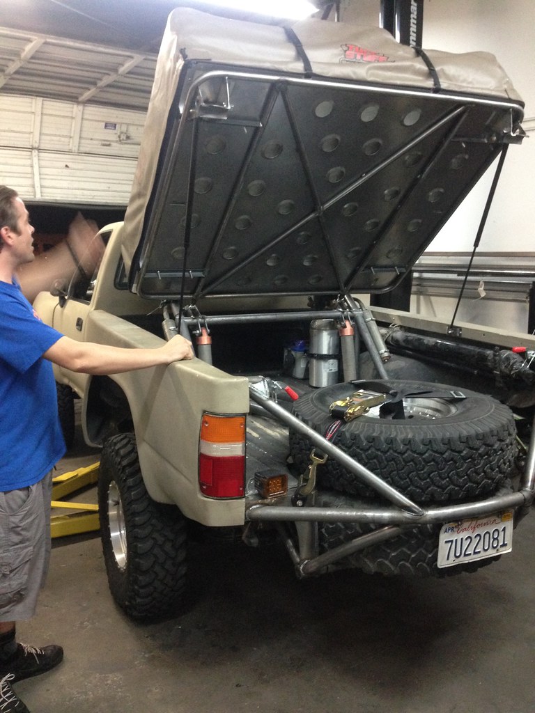

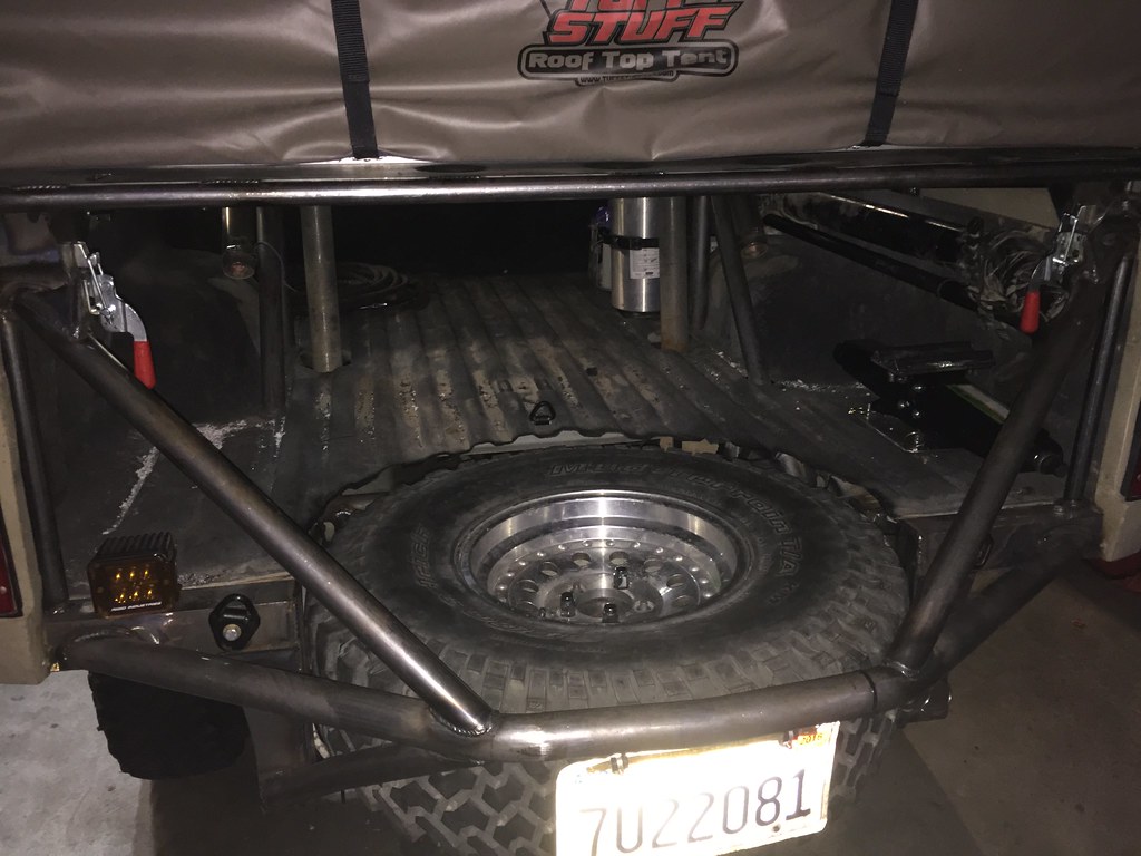

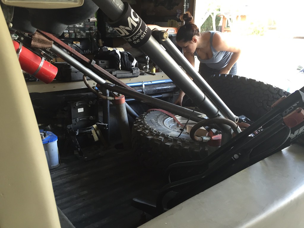

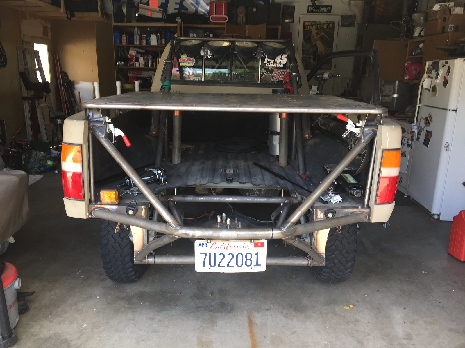

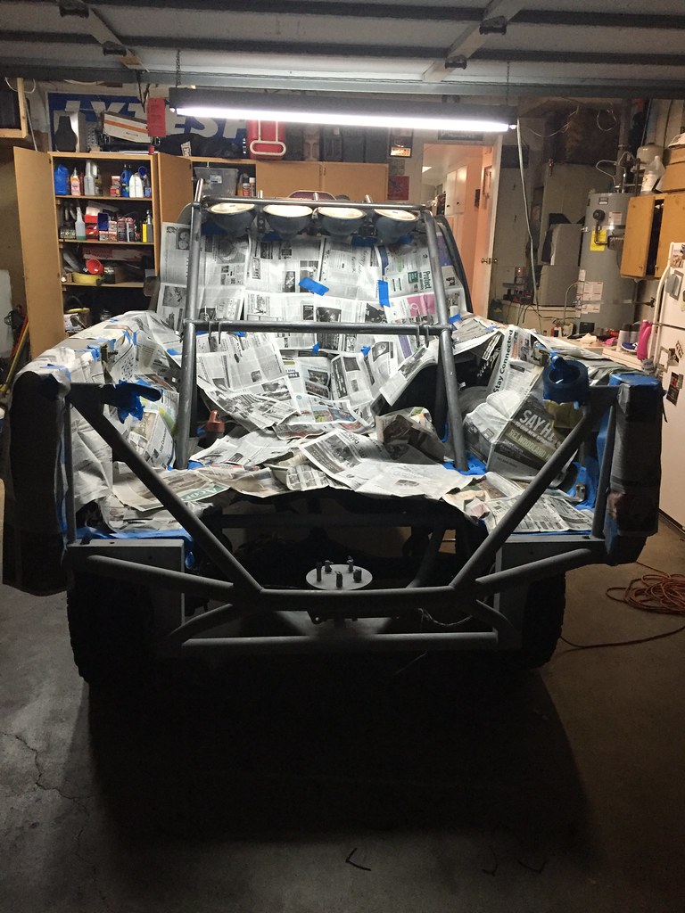

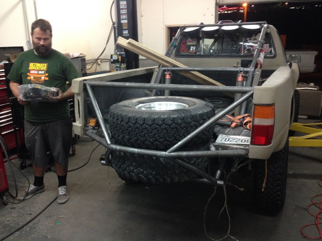

New bed cage wrap....
I need to do that to my truck really bad. That #beachlife really takes a toll on the metal. Assuming you're going with the same color?
Yea. just going with hammered dark bronze again. I have been lagging pretty bad on updates. Pismo for Carlos' Bachelor party was a good time. Truck ran well no issues that i can recall

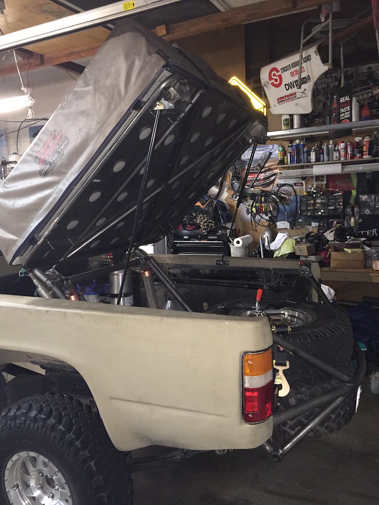

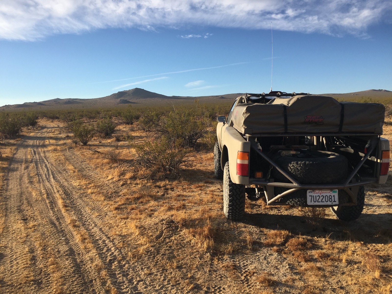

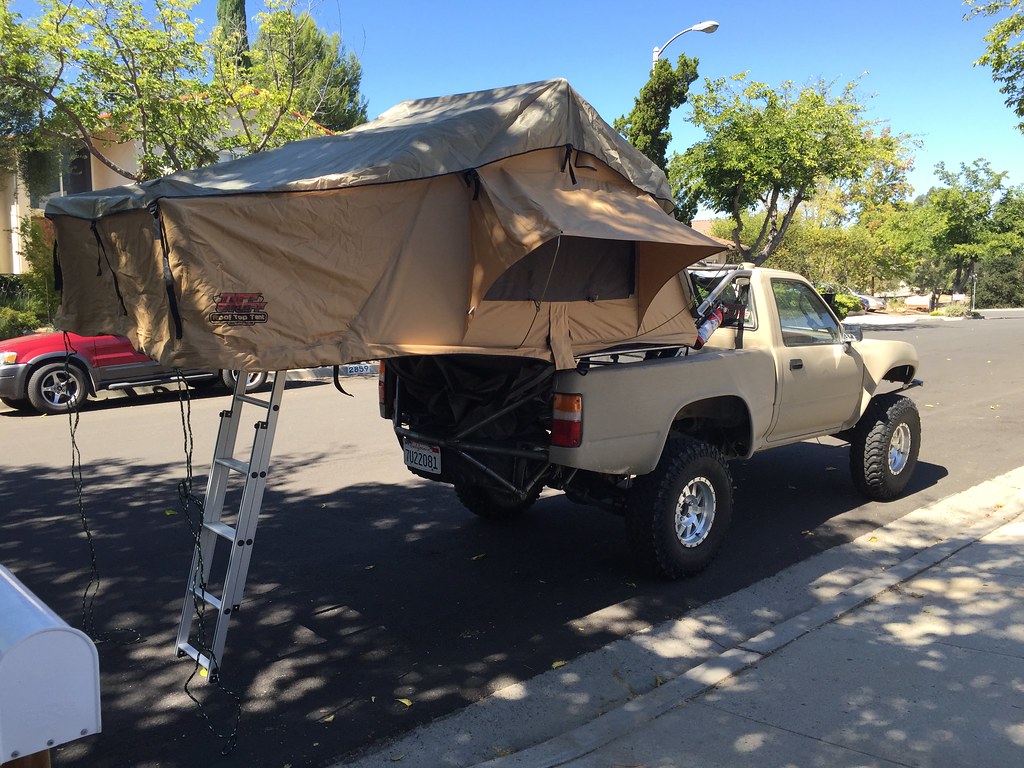

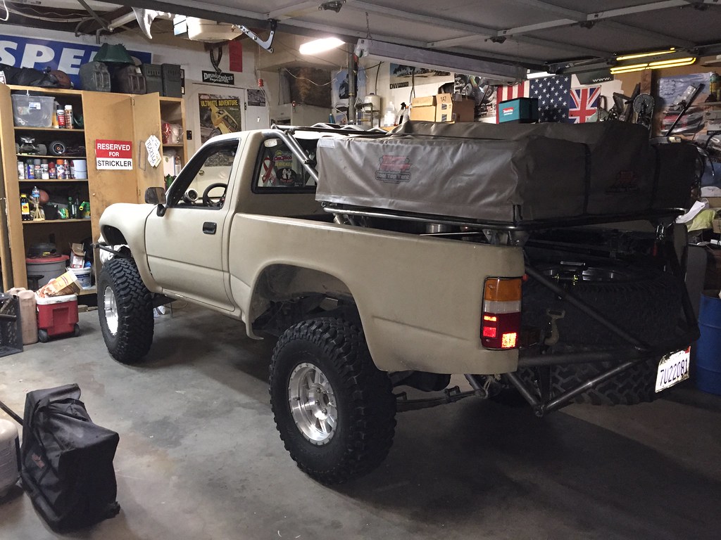

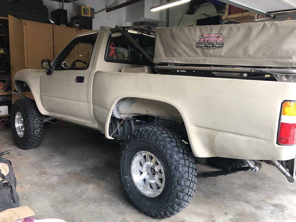

Had TTmotorsports (85yota) and only1mikey build a rack for my roof top tent and redo my spare set up. Pretty stoked how it all came out.
No tent just the rack
Working on getting everything painted and put back together. So we can go to give the new set up a shake down run Need to replace upper shackle bushings. Change Fluids replace front ballast for Hid Redo rock lights new license plate light reinstall pass door panel Replug sidewall ( safety first)Cooler Tie downs in bed

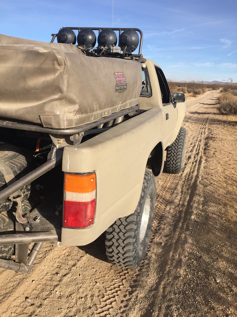

Took truck out for a little shake down run with new rear set up...So stoked! The tent is awesome. The functionality of the new spare set up for Loading and unloading was much easier, definitely going to take a few trips to get a system of where everything goes. As far as performance with the added rear weight, its just what the truck needed to get the rear suspension to work. Instead of bouncing over everything the rear seems to really stay planted on the ground. Can't wait to take it out again.
The tilt up Tent and rack provides shade in addition to it making life way easier to load and unload

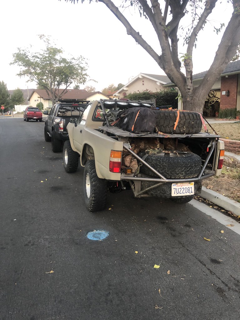

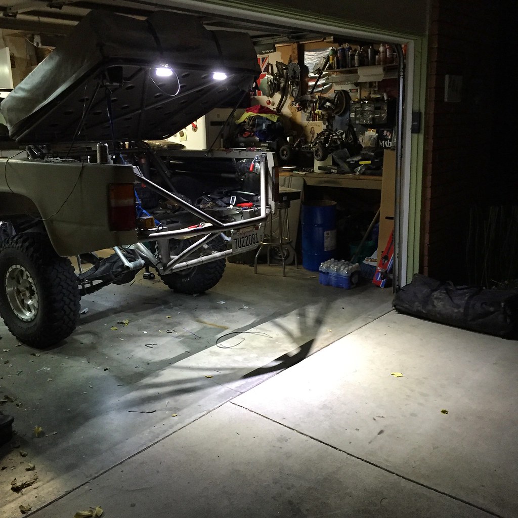

Gotta prep truck for thanksgiving. installing some more tie downs in the bed. Changing Fluids Cleaning Air fliter changing upper shackle bushings Adjust headlights Install new ballast for front HID nut and bolt check Install door passenger Door panel rewire rock lights wire up tent light
Nov 22, 2015
Tucker ( Thodges89) and I got a bunch of stuff done yesterday. Tie downs are installed Diff oil and Motor Oil have been changed Front HID Ballast replaced
Rock lights fixed
We even installed some work lights under the rack. Should be perfect for unloading and cooking
Few more things to wrap up before Thanksgiving and she will be ready to rock.

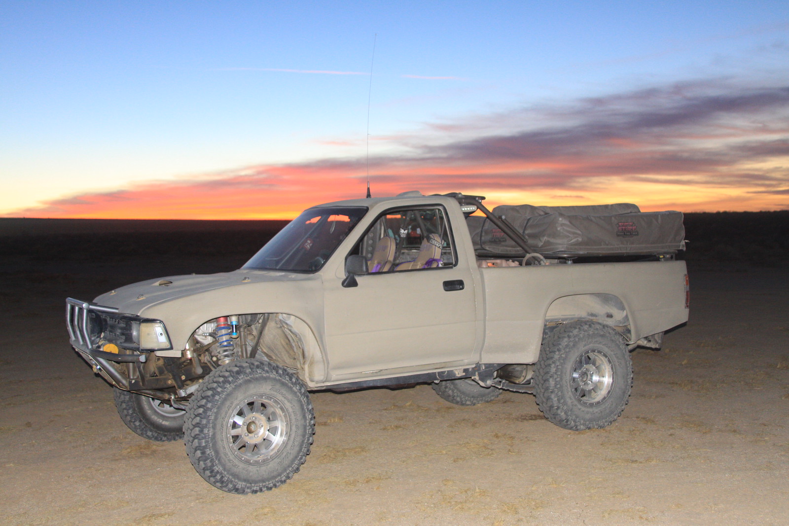

10 month bump Thanks Giving trip was solid...

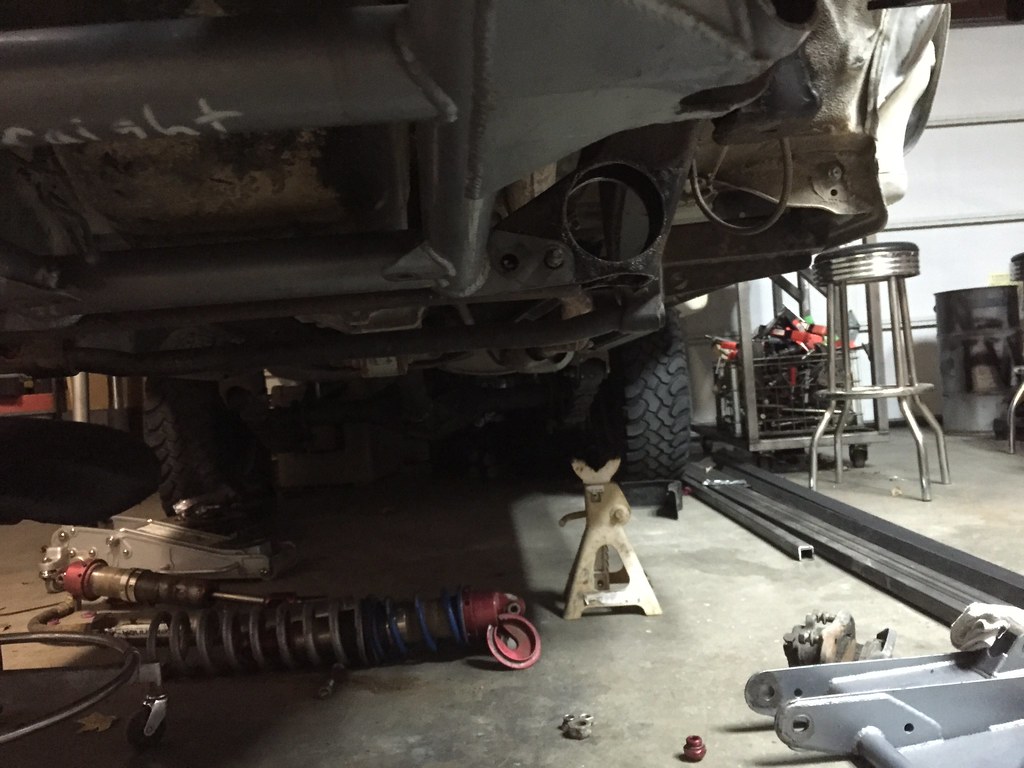

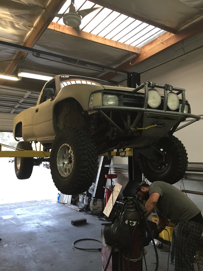

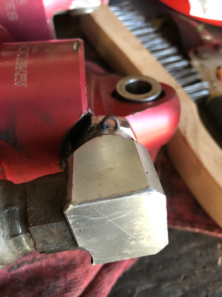

ended up sending the jump out by the pinnacles one too many times and bent / cracked the housing again at the spring perch. Locker was making all kinds of great noises. Limped it home and still drove it to work a few weeks as i toasted a valve in my subi
Having Wallace and Olive co dog at the same time was pretty interesting lol

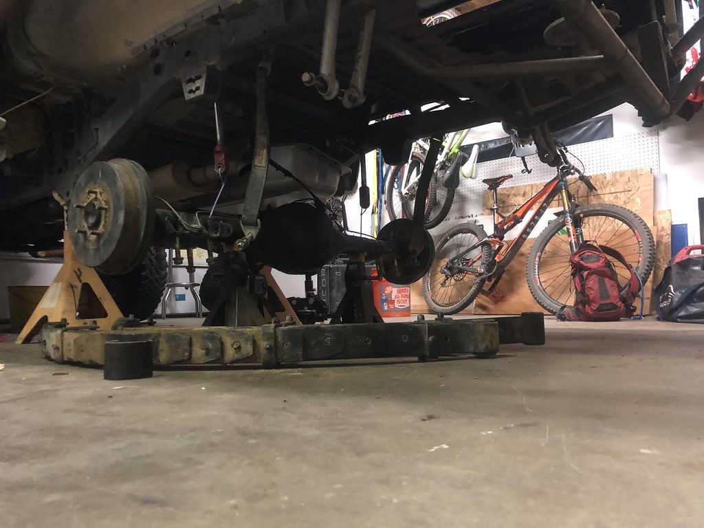

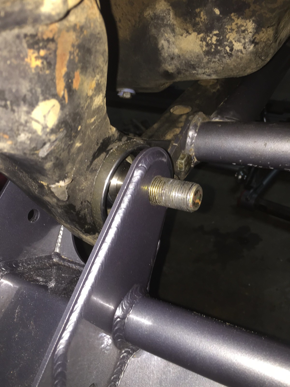

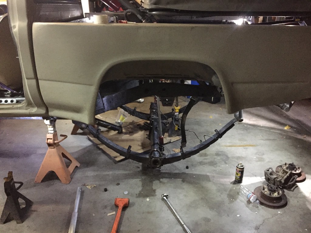

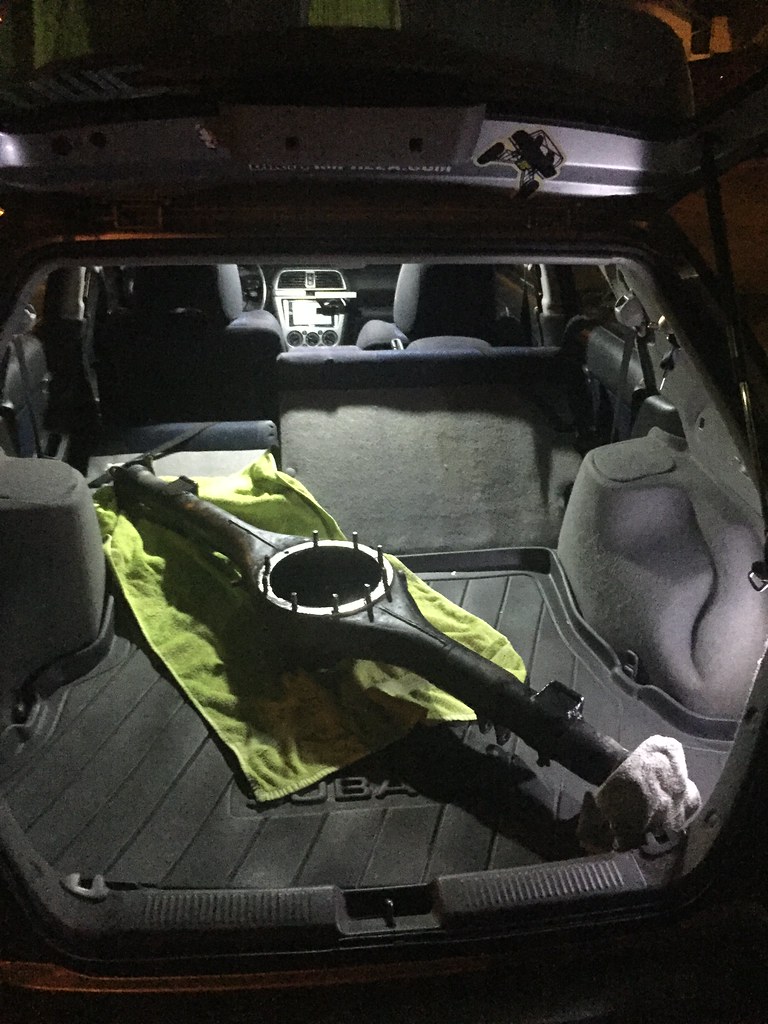

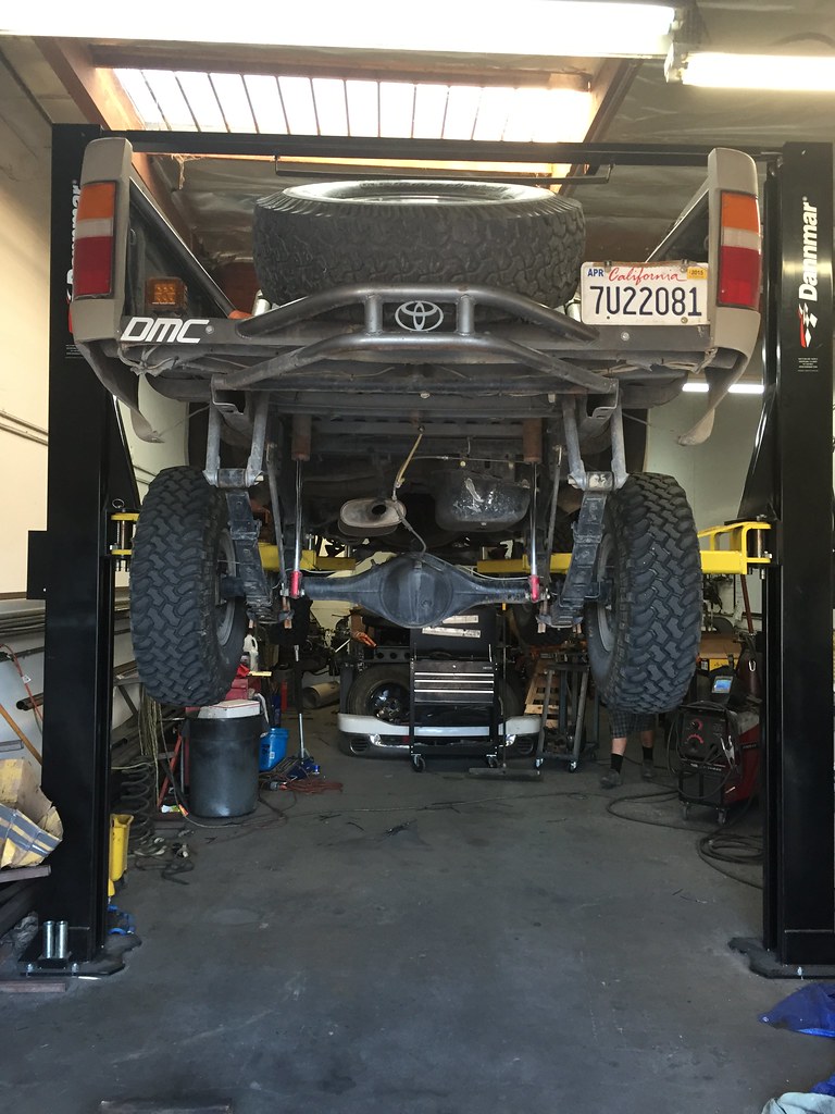

Finally manned up and pulled the axle in prep for the old man's bachelor party.
Had TT motorsports weld up the housing. Originally he was going to truss the housing but after getting it over to the shop, he let me know that it wasn't worth putting in money into. He straightened it the best he could and welded it up and told me to find a new housing. Also had the diff gone through. Everything was good to go.
Back In action for KOH and Old man's last Hoorah

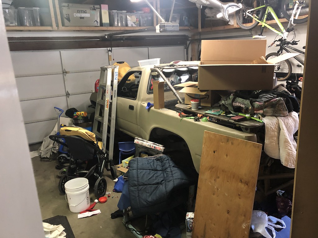

truck sat for a few months while we have been working on the house and taking a few trips. Until a few weeks ago, Kayla's Grandpa was in town. He made mention of wanting to go camping and ride in the truck. So we made it happen. I did a quick prep on the truck changed out that T stat, Nut and bolt. we head up to Gorman for the night.

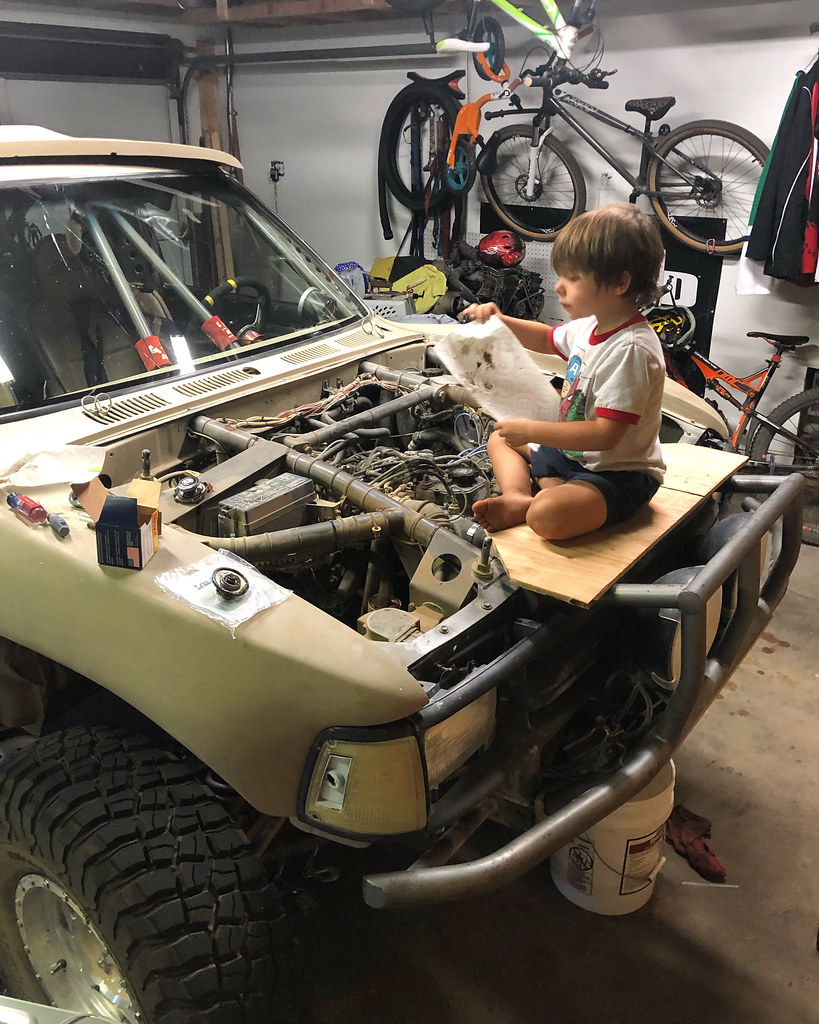

Stoked to actually have some motivation to work on this thing..
Need to address the wiring issue for the work lights.
Might pick up a new gas tank mine is leaking from a battle scar years ago on the Grand Canyon Trip

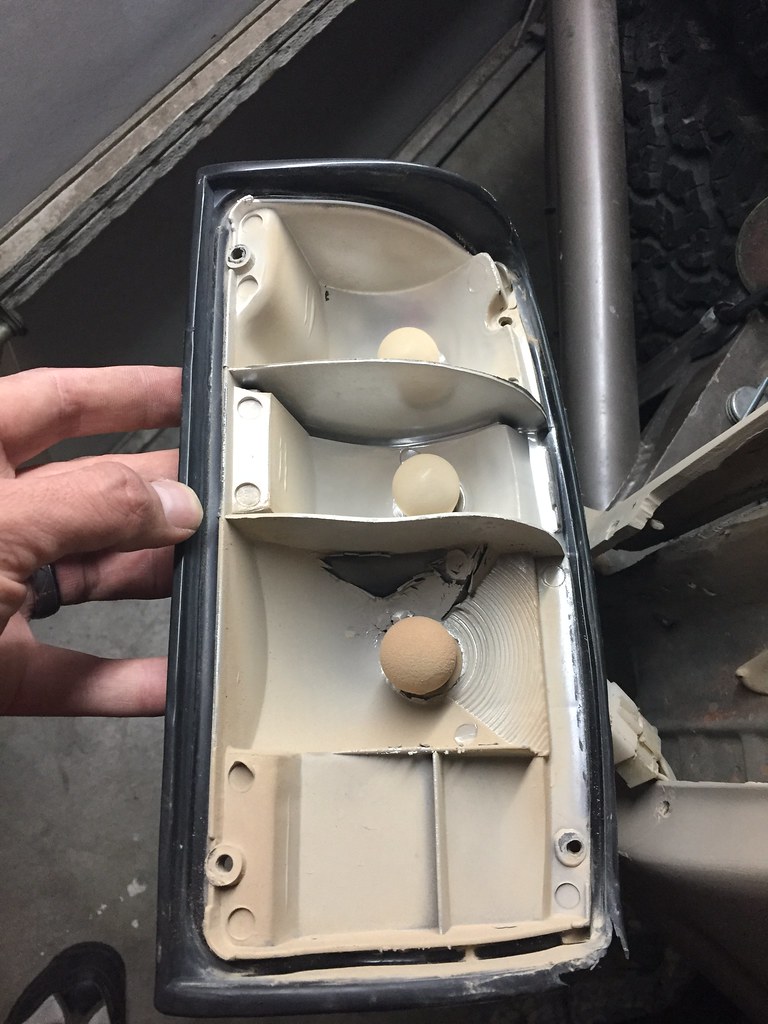

Also had a few people tell me they could barely see my brake lights so I was going to pick up some LED bulbs to swap out the stockers.
Hope to be back in the dirt ASAP.
Over and out
E

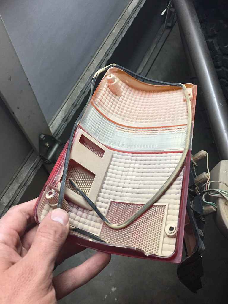

Brake lights could be bulbs/reflectors covered in dust. Had that before. Cleaned them and all was good
winner lol
I dont know what everyone was bitching about.
That bottom bulb is barely dusty...
Cleaned them off and we are back in business for the next few thousand offroad miles.

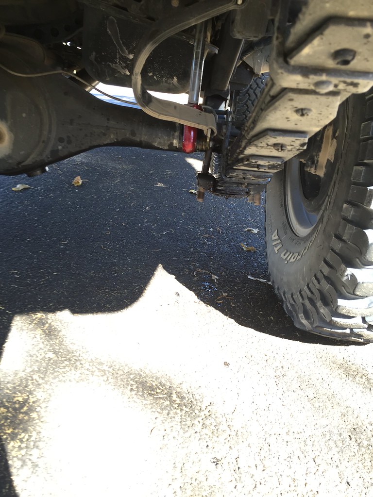

Exploded the wrap on the passenger side leaf in Ocotillo in March.. This paper weight has been holding down the garage floor since.

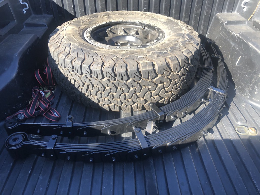

Fresh prepped springs from Deaver.

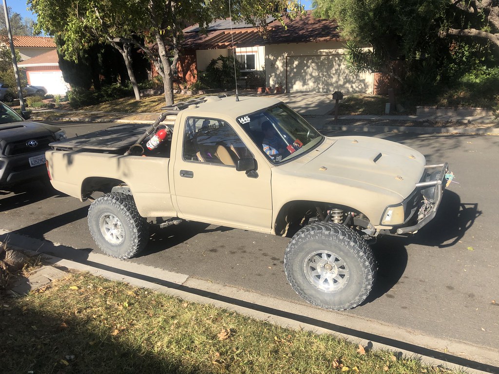

So after the Clean up this pile was in pretty rough shaped. Had a few clunks in the front ended up
Torre it down In Feb 2020. Was all ready to order up everything , when the Covid shutdown happened... With all the uncertainty truck took a back burner and held down the garage floor basically until the end up of august. Any way got everything and replaced all the heims and uniballs. .. Made the executive decision after Tommy's ordeal with his tires. The KM1 BFG muds had served enough time
Scope that date stamp

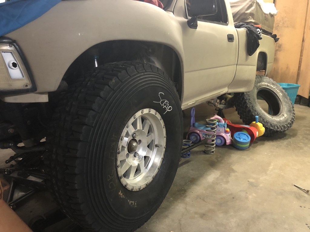

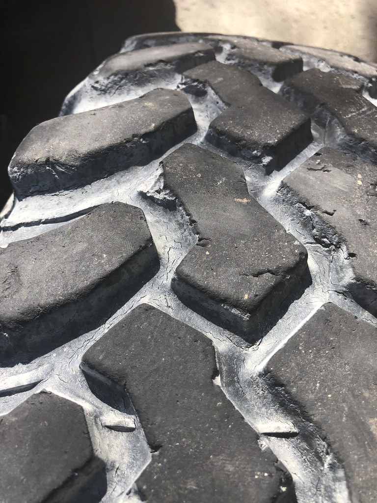

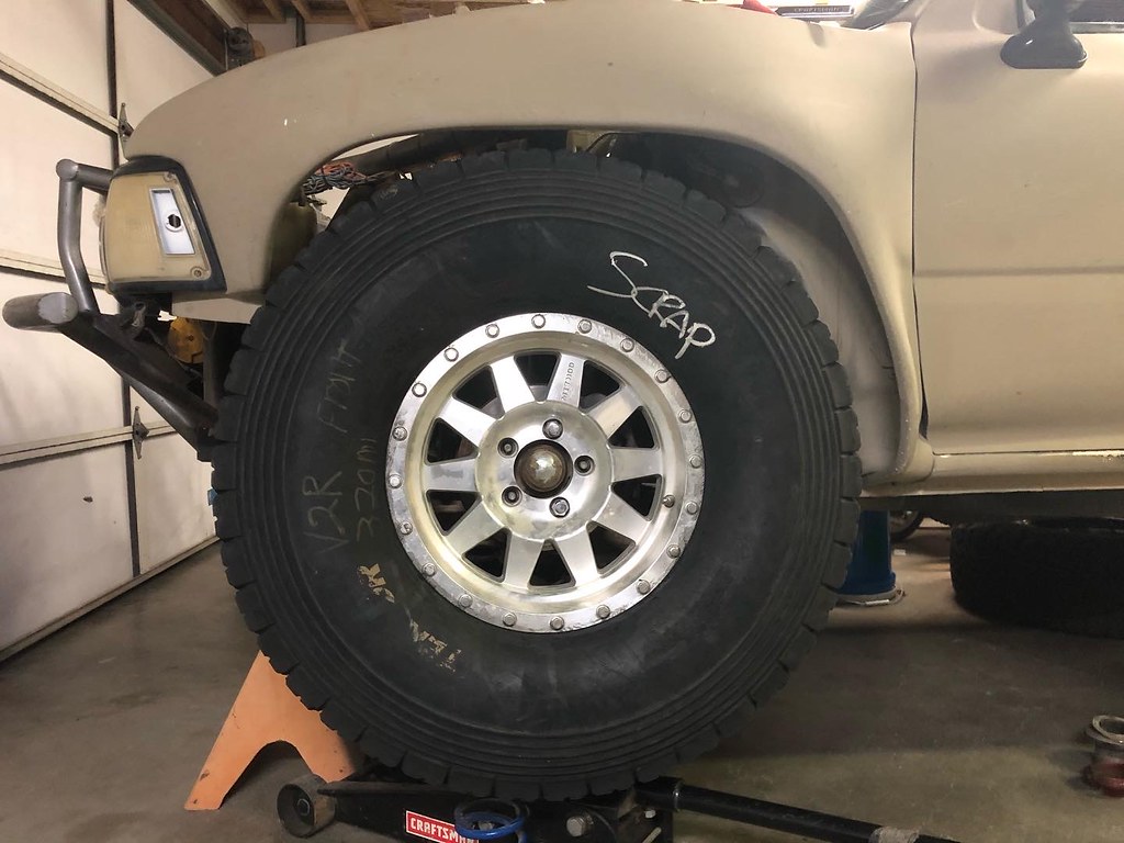

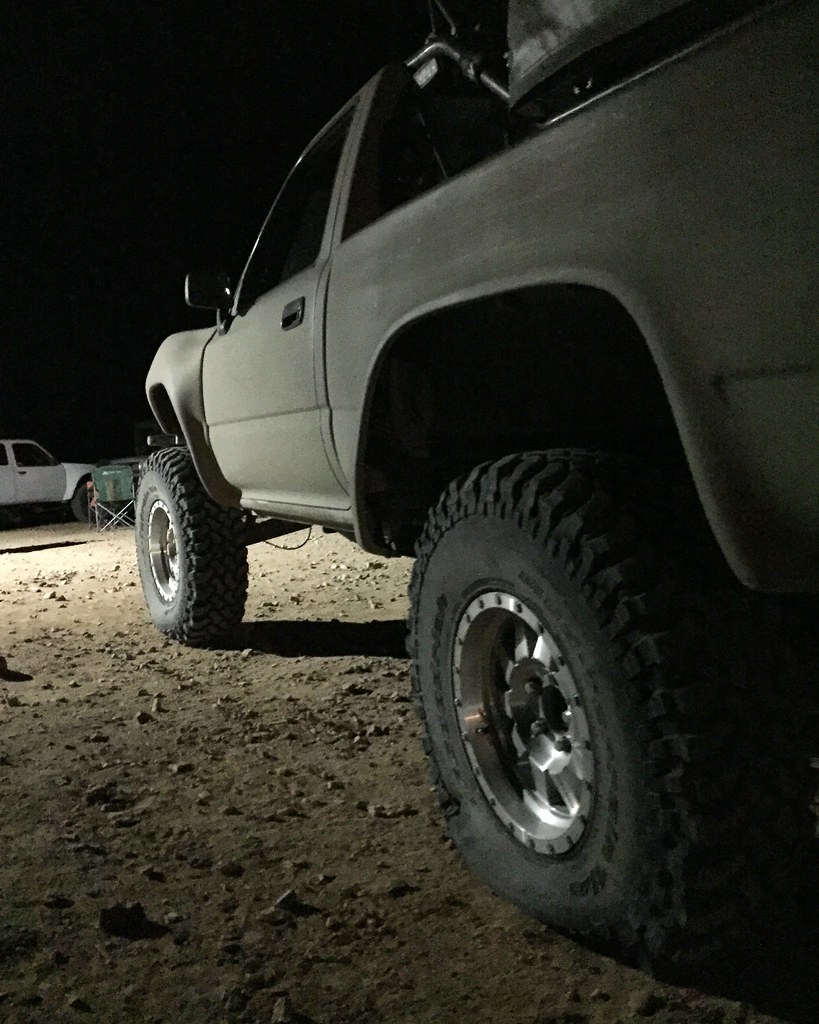

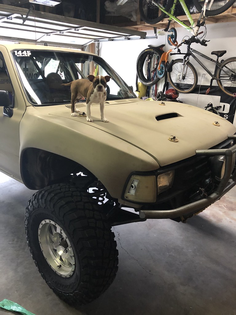

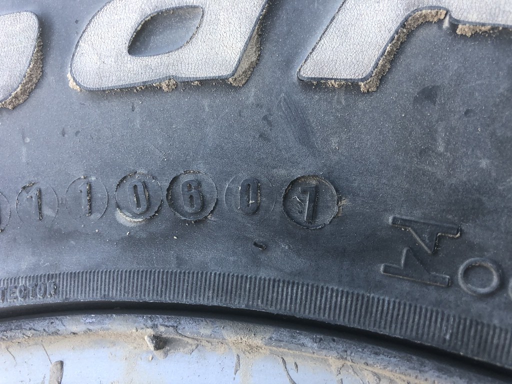

Got a wild hair to put the 35x10.5 Tensors on the truck had Stevyboy send me over a junk tire to mock everything up..
After weighing my options seemed those tires were going to last a few thousand miles at best. Not to mention all the work to get them
to clear properly at bump....
Had Only1mikey ( fab lab ) rebuild and revalve shocks
this is good right ?
