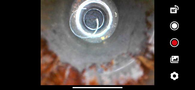

Where is the sound coming from exactly? I'd pull the valve covers and borescope the spark plug holes - you can get them for really reasonable prices on amazon.

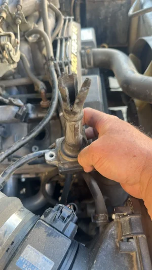

i finally took the time to start prying around and trying to figure out the noise... cylinder one the spark plug was loose, the ignition coil was thrashed and the spark plug was in multiple pieces. Someone before us did a number on this damn engine or something cause we have had cylinder 6 do almost the same thing requiring a heli coil for the plug.
So i planned a tune up - ignition coils, wires and plugs. started with #1 and fucked it up trying to get the plug to start, then went around and did the other plugs, coils and wires. its currently getting a heli coil in cylinder 1. hope it will be fixed by friday.
