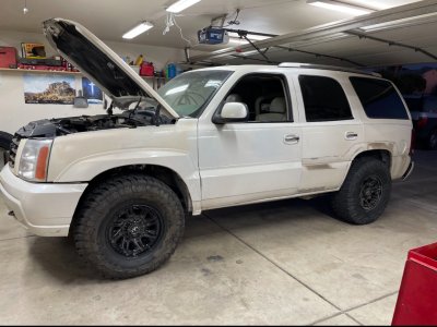

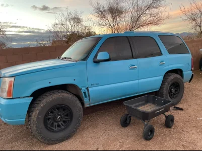

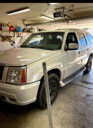

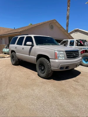

I thought I had more pictures of it when I first got it but here’s the one that I do have. Barely made the 10 minute drive home with it, later would find out it was a bad crank sensor and a worn out fuel pump. IMG_9311.jpeg
First thing I did after getting it to run and drive was to strip the annoying plastics off the side and put some 35s on it.

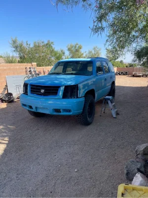

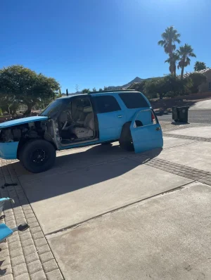

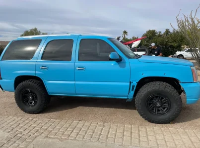

And with all the panels being different colors I went to Lowe’s and found some blue spray paint for this thing
Fast forwards a couple months I had to replace the drivers door and cab corner because when this thing was in a wreck the body shop that fixed it didn’t do it right so the door was held on by tek screws and bubble gum welds, so basically falling off

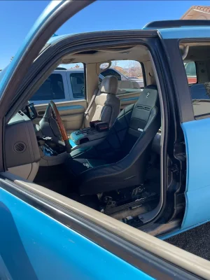

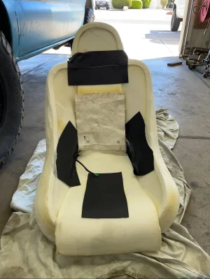

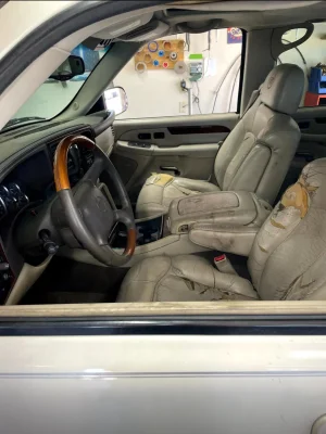

If my photos show right I ditched the worn out factory seats and put some corbeau Baja ss seats in, used the factory slide so I still have power seats, and threw in the back heater from the factory seats
once the blue had faded to the point it didn’t look good it was time for a change so I ended up going with rustoleum this time around and it looked great
After prepping it I used the best paint booth I could find and sprayed it

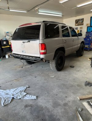

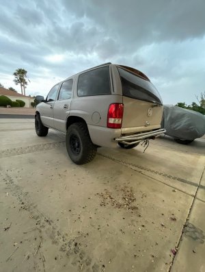

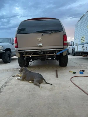

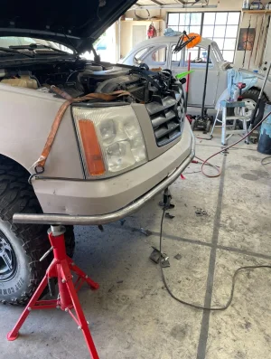

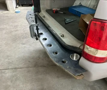

Fast forward it was time to do the bumpers so I started the rear bumper first then did the front and then finished the rear after deciding what exactly I wanted to do
Blue tape is the best for figuring out how you want to bend your tubes

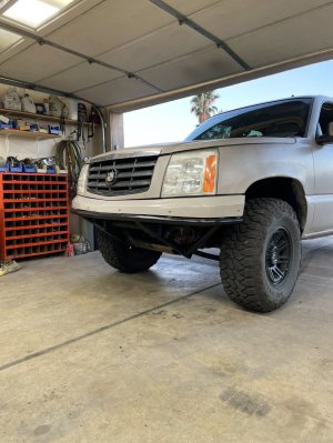

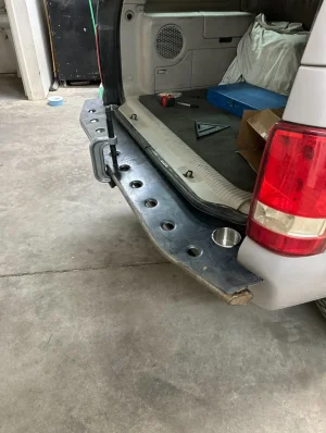

Later on I would add a front skid plate using 3/16 tempered aluminum. Finishing the rear bumper I learned how to dimple die and wanted some cup holders built in for camping, and why not have cup holders. Also cut my rear quarter panels while building the rear bumper

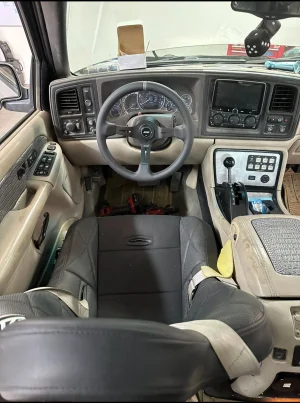

the next thing I wanted to do was put a gated shifter in it, ditch the rest of the wood grain panels inside and throw in a cooler steering wheel

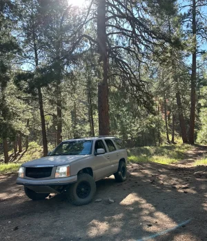

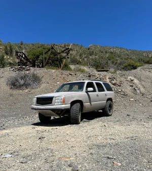

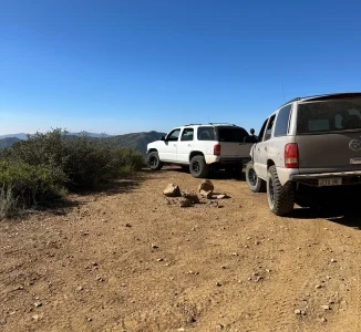

Little trip update, went on a back road from kingman az to yucca az and back. The radillac did almost everything in 2wd until I was trying to show off and got stuck between rocks, so Everyone got a good laugh.

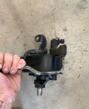

Went and explored an abandoned mine about half way through, everything was good besides a little power steering pump wine but I didn’t think much of it.

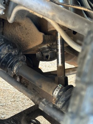

And then about 5-10 miles before home it became more of a yell than a wine, shortly after it started yelling I lost power brakes and power steering. Hoped out and added about 2/3 of a quart of atf and it was back to normalish, but probably only made it a mile before it went quite and lost everything again, so added more fluid which poured straight onto the ground, so I drove the rest of the way home like a caveman with no power steering/brakes. Took it apart today and my pressure line had came loose so I’ll add that to my check list. Besides that everything worked great and everyone had a great trip… besides my bump stop which didn’t appreciate the little jump we hit
