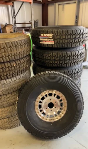

And then switched out 6 tires for the race golfcart. Figured out a decent system and had them all done in about 2 hours. Fuckin still sucks ass though. These tensors dont like to bust off the back of method wheels. Nice having a tire machine though

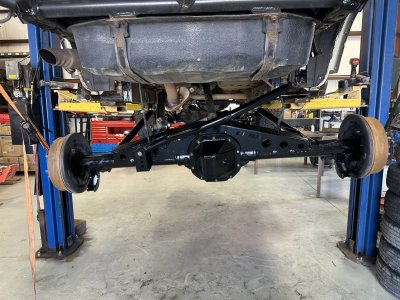

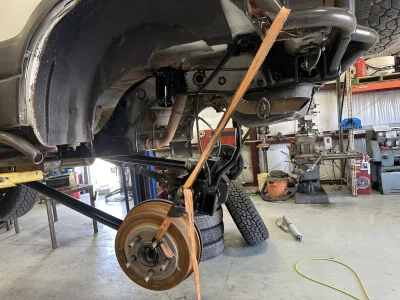

Tore the ass end apartheid to inspect and clean. 7 years of abuse and no cracks or issues so paint it got

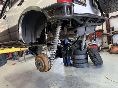

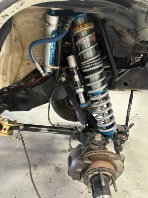

Shocks were already rebuilt but with the new front end and the fact ive slowly increase rear end ride height 3” from where it started (was 4”, now 7” of shock shaft showing), i noticed the back end going through the rear bumps on g-outs. So i took them from 2” stroke to 3” stroke. Filled completely to the top, then removed 10cc of oil and run 60psi of nitrogen.
Just had to cut 1” out of that bottom spacer
Back together

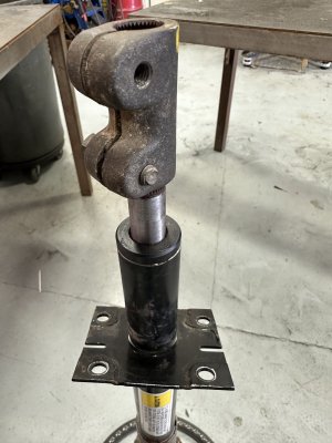

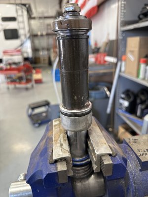

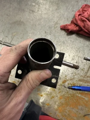

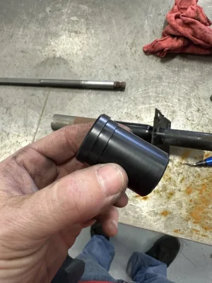

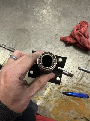

Next was fixing the god damn interior squeak that would cause a nun to punch little babies in their soft spot. Yes, it was that fucking bad. As i was scouring the dash for cracks in the steel support, i decided to pull the steering column. Soon as i lower it, there was the noise! Come to find out the shaft was sliding in the end bearing and that bearing was shot. Thus, metal on metal contact making seal team 6 torture worthy noises.
Took the bearing out and make a delrin bushing instead. The original shaft didnt need to float in that end bearing but since i now have a fixed shaft between that area and gesr box, it needs to float. No biggy as it collapsable within the column and meant to slide. Made it .002 slip fit… thought that was great till i drove it. Since the turbo down pipe is by it, fucker caused the bushing to grow and make it hard as hell to steer after 15 min of drive time. Took it back apart, cut .010 out of it and its tits now. As rouse told me “Science” 🤣

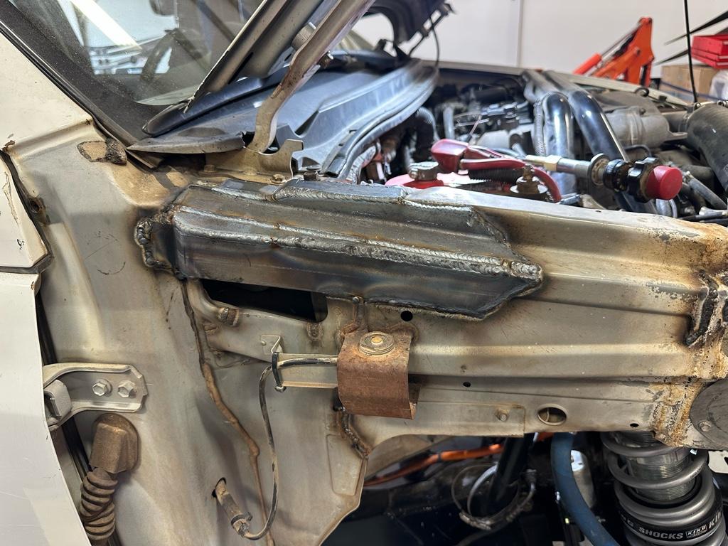

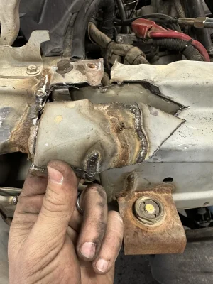

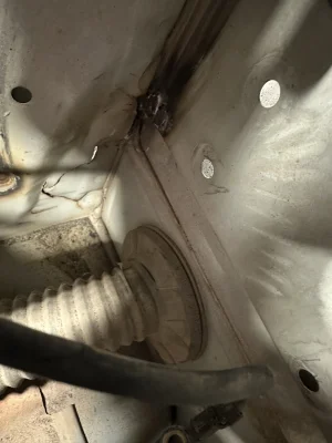

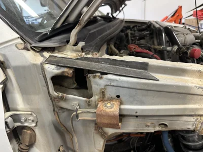

Also noticed the battery seemed loose. Seems my innder fender has had enough with life
Going to weld that up and do a little plating. I have a feeling its been that way for years. The outside has always had an issue wirh cracking. This is the side that the rig was originally smashed in from by a deer when i bought it 10 years ago. Doesnt help my body mounts are fuuuuucked. So the fix is mas steel. May wind up finally go full tube up there at some point. Welder ran out of gas so it all needs to be welded still and i have more plating to add
Once this is done, its on to making frame body mounts out of 3/16 steel and addressing some small cracks there as well as all new body mounts bushings in this thing
Alright, shit welded back up and much stronger.
No pics of the battery tray. Was getting side tracked with people comin and goin in the shop. It got welded back together and a brace added to support it. It lost alot of support when i cut the inner fenders apart for the coilovers

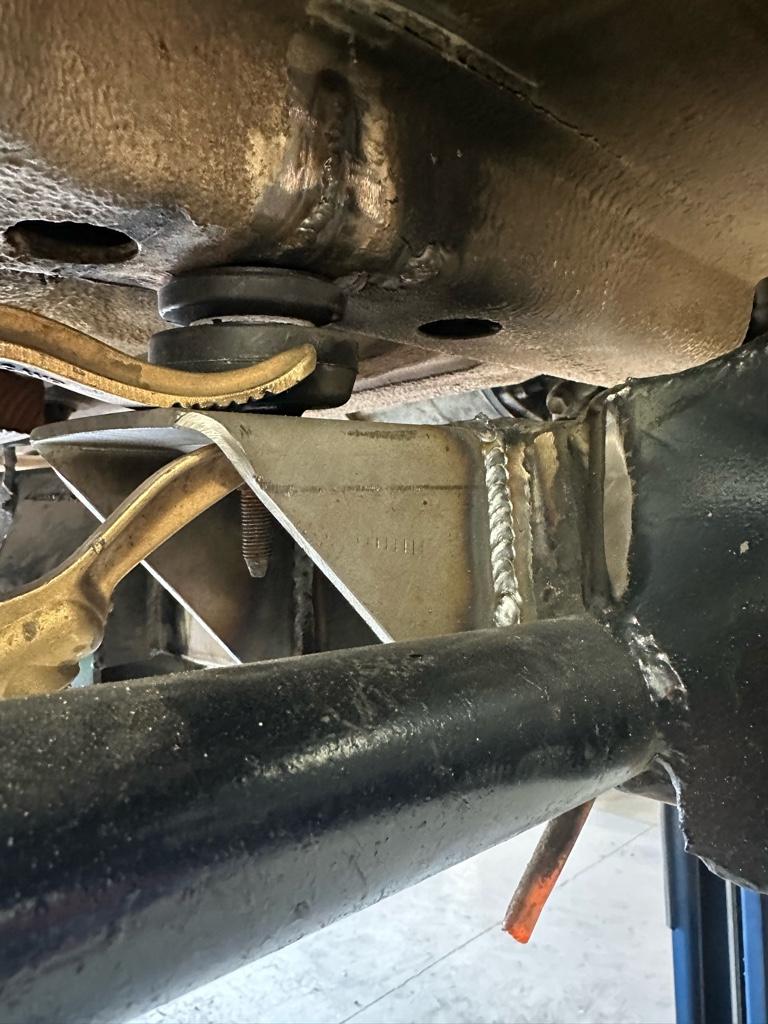

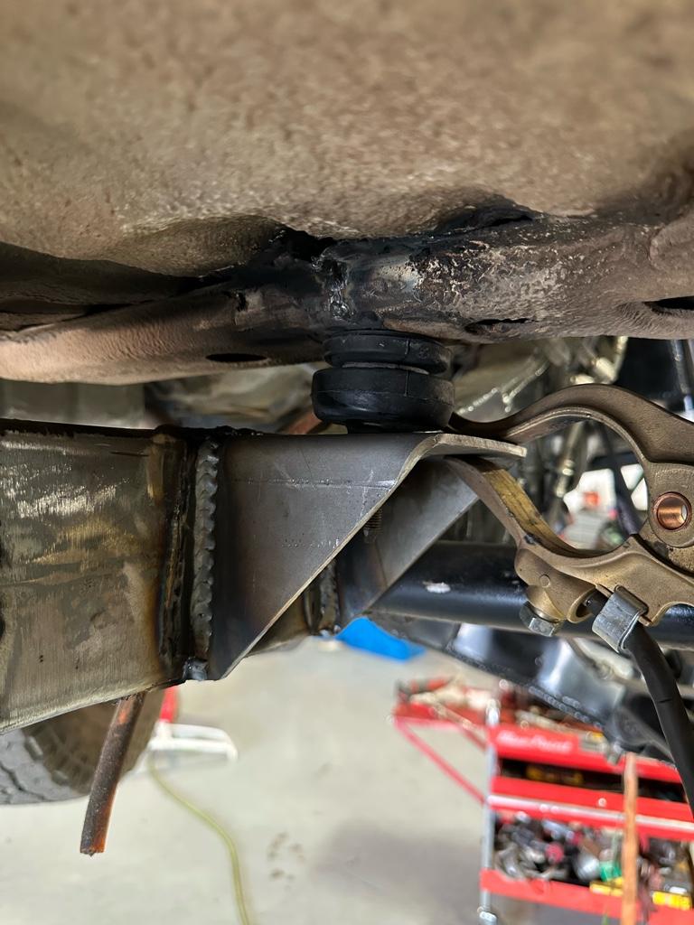

Next up was the body mounts on the frame. That thin chineseum steel wasnt cutting it. Both mounts on driver and passenger side under the firewall have blown out multiple times and been rewelded multiple times. They are now sagging 1/2” from what they should be and aint straight.
Frame cleaned up and body welded back up from all its cracks
New bracket made up from 3/16 flat plate steel. Dimple die the center hole to meet the rubber mount better and welded it in

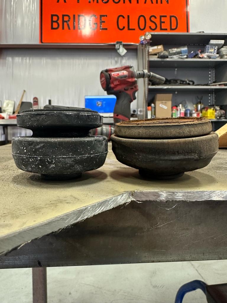

I’d say they are shot

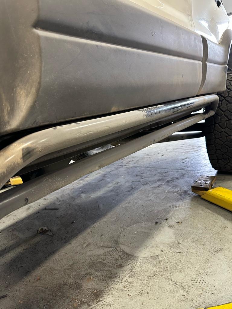

Painted it all up and then did the driver side today. Also put all new rubber mounts in, both top and bottom all around the rig. Had to get creative on that because i couldnt lift the body from the frame due to the rock rails. Popped the rear with the lift and used the jack i keep in the tracker to wedge off the lower link and life the body enough for the mounts
Front was simple as just the core support needed new mounts. I put the new rubber in before i welded the mounts in for the firewall mounts
Now there is an actual gap between the rock rails and body much like it was 10 years ago. Waaaaaaay better
Sooo much quieter in the cab and a little smoother

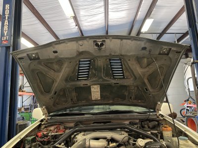

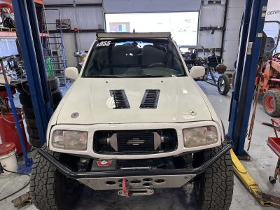

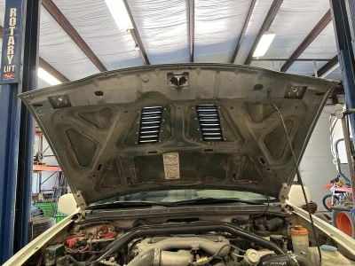

Put some motha fuckin race louvers in. Trying to help a/c work better and get more heat out. Turbo makeo mucho heato, a/c condenser no’o likeo

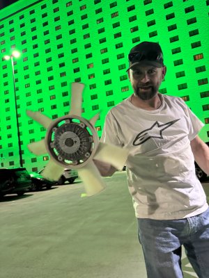

Boo. Fan shroud broke, took out a fan blade and i had to hack two blades down 1/2 way to balance it out.

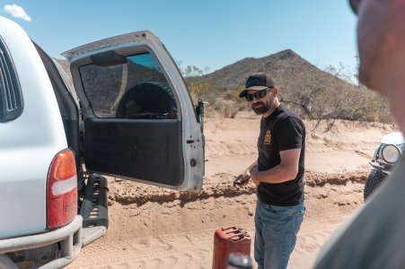

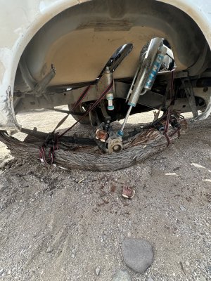

At the fuel stop, made repairs and slammed food. Get in the wash, buddy runs out of talent and explodes the axle off the tacoma
Install tacoma rear axle saver and drag it to a main road for a tow home via his buddy. Lucky that same dude went to a JY for me and got me a used fan. Minty mother fucker.

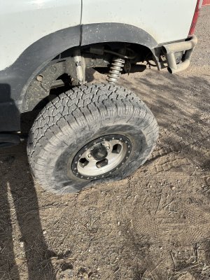

As i decide to haul dick to laughlin (30 miles out), smack a rock at retard speed and blow a tire

Awesome work and great that you are out using it like it's meant to be. The hood louvers look awesome and are a nice accent touch. I like the 2 angled smaller panels rather than the whole hood style that some Jeepers run.
Yeah i hate those, these wound up working out perfect. Now to get the damn fan shroud to work. I may try a high powered electric fan from a car/truck
Taurus fan for the win. I ran that on my trans cooler and radiator on my old 89 Toyota race truck. Shit load of amps but pulls a lot of air and only $20 at junkyard
