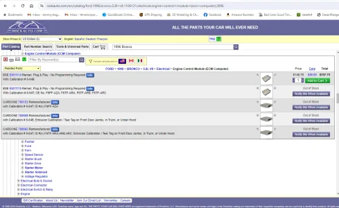

My experience with the Brick nose and newer Bronco's is that the ECM like to fail and get corrosion. The 96 ECM is specific to that one AND a lot of places the remanufactured ones are out of stock since they're different for CA or Federal Emissions. Currently Rock Auto has only 1 Calibration # ECM available

The computer is different, wiring harness is alittle different, timing cover is different, uses a 1 year only 4 tooth reluctor wheel that hasn't been made in a long time for missfire detection. System is super sensitive and turns the CEL all the time.
Just went through the whole ecm problem on my 95 luckily places still remanufacture them but they’re are like $500 through those companies

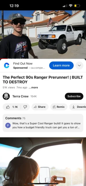

I was watching an older Terra video this one below. And he’s running 37x10wide tensors and I was wondering if anyone has any input on putting those on a 1988 bronco I would prolly run the 35x10wide just because idk about a 37 yet and I wanna keep it simple but can anyone help with my decision or why or why not I should do it. I’m new to broncos and just joined the forum.IMG_2404.pngIMG_2404.png
