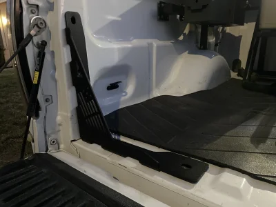

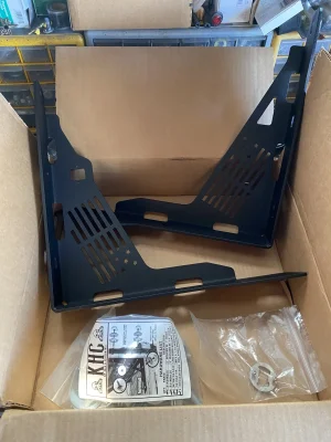

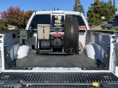

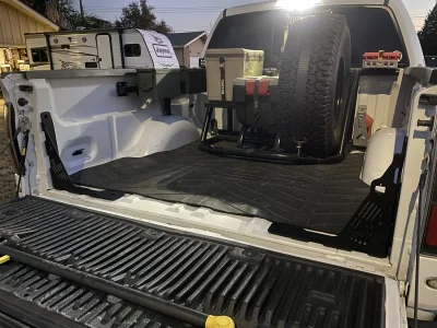

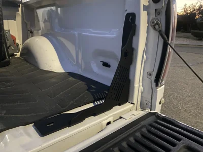

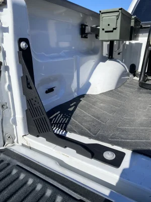

Bed supports showed up today from Krazy House Customs. They weren’t my first choice but my red raptor buddy RJ convinced me to do a group buy, which made them relatively cheap(er). I ordered new bed bolts (not supplied) and will have nuts tig welded on just like I did for the bed rack bolts.

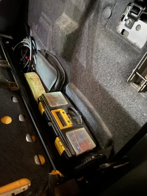

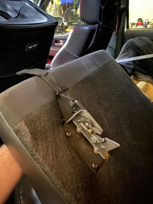

I also forgot to post that I picked up a Builtright Industries rear seat latch which folds the rear seat back down to gain more in cab storage. I was actually able to cram quite a bit of gear back there.

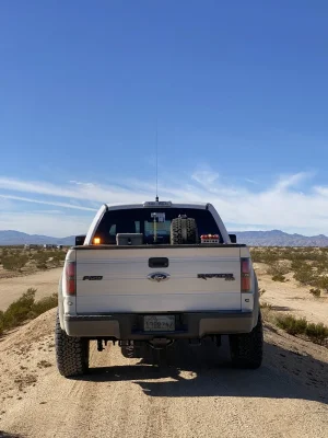

And lastly, want to mention that the beefier tab I welded to the bed rack for my whip worked great for the flag run at the clean up.

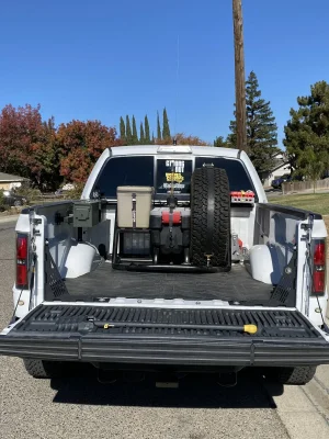

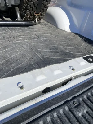

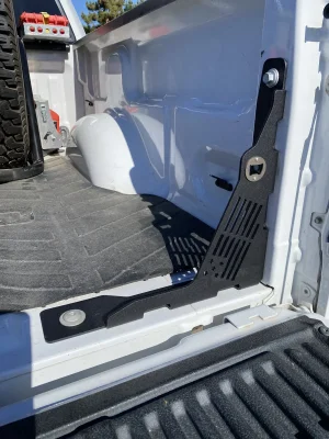

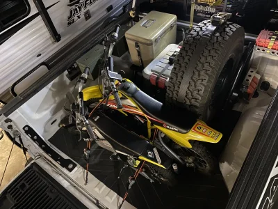

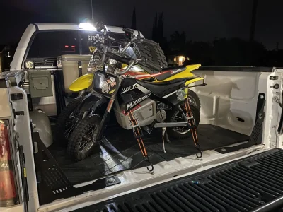

Ok, moving on. Last night I installed my KHC bedside supports and 2 small bolt on D rings to help tie down my little Razor dirt bikes.
Ordered amber covers for my Gravity Pros which will be here tomorrow and did an oil change. Should be ready for the desert next weekend!

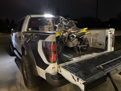

Pre ran the electric dirt bikes tie down setup in the bed for next weeks trip. If you guys don’t know about these little Razor bikes, you need to (if you are 220lbs or under). They are a fucking blast for around town with your kids or cruising around camp in the desert. About a 10 miles range on my son’s and a 40 mile range on mine.

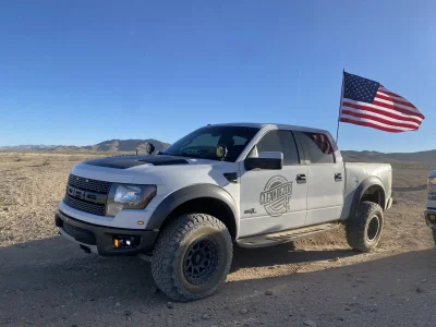

Trip report for our Thanksgiving run was posted in “Trip reports” but I wanted to post more pics of the truck here… Each day the truck felt better and better. Coilovers quieted down quite a bit. I did notice i was getting a lot of brake fade driving it hard quickly through various turns so maybe at some point a brake upgrade may be in order. Overall im impressed.
