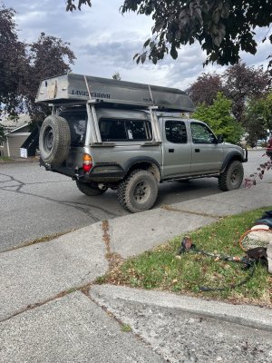

Hey everyone, my name is Graham and I’m over in BC Canada. I was referred by Elliot to join the group and possibly do a build thread up on here. I’m a bit of a noob when it comes to trucks, I’m in the middle of a LT build with my 03 quad cab taco, learning lots as I go. When it comes to bikes I can nerd out with the best of them, it’s rad that the forum hosts both topics. They kinda go hand in hand with my friend group.
For my taco, it started out as a bone stock vehicle. American truck, had 150k Miles, but got it before the Toyota tax got crazy. Wanted something to go fishing, hunting, camping and shuttle mountain bikes with. Came with the factory e-locker which was a big selling feature, but quickly realized I needed to do some work to it if I wanted to keep it in good shape and out last me.
So I started with the classic Bilstine 5100s front and rear, UCAs OME Dakar leafs and some 33s. This made it a little more capable and fun but with that added confidence in the truck I needed some protection and recovery mods. First it was rock sliders, then front bumper, then a winch, then the rear bumper, boat rack, Cascadia solar panel on the hood, some lights.. Took me a few years to get it to this point, but once I got there I wasn’t fully satisfied with the end result and wanted something different, classic. So I did the only sensible thing and I entered “the rabbit hole”

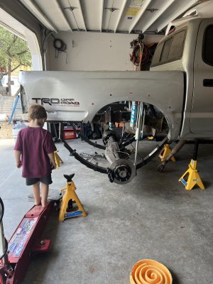

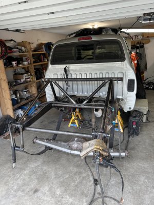

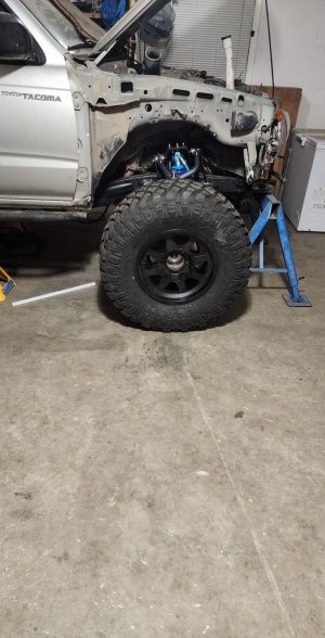

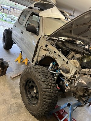

Long story short I chose to go with the LT kit front and rear from Total Chaos, and have been tinkering on this new build with a friend for the last couple months. Here’s a couple photos from before the new build started and where we’re currently at.

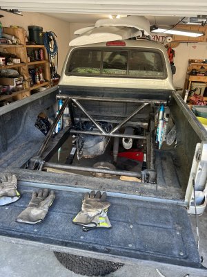

I’m definitely going to try and keep as much bed and bed room as I can. Obviously will need to build a bed cage to accommodate the rear suspension. There are a few other guys with the same truck and LT builds that I’ve seen and have been asking them a few questions about. Still a few more I need to ask..

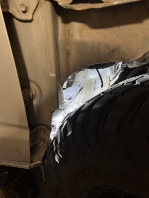

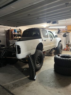

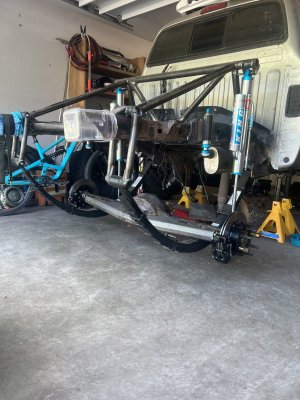

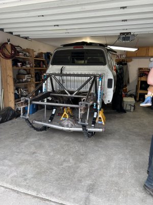

So it’s been a while since I updated this and I’ve got a question for all the wizards on here. Been slowly chipping away and making decent progress, got my axle all built up and trussed. Got the bed cage built, frame boxed, rear shocks mounted including the bumps, and brakes. All that’s really left now is getting a rear driveline made, mounting the bed and the GFC.

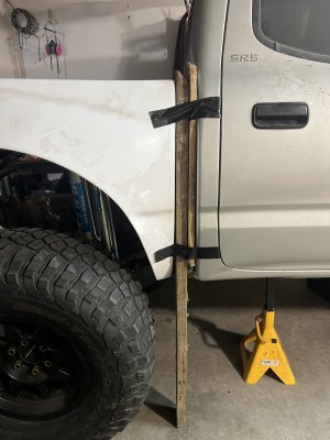

Heres the dilemma/ question that I have. We’ve mounted my axle 4” further back from stock location to allow for a better driveline angle and to clear 37s down the line. I had already ordered my fibreglass before doing this, it’s the ADV mini bed (5.5ft) 4” bulge 3” rise. Now with the axle being pushed back the wheel well doesn’t line up of course. The way I see it is either just cutting a larger portion out of this glass that I have or I order one of the 6.5 fibreglass bed sides and give it a bob. What’s everyone’s thoughts on this? My goal is to keep the tailgate and build onto the bed cage to ether accommodate the GFC.
Any tips ideas or advice would be great! Here’s a couple more build pics as well, cheers

Either way you're in for some fiberglass work. Cutting the wheel well open is real tough to look good so you may end up extending the front to meet the cab. A 6.5 bedside would at least give you material to work with to cut down the front and graft back together. A 37 won't fit without cutting out the entire lip anyways, especially with the movement you're going to get from the leaf springs. Find a picture of DWphoto's truck in the air and the tire almost touches the front corner even with it biased rearward at ride height.

Those were the same ones he has order the dbl cab short bed 4” flare 3” rise or vice versa but from glassworks.
I would think the standard length bedsides would be best route. It may line up with a bit trimmed off if you only need four more inches between cab and wheel well. But I don’t know shit lol

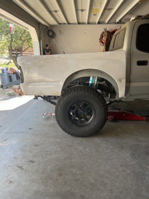

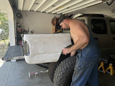

Appreciate all the feedback, I think I’m leaning more towards ordering the 6.5ft bedsides and trying to sell my 5.5ft ones before I cut them up and destroy them. Attached a photo of how we were thinking of mounting the fibreglass on top of the rear end of the stock bedside utilizing the stock light buckets. Hopefully be able to bob down the 6.5ft fibreglass bed slides clean enough to do something like this. If that makes any sense?
My next question is which size flair should I go with? Do I need to go 7” so that wheel/tires can suck up inside for max travel or would I be able to get away with only a 4” and possibly a bit of trimming? I seen one other guy with very similar truck build as I’m doing and he has the 4” glass and it is close.
Appreciate all the input!

I have glassworks 4" Front and Rear on my truck originally with the stock 6' bed and camburg kit up front. I ended up with the Mcneil 6" front fenders, Hannemann Supercharger Hood, and Fiberwerx 10" bedsides (which still had to be kicked out on rear to cover the econoline 9" with method wheels and 37's)

Since the last update we have added a few things. When I originally got connected with and ordered my kit from TC I added the secondary shock hoops knowing I’d add these down the road. Well when the lower ball joint conversion came out I of course hit “add to cart” and figured since I’m already paying the shipping and taking the front end apart again I mine as well add the the front triples to the cart at the same time. I also got connected with the good folks over at Baja Designs and will be wiring in a bunch of new lights in the front bumper, rock lights as well as an S Pod to conveniently control it all. The most recent addition to build is going to 37s now instead of later. I found a decent set of 37x12.5x17 KM3’s with a brand new spare for cheap so jumped on those. My Tundra was in need of new tires so the 35 KO2’s so it conveniently worked out.
Still need to get my glass mounted and sorted out on the rear as well as finish the bedcage so that I can mount the GFC. Also need to finish welding in the second shock hoop on the drivers side, then tackle the fire wall tub. Almost a working truck again, starting to see the light at the end of the tunnel.

Still trying to come up with a plan for the rear glass. Somehow got sent another set of 5.5ft bedsides but in the 7” bulge this time which I had asked for but when I had put in the second order I requested 6.5ft bedsides. Not sure what happened. Been chatting with them a bit but I think I might be stuck with them. We’ll see what my buddy says, he might be able to make it work somehow but I don’t know how clean it’s going to look. Hopefully don’t get cucked but maybe they will make it right. I’ve got the front fenders and the original bedsides I ordered for sale here back in Canada, couple nibbles but no solid bites yet. Starting to think I might need bigger front fenders with the 37s now so we’ll see. The rabbit hole continues lol
