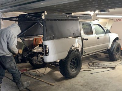

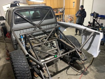

While I was away on a trip my buddy Dan and three other homies went hard for 3 days, tackling the rock sliders, roll bar, more bed cage work, some sheet metal work, and figured out how we can mount this camper. Having the roll bar come between the cab and the bedsides ended up being the perfect gap filler we needed to line up the axle to the rear fenders. I still can’t believe the boys rally’d so hard while I was away to get this project closer to the finish line, might be driving this thing in a couple week! I can’t wait!
