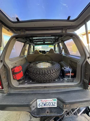

The front end camber was all fucked off because of the drop brackets and the thing only had about 1” of droop in the front once I cycled it, took some measurements and seemed like the front hoops were based off a 10” coilovers IMG_2735.webpIMG_2764.webpput some stock beam pivots back on and ordered some 10” coilovers to get this thing looking right, it does not have cut and turned beams so I put in the biggest cam tabs I could find. It still kinda sits like a Baja bug 🤣 but I will get some c&t beams soon was just trying to make it out for new years! The interior was disgusting so I ripped all the carpet and headliner out IMG_2773.webpIMG_2772.webpmade some seat brackets on the factory sliders IMG_2787.webpIMG_2794.webpMounted the battery cause it was just chilling in the back IMG_2788.webpgot some cool parts from Ryan @cookcraft ! IMG_2790.webpNew wheels and tires IMG_2792.webpIMG_2796.webpgot the new shocks in and cycled, it’s not perfect, I could gain another 1” of up travel if I move the mounts but I will eventually do the cookcraft shock hoops with the c&t beams and she’ll be dialed! IMG_2843.webpIMG_2847.webpFancy shock shaft guards I had on the ranger too 💅🏻IMG_2854.webpIMG_2853.webpthing is already looking so much better! IMG_2865.webpStill sitting too high in the rear with the original setup that it came with.

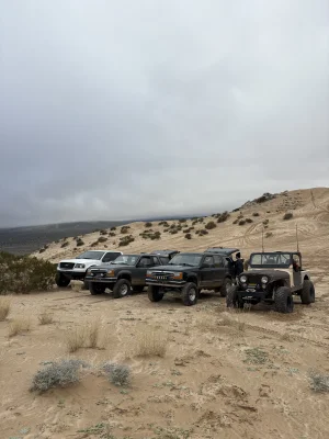

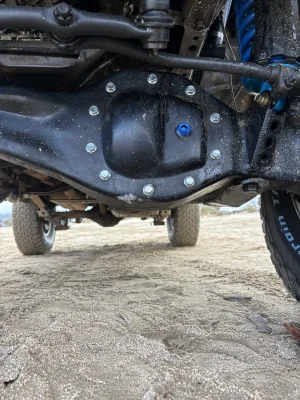

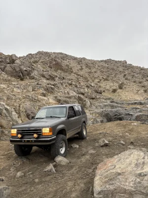

IMG_3002.webpIMG_1079.webpFirst impressions of the expo were really good thing parties! It’s super butter over all the small chatter bumps and small to medium sized whoops. I did have to take out my spare because these used G50s have seen better days (I need to get them re arched) besides that things a hoot! Also need to get my 4x4 working consistently so I don’t get stuck again 🤣IMG_3018.webpIMG_3019.webpanother thing I added to the list was a front diff guard, this thing has like no ground clearance smacked it good once and scared myself but she was all good IMG_3013.webpIMG_3016.webpIMG_3025.webpdoing some more 4x4 stuff 🤓overall I’m stoked on this thing, can’t wait to keep adding things and most of all more dirt miles!
