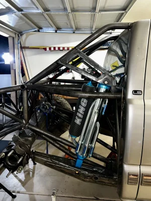

Luxo Preunner build

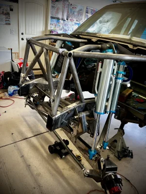

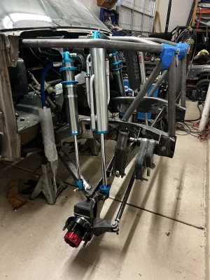

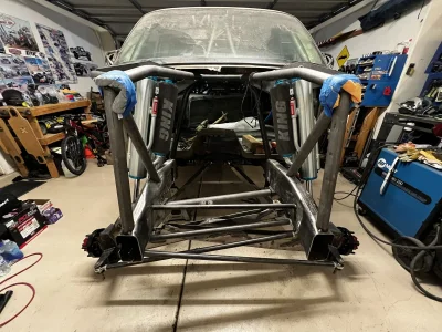

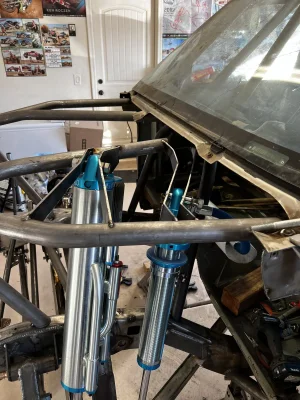

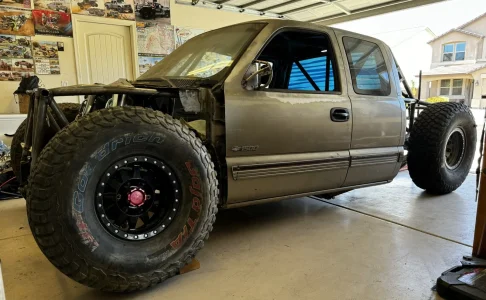

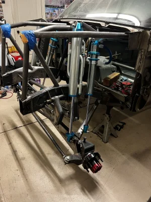

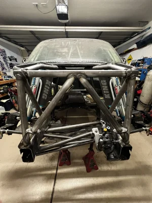

Looks awesome. Crazy how close all the tie rods come to hitting eachother at full bump and lock to lock.

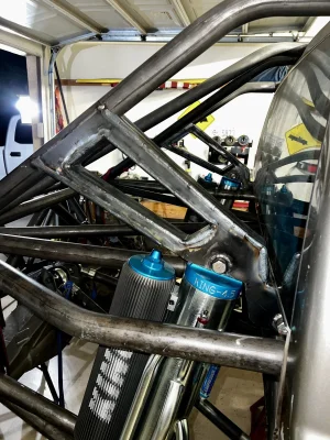

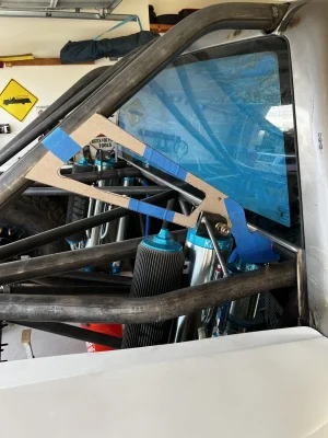

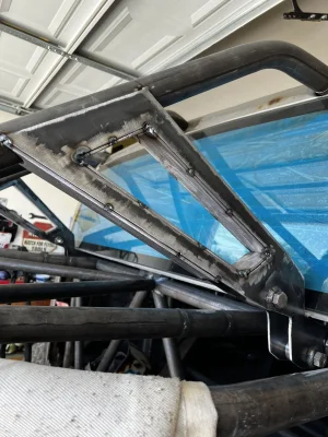

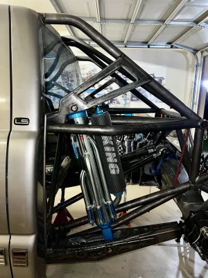

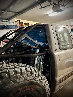

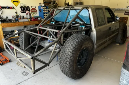

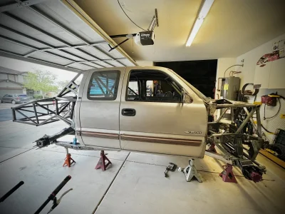

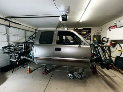

Also looks like you left enough room to remove the back window, if so good job, if not i'd figure that out now worse case it breaks
So the front I bumped a little higher than the kit is designed for but all clears. It does all get tight but all cycles great.

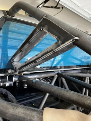

And for the rear I did leave enough room to get the window out. It’s also close but made sure I didnt mess up because it will get a new one when the truck is done. Before I fully weld the towers to the truck I’m going to pull the rear window to double check tho.
Yeah, lexan rear window is always an option, but I would rather have glass when possible.
Looks awesome.
