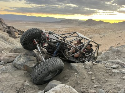

Photo of my old bronco just for kicks, with solo parts. I Should’ve kept it.

Very nice looking cage and tie in plates for the b pillar
