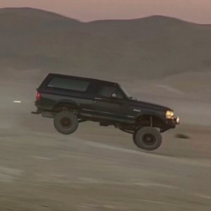

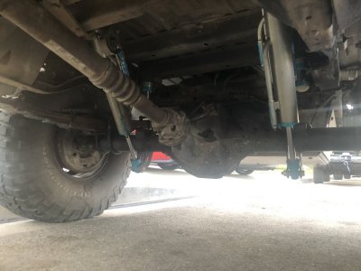

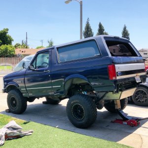

After that trip I installed the front suspension and went out to more trips and in the photo you can see the truck did not cycle right because the down travel was non existent pretty much
After I bent the axle I redid all shock mount and reinforced all four making sure it cycled correctly and called and bothered every bronco shop from solo, desolate and called Mike from FactoryBS I don’t know how many time on the weekend to help with getting the geometry right and understanding how to get it to cycle to get pinion angle and shock location.

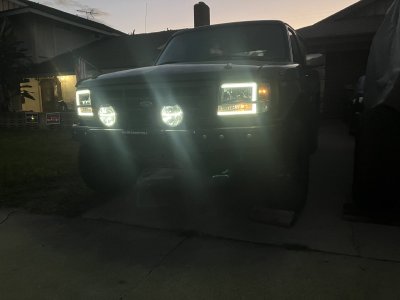

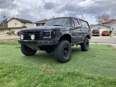

After spending some time on offer up I also found a set of front fenders that are way to big but couldn’t pass up so I traded some parts and got the rear bedsides from my wife for my birthday and had installed everything in about two weekends and took the truck to paint since I hated the three colors of paint the truck now had and found a 50% off deal at Maaco which for a desert truck is perfect cheap and don’t have to worry about scratching it so I painted it Leadfoot grey for $1600 and used steel-it on the camper shell to give it a matte black look

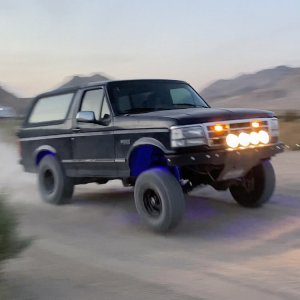

Is it just me or did your bump stops disappear in that video?
The video was before I had the bumpstops didn’t think I needed them but was wrong bent my front shock mounts after a few trips and installed the bumpstops and put new mounts

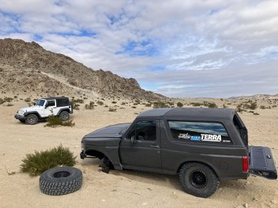

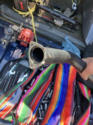

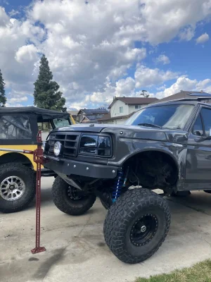

So I had a last minute idea to go to Johnson valley and while out there found a weak pint in the truck the lug nuts came loose and lost a wheel luckily at low speed and we were able to trail fix it and get to a shop to get it fixed right ruined a wheel but had a spare so all is good luckily Cameron Steee and the team Alsup Racing was there and let us use a jack and impact since we were trying a scissor jack off a rubicon that couldn’t lift the corner. I had a GoPro filming that corner and I have a clip of one of the hard hits that made me realize some issues on where my bump stop is and when the whee started to wobble due to the lugs getting loose but like an idiot I did not delete old footage and the video stopped like 1-2 minutes before the wheel fell off.

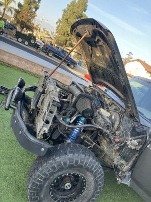

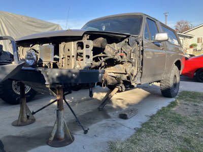

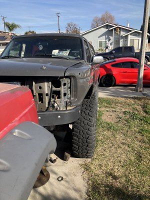

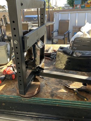

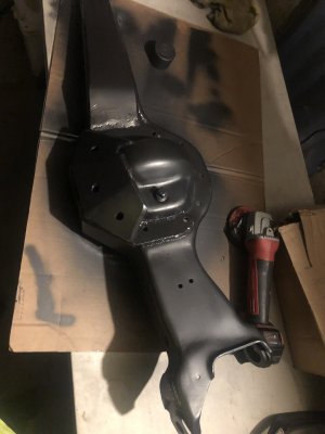

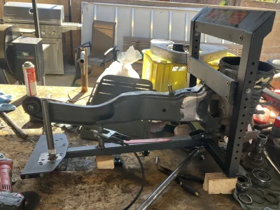

Truck is starting its front end tear down and rebuild also got myself a little cam to throw in while the truck is apart plan is plating the radius arms and extending the beams along with new bushings, heims and bolts also going to install a new pivot that I’ve had and never installed aswell as new mounting for the fiberglass also looking for a set of heads to help

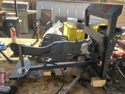

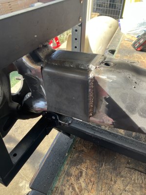

Past couple of days getting the beams extended which has been quite the job almost done just need to add extra plating and get the radius arms straight and plated and the suspension goes back in and it’s onto steering

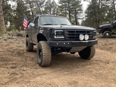

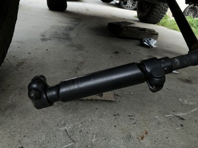

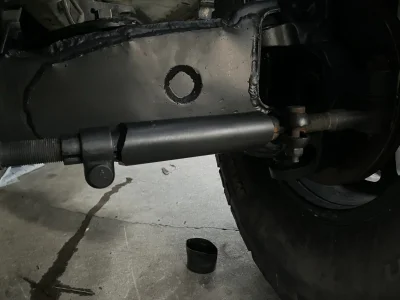

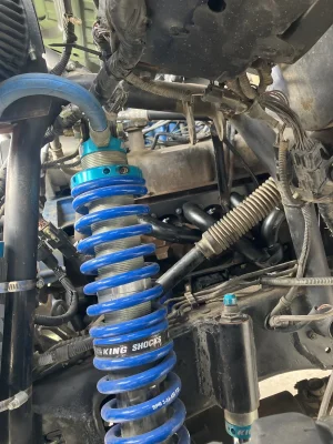

I finally got the whole truck back together just need an alignment and also need to get the right spring rate but for now it’ll do. Put in the newer style headlights with drls and they look good with the paint had to rework the mounting for the fiberglass but it all worked out until I jacked up the rear and found my driver axle had about 1/2” of side to side movement so time to pop open the rear with some new bearings and c-clips

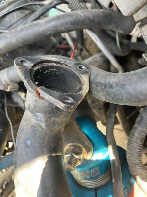

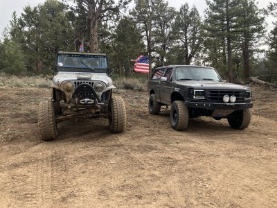

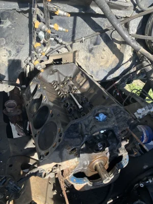

Took a trip up to big bear for a little get away and decided might as well take the bronco since my brother had my dads CJ up there for a camping trip and we met up with him for the day until the wife got to cold but truck ran good decided that it was finally time to get the motor opened up as soon as I got home though and found some issues with my engine cage nothing i did but a easy fix when the motor is all finished up looking to get the heads rebuilt and ready for the cam I have. Kind of looking around for shops to handle the heads but don’t know any so any suggestions would be appreciated. Also might do a smog delete but keep the visible stuff there to pass smog
