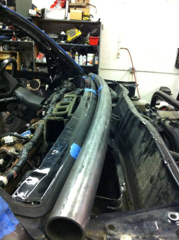

Anyone here using the Harbor Freight tube roller? Yay or Nay? It's not something I would use a lot but figured it would be handy to have around.
Solid info. Got any pictures?If you get a HF roller, the first thing to do is make yourself a larger wheel for more leverage, then add the swag offroad extended arms and dies. I ground out the factory dies to fit tubing but even then it ovals the tubing a bit and makes notches a little more difficult but we built a cage in my dads 66 F-100 that has all the roof and dash tubes radiused, it works well with a larger wheel
