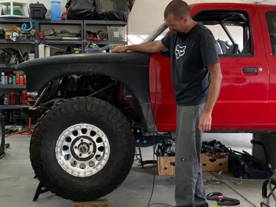

On other news about the truck... I bought some 37" General's for it. Came off of Casey Benito (dirtco) Truck. 4 are new and 4 are slightly used. Pretty stoked on them and the price I was able to get them for.

I had dropped out a mounted 37 on my way out to the clean up a few weeks back... 37's are BIGGGG

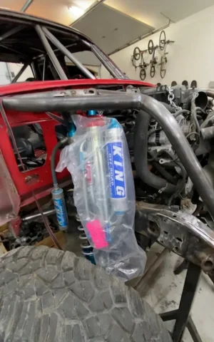

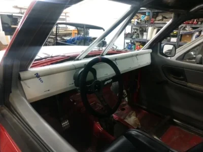

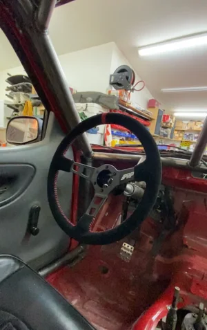

Steering is in place, peddles are all mounted up. Shock tabs should be in their final resting place. More stuff to mount but there has been A LOT of work done so far. Thanks dude.

I actually was just borrowing Brian's Seat to test how a 3rd seat would look/feel.

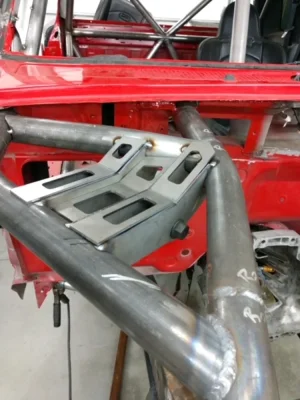

I'll text you some pictures of how I made the 3rd seat mount on the Turtle 2.0. Pretty simple design that bolts in to the factory seat belt mounts and then two 1/2" rivnuts I put into the floor. I used rivnuts since it has a sub frame that would make it super hard to get a wrench on.

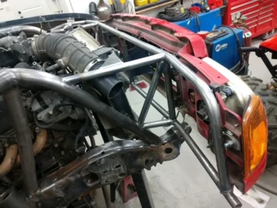

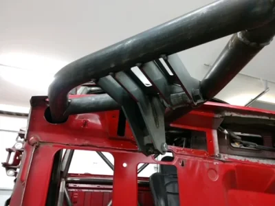

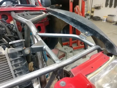

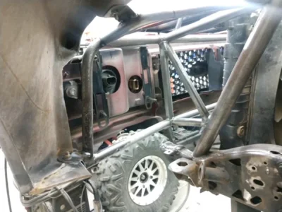

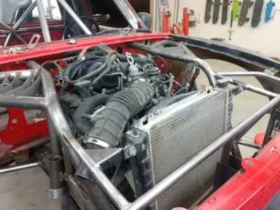

Luckily the cab is basically sealed and will have the windshield taped down for now. Hood and fenders are on as well to mostly cover the engine cage fab.
Engine still needs to come out so I'll be giving her a solid WD40 whip down and it'll have the car cover on it.
Not sure If i want to throw down the big bucks on any steel it yet for the engine cage.
I'm just not sure what tabs and additional welding is going to be involved yet.
