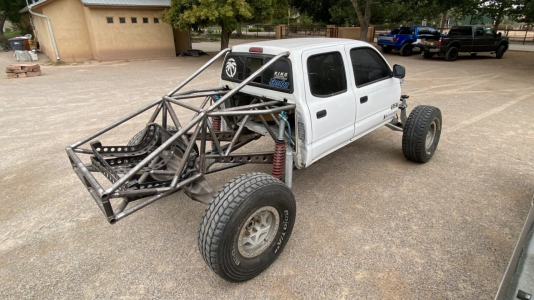

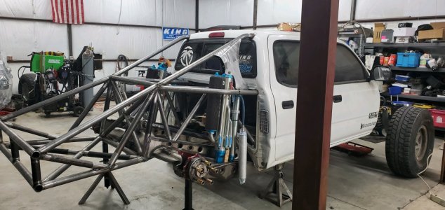

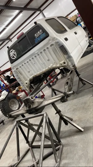

Ever take a perfectly built and running truck, and cut it up to never make drive again? Then you're in the right place...
OG Tacoma world build thread from the very start
OG Build Thread
How the truck currently sits
How it started

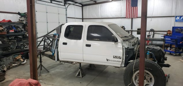

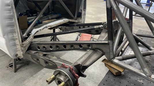

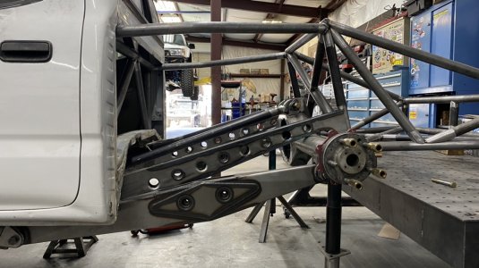

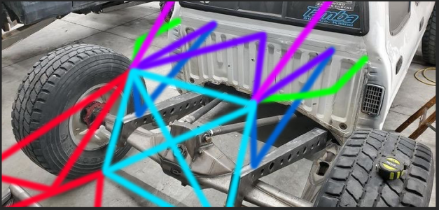

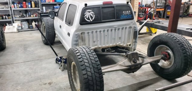

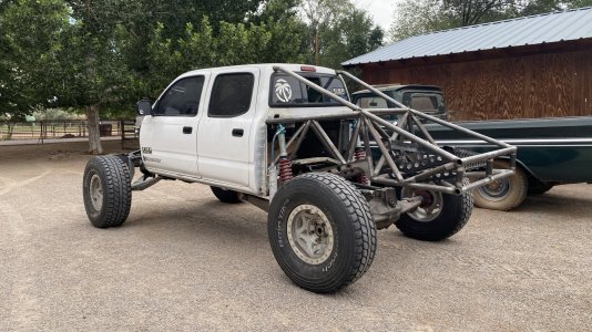

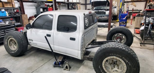

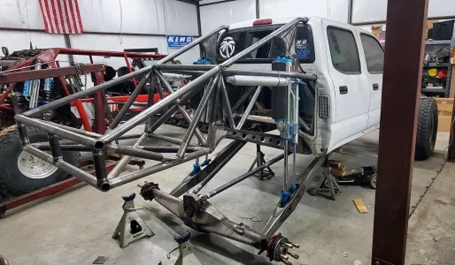

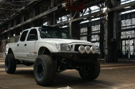

Started life with a camburg bolt on 3.5 kit, coilovers/bypasses, J59s, 12" rear bypasses, 35s, clean....

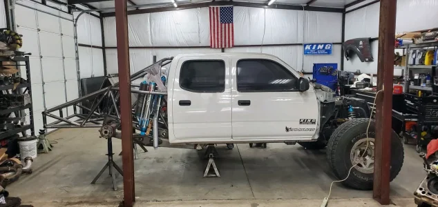

Then it snow balled to a TT Race kit, links for a double cab, and a cage.

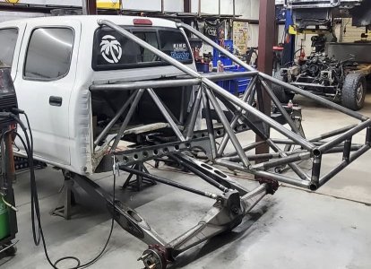

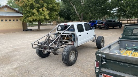

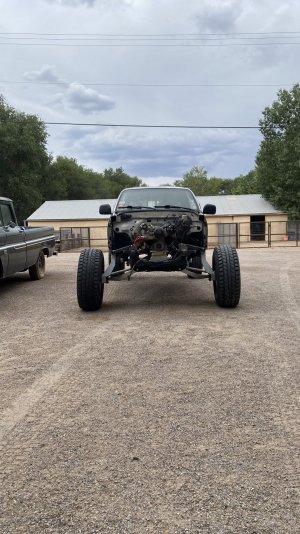

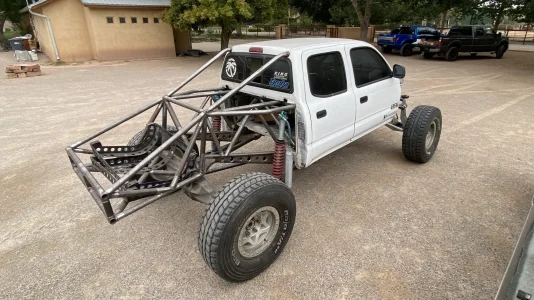

Now its 100% snowballed to a full backhalf, custom race kit, LS, gutted, etc...
In-between now and when I first chopped the front end off 6 years go, its done through multiple sets of parts collections and each time getting bigger and bigger.

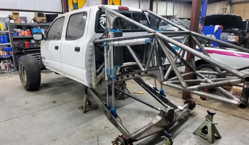

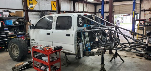

Shortlist of what the plan from here on is

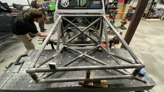

2" DOM Cage built by TT Motorsports

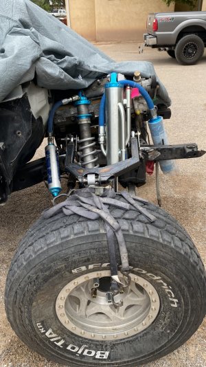

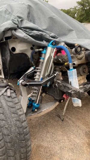

Front End
Custom TT Motorsports Race Kit
King 2.5x12" Race Series Coilovers
King Kong 4.0x12" 3 Tube Bypasses
King 2.5x2.5" Bumps
Camburg 2.25 5x5.5 5/8 Front Hubs

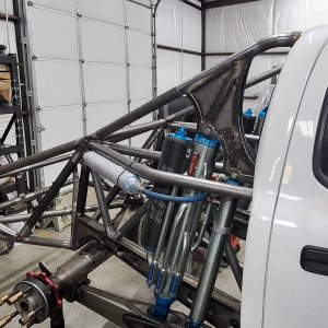

Rear
Camburg 48" Links
Camburg 4 Link Fabbed Housing
Camburg 2.25 5x5.5 5/8 Hubs
Camburg 40 Spline Axles
9" Spool
King 2.5x16" Race Series Coilovers
King Kong 4.0x18" 7 Tube Finned TT Spec Bypasses
King 2.5x4" Bumps
CAD and CNC Cut Backhalf
Engine will be a morruzi special 6.0
TH400
PRP Alpha Q Seats
37s...... maybe going 40s
Walker Evans
etc.

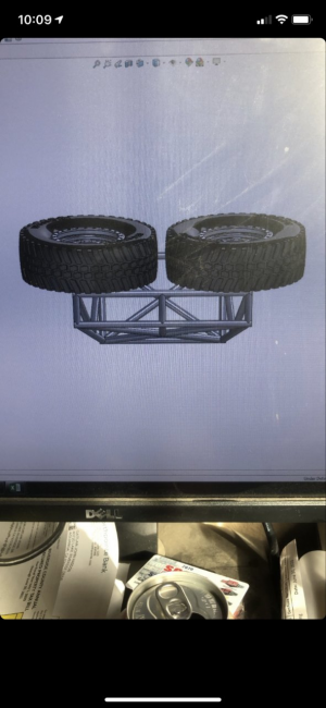

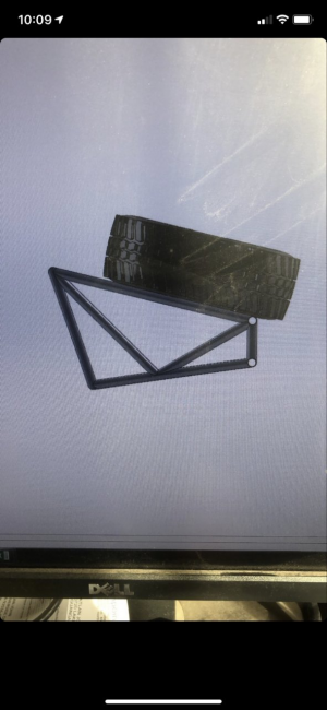

Truck from here on will be designed as a truggy and for now wont run any glass, but will be built with mounting points in mind for body assemblies to be taken on and off.
Picture dump of the most recent over the last 2 years.
