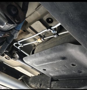

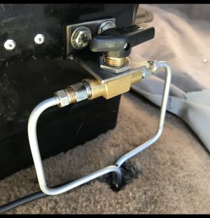

I used a manual line lock on my ranger when I went from drum to disk. i rerouted the brake line up into the cab and made a bracket that bolted to the center console. Worked perfect and held for weeks.
Do you have any pictures? I guess, I can't picture what you're describing.

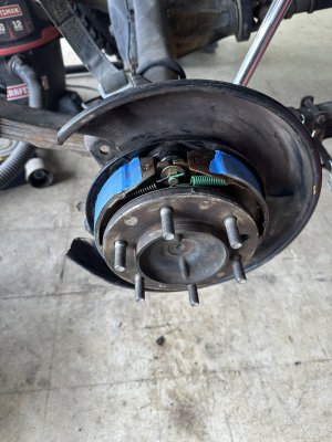

IMG_1245.webpIMG_1180.webpIMG_1163.webpThe 1st gen Sequoia rear axles is an “8.4” tundra width and uses disc brakes with an internal drum parking/emergency brake setup. The bummer is the housing ends are different from every other 8.4 Toyota.
You’re saying it would hold the truck parked for weeks? We’re doing a line lock on my truck so I have somewhat of a parking brake so that’s good to hear
View attachment 21784View attachment 21785View attachment 21786The 1st gen Sequoia rear axles is an “8.4” tundra width and uses disc brakes with an internal drum parking/emergency brake setup. The bummer is the housing ends are different from every other 8.4 Toyota.
Yeah it would hold for weeks, more than 2 weeks I’d probably check it if the truck was stored somewhere on a slight incline. It worked great on the trail and day to day driving having a manual trans.
