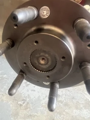

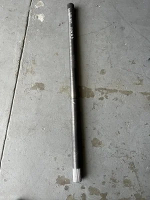

So I wanted to start this to warn people and help our off-road community. Here’s my story since now I’ve just about completed my truck . I purchased a full floater through camburg… I bought a housing,hubs, brakes, diff skid, axles, and a hand brake from them. Said and done I spent pretty close to 8k with them….I had them weld the snouts in the housing and set up the brake lines. I assembled my own hubs crush sleeves exc… I’m very disappointed in the company. When I assembled my rear end I installed one axle in and everything was great it went right in and sat 1/8 below the drive plate, on my passenger side the axle sat 1.25 inches outside of the drive plate because the axles where not turned down below the splines allowing it to go into the spool all the way. I called camburg and told them what was going on and sent them pictures…. They admitted that my axles may have been made wrong.. there solution was to flip my axle over and install the drive plate side into the spool and the longer splines into the drive plate and just adjust it out to the right size . Sure it works I’ll be able to drive my truck but why not take ownership in your company and make people happy. Just so unfortunate to see a great company make bad decisions. On one note Carlos over at camburg did go out of his way to help me so I do praise him for that.

Someone I know just had the same issue. The conclusion we came to was the company that made the axles use a flanged axle and just splined the end that had a flange. To fix the issue I turned down the side and that resolved the issue. He did contact the company that made the axle and they just blew him off. Personally I would like to have full spline engagement on the spool side. If u know someone that has a big enough lathe have them turn it down for ya.
Zwiley13
Apr 13, 2022
116
Ventura county
Yeah I contacted gear works and they said that it should be fine but it’s not right I just ran it for now till I get some stuff figured out

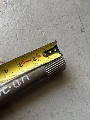

They emailed me saying that there could be something wrong with my axles. Basically the axle was not turned down after the splines to allow the axle to go into the spool fully. The drive plate side was turned down that’s why they told me to flip the axle over and put it in that way.

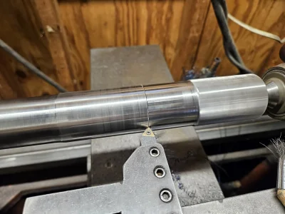

I completely agree customer service is everything. The company that the guy dealt with was pretty rude to him and made him feel like he didn't know what he was doing and that it couldn't be wrong and he wasn't assembling it correctly. I even stopped by to make sure they weren't in the wrong. They stated they would call him back and never contacted him again. He didn't press the issue no should he have too. He did order them through ORW about 8 years ago but had just pulled them out of the brand new box and they didn't fit. he could have tried to resch out to orw but went directly to the company. One axle was correct. But as stated the other one was not made correctly. Even if it was 8 years ago they should have made it right. a bad part is a bad part. They messed up and now he had a 500 axle that was a paper weight. Idk why they couldn't make it right. It was a fairly simple fix. It could have been he was just talking to the wrong guy who is giving the company a bad reputation. I personally appreciate companies that take the time for their customers. I will return again and again. One bad experience and I will take my money elsewhere where it is appreciated. This industry is too small and one bad deal can make a big differencein one's business.
juberafab
Apr 13, 2022
47
I removed about. 125 to allow it too clear. Roy ODR has the same issue from the same company so not a one time occurrence. I would recommend PPM or TCS if u need axles.

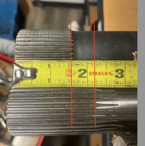

This thread was just brought to my attention so sorry if Im late to respond.
Just to clear things up, Camburg doesn't make axle shafts, we build the housings, build hubs and can get axle shafts made for your Camburg housing.
When ordering a rear end through Camburg, we offer several diff options when it comes to axle shafts all at different price points. Price points vary on material & processes. some are cheaper to make than others.
We offer an HT alloy shaft which is the one in question. It's on the more budget side of the axles we can provide.
Because of that, the company we get them from cuts down their stock, they spline it, we have them tap the ends for us to make minor adjustments and send them out the door. They're not so much concerned with it being tapered after the splines so you can run it through a drive plate or fully engage the longer spline into the center section.
We also offer an axle shaft that is a much nicer piece that is tapered down after the splines, they're polished and look awesome. they're also twice the cost of an HT alloy axle & takes a few weeks while longer to get because it goes through a diff process.
We (Zack & I) talked on the phone a few times and emailed back and forth several other times.. We went over the different axle options and the shorter spline side going into the center section being ok. I don't remember telling you that they were in fact made wrong, or that I wouldn't give you an option for a different axle manufacture.
I've attached a picture for reference on how much spline engagement we are talking about between your current axles (short side) and a new set of TCS axles (long side)
If you want to swap them, I would gladly order you a new set of axles for the difference in cost, you told me you wanted to get it running by the weekend. but you'd have to give me the current axles back new like they are now. This is still an option if you didn't go run the axles this weekend.
