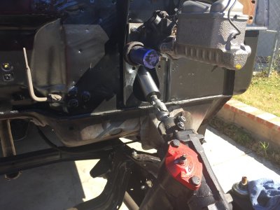

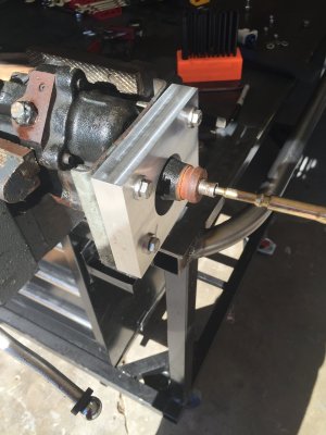

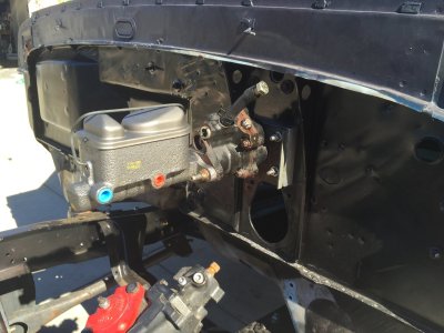

I put a hydro boost in my F100. I did use an early 2000’s f450-ish unit I got from EBay. Picked up a dual return Saginaw p/s pump (I read some posts about modifying a single return, but this was easier). Hoses are mostly straight forward.
One of the things I did have to do, was make a spacer to go between it and the firewall to bring the brake pedal down some. Milled it out of some 1” aluminum. My pedal was still too high so I pie cut my pedal and bent it down and welded it.
Sorry I don’t have any p/n’s
