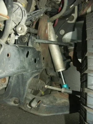

For reference my Sporttrac, I think this was roughly circa 2004 or 2005. FYI this is a 2wd similar to the Edge with torsion bars. 2.5'' King shocks all around, 35'' tires and a boat load of fun.
I have done exactly this, stock arms, good shock. Take it out and learn, see what works and what doesn't. By just adding a proper damper you will see things in a whole new light.
