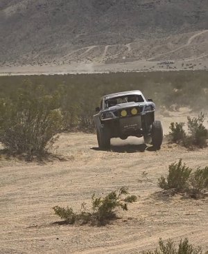

Went out to do alittle more shock tuning after changing some valving. Truck feels more planted and its faster through bigger bumps. Still getting used to how the truck reacts and drive but it's fun and getting faster.

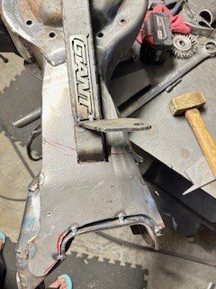

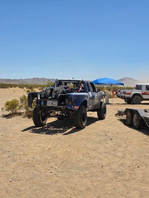

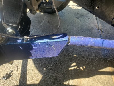

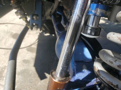

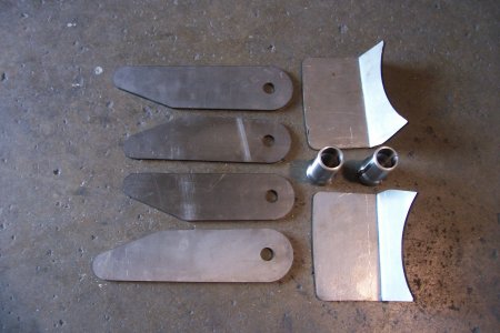

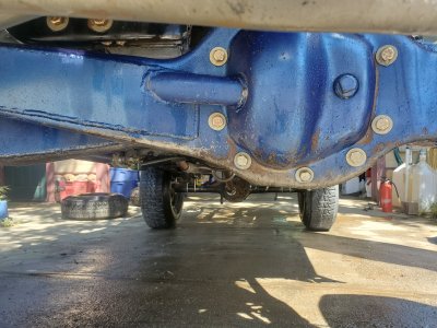

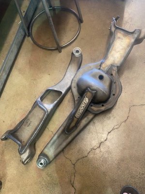

Finally got the truck out to a race. Was having a blast and it was working pretty good. Right up until I smoked a big rock with the driver side beam halfway through the first lap. Pulled into the pits and realized we had 2" of up travel before the beam was smashing into the passenger side mount and engine cross member. So now I think its equal length beam time.

Time for some 2 tube or fully plated radius arms. That bent right where the stress riser was created by the front boxed portion ending
