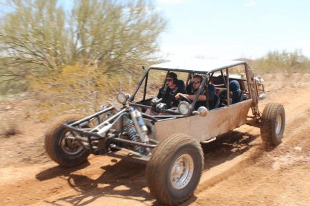

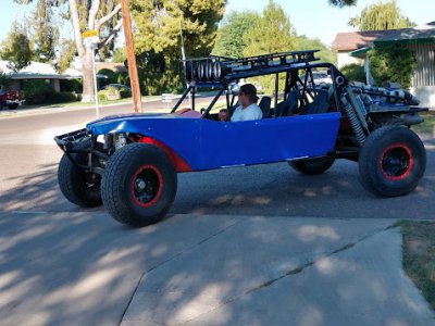

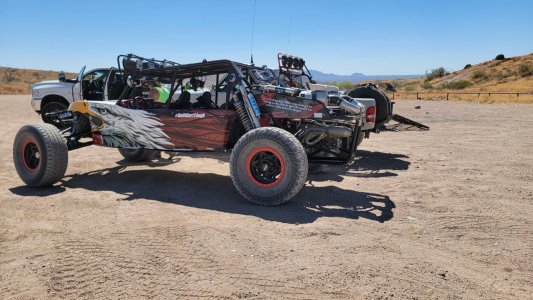

papa has brought this up before a couple times, but he did again this mornign and i thought id ask everyone on here about it/maybe start a thread about itt? not sure about that though considering almost no one on here drives buggies. hah
buuuuuuuuuuut...........

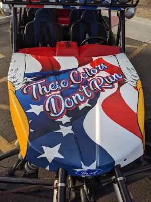

we want to put a windshield on the buggy. thought about maybe doing a plexiglass one but, in all reality...... i mean who drives their trucks hard offroad and ever actually SHATTERS their windshield..........? so fuck it. maybe well just build a little square tube/rebar/small round tube frame to "sandwhich" the glass in? then bolt the frame to the front a-frame part????
suggestions??
maybe i will start a completely separate thread since im sure most everyone skims by this thread thinking im just talkin smack about someone's mother or something............
Don't most of the buggy manufacturers that do windshields now just run a flat hot rod windshield? AKA go to a hot rod shop that can cut auto glass to your size, build a frame to sandwhich and bolt on to the buggy and you're in business.
Flat automotive safety glass window in a flat aluminum sheet cut to 1/4" oversize was the standard way for a long time. This is still a quick and cheap way to get it done or mass produce as in UTVs. They kind of suck though as the glare flashes across the whole windshield at once and is blinding when it happens. The glass also flexes through bumps which distorts your vision and dust clings to it easier. A curved windshield solves most of these problems but takes some aluminum working skills which drives up fab time and cost. Early Toyota pickup windshield are popular as they are some of the shortest and narrowest available, but still need to be cut down. Rubber gaskets are always used cause it holds it in place and you never are going to remove it anyways. Glamis dunes forum is still alive and mostly active with some good info on the topic. No idea who could fab one near you though
