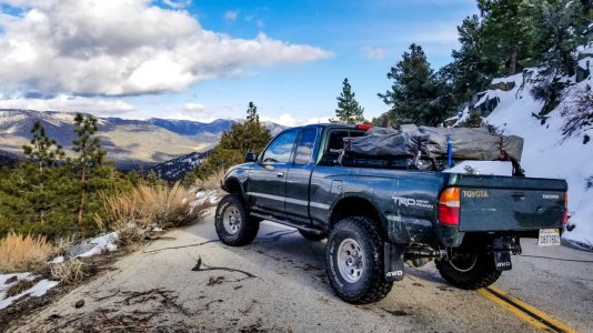

Frank, my 1999 Tacoma (which this thread is eventually going to be about, I promise):

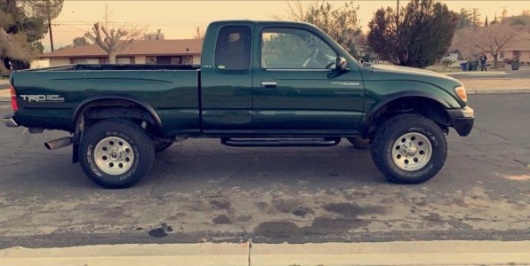

After some lowballing on OfferUp I scored this pretty fresh 1999 Toyota Tacoma TRD w/150k miles and manual transmission for only $5500 ($22k in today's money)! It was the color I wanted and everything. On the way home my girlfriend (now wife) called it Frank for some reason and the name stuck.
Part of me now wishes I just kept it as-is, but we all know that was never going to happen, so on to the build!
Things started off pretty basic with new OME leaf springs, used Fox 2.0 Emulsion coilovers, and used Total Chaos upper control arms:

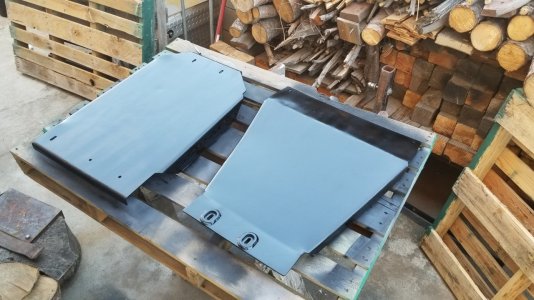

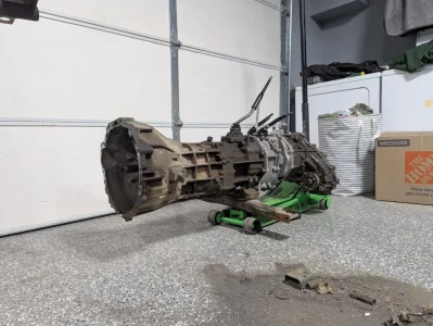

Used Savage Offroad transmission skid plates paired with a new a Trail Gear engine skid plate:

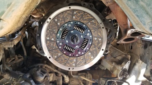

New Marlin Crawler clutch:

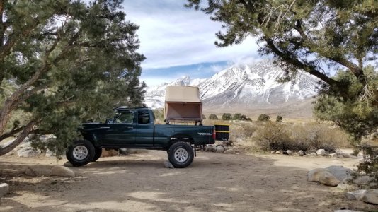

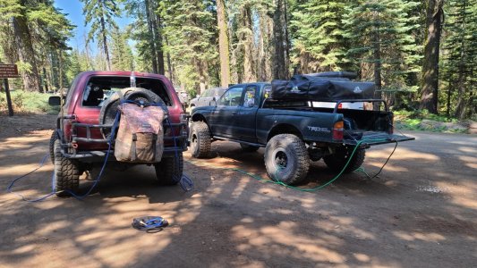

As many camping trips as I could squeeze into my schedule:

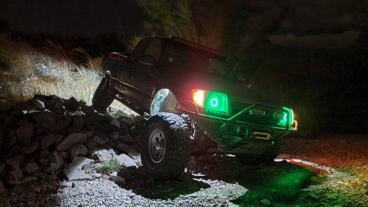

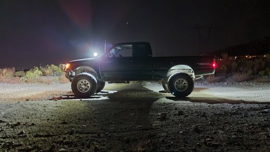

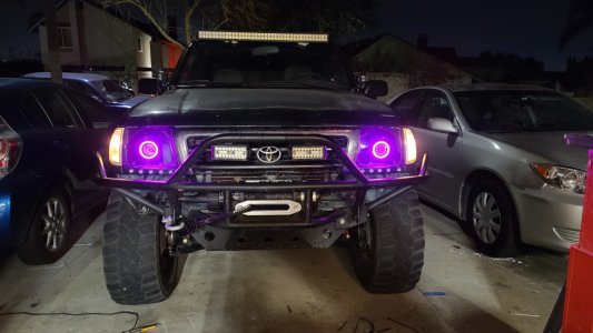

My light game was pretty bad so I went ahead and decked the ol guy out with only the highest quality lights Amazon had to offer:
I also made some DIY retrofits which I eventually threw away as I was tired of blinding anyone who came around the corner. They were cool when I had them but factory headlights with aftermarket lights to use when offroading is the way to do it in my opinion:

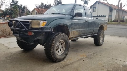

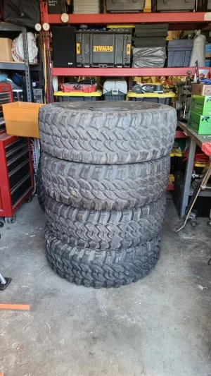

When browsing OfferUp one night I came across a set of essentially new ProComp 37's for $800. I jumped on them immediately:
I got myself a 1996 Civic to daily and parked the truck at my grandparents so I could start the fitment of 37's:

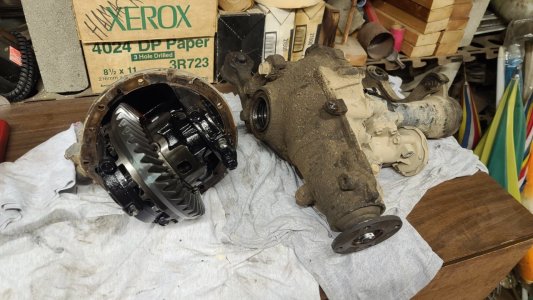

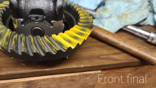

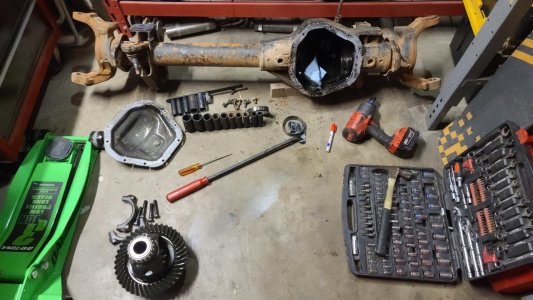

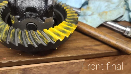

I was doing the regear myself and landed on 4.88's which matched the factory ratio. I also installed a spartan locker in the front which was the worst idea I ever had as it caused it to fight me too much in the steering. This was my 1st time ever doing gears and I'm happy to say they lasted for as long as I ran them:

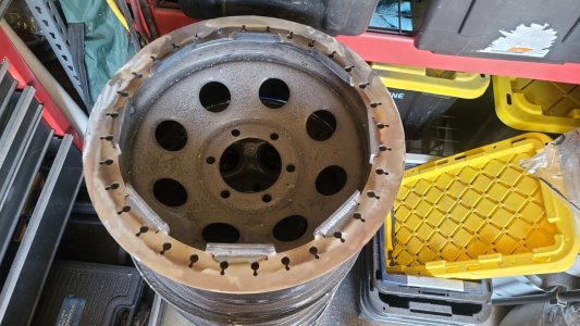

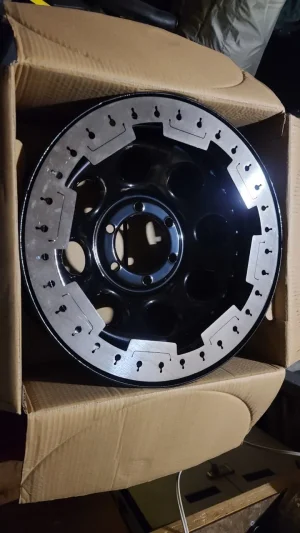

Next up: beadlocks. I decided to go with one of the DIY WIY kits which came out nice but I didn't keep them for long as they were impossible to balance:

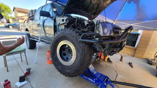

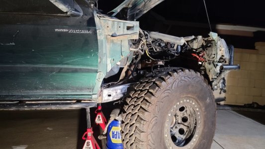

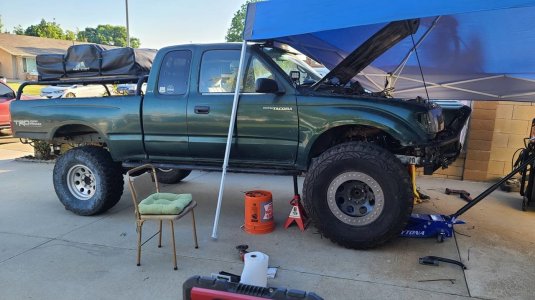

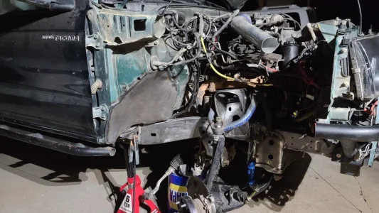

And now on to the cutting! I drove the truck from my grandparents to my buddies house so we could start the long process of tubbing and tucking the 37's. It took us 2 full weeks and we had a deadline to meet as we were planning on attending the Norcal x Socal event. I'll let the images speak for themselves in how much needed to be removed to fit these things properly:

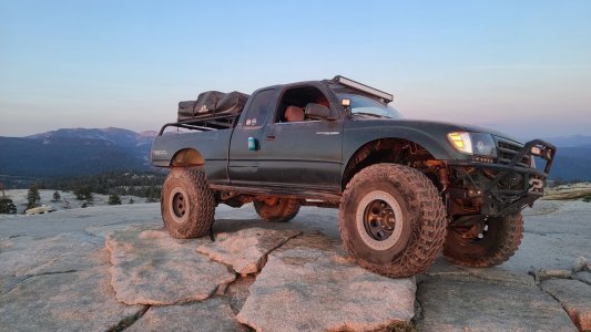

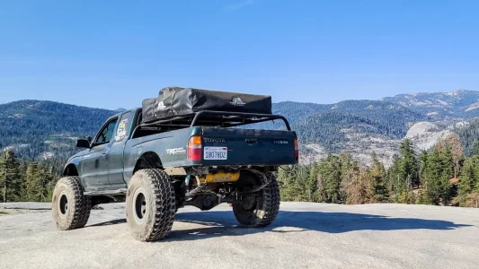

It was quite a night when I got to drive this thing home on 37's!

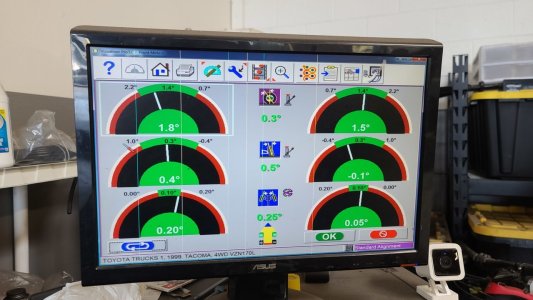

We were also in the process of developing our now popular alignment kits so I was stoked to report the truck was able to be aligned perfectly!
And yes, we made it on the trip and yes, I hit all the bad lines and had a good time. Despite the DIY beadlocks shaking all around it was a huge success and a ton of fun, but I knew the IFS had limited life with these tires:

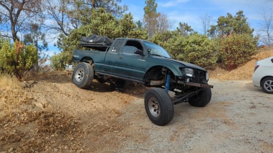

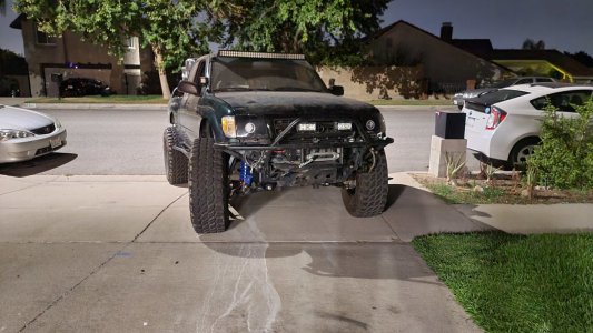

I daily drove the thing on 37's for the better part of a year just enjoying it and having as much fun as I could but the writing was on the walls for all those poor ball joints. During that time I started collecting SAS parts.

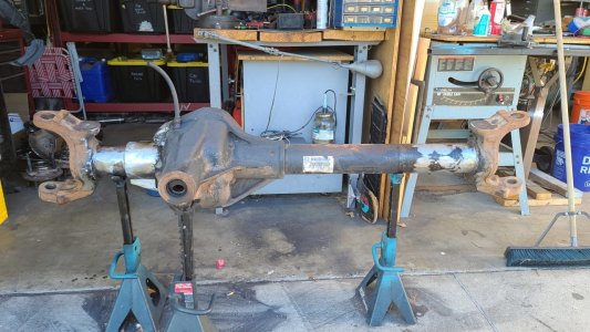

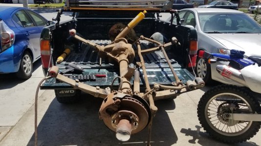

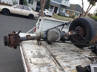

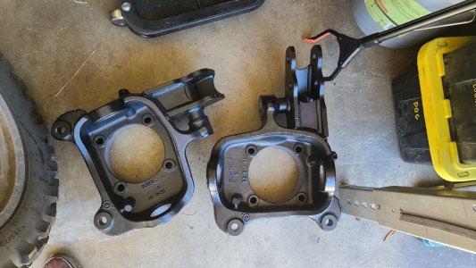

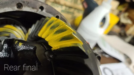

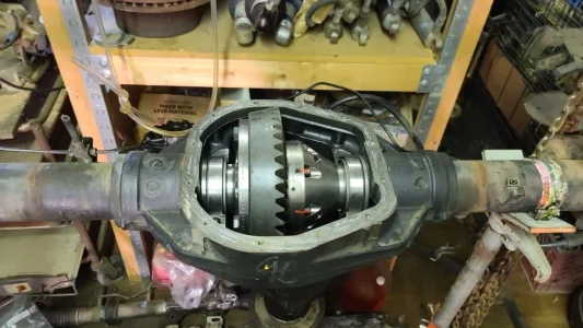

After careful consideration I sold the Dana 44 and ended up with a Dana 60 from a F250. I went to town dismantling and chopping off parts from the Dana 60 getting it ready for the 3 link I was planning on running:
I also picked up a Sterling 10.5 from an F250:

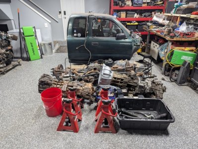

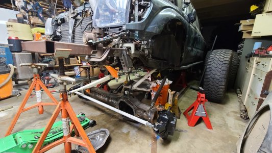

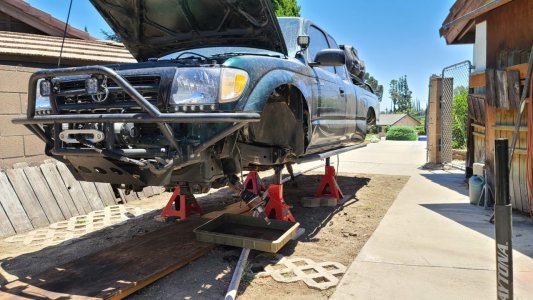

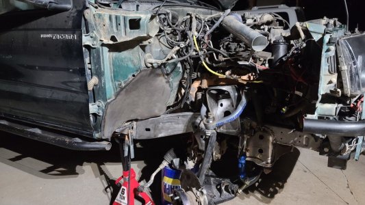

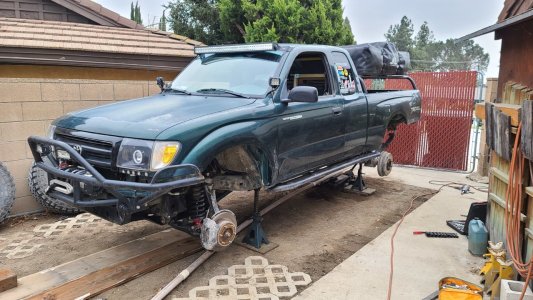

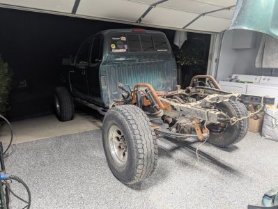

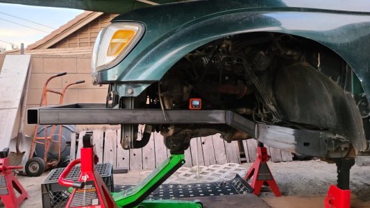

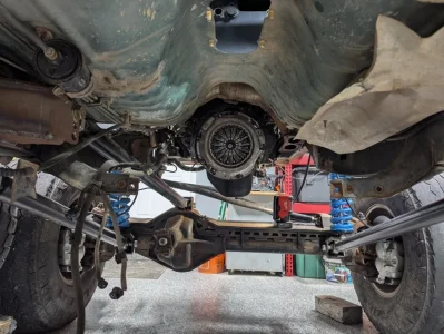

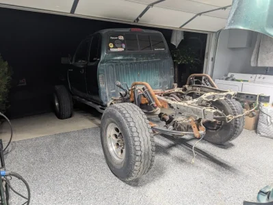

I drove the truck to my grandparents again and threw it up on jack stands and started striping everything:

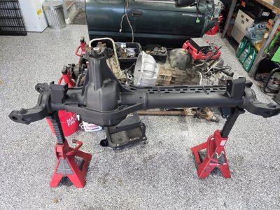

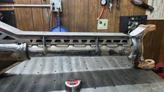

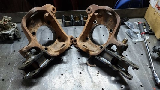

Brought the Dana 60 to my buddies to have the truss and high steer welded on:

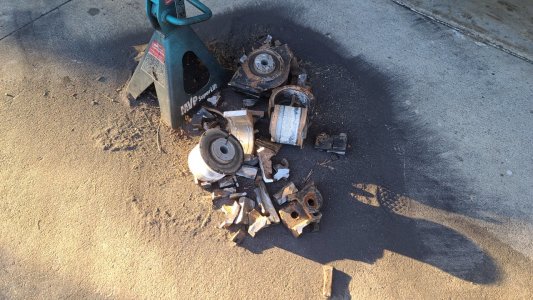

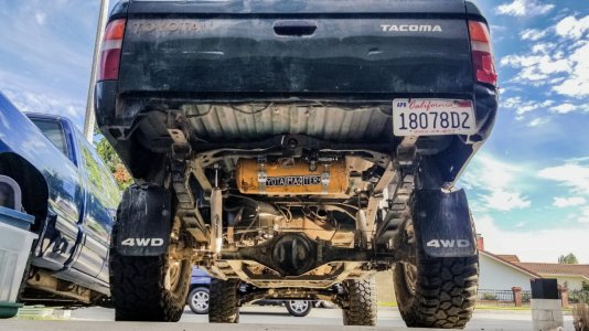

Instead of cutting off all the IFS mounting points I went ahead and chopped the frame and built a new one to start fresh with:
Got the Sterling regeared with 5.71's and threw in a Yukon Grizzly locker while I was in there:

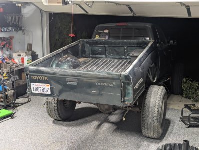

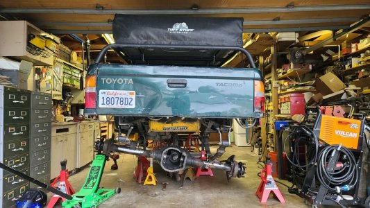

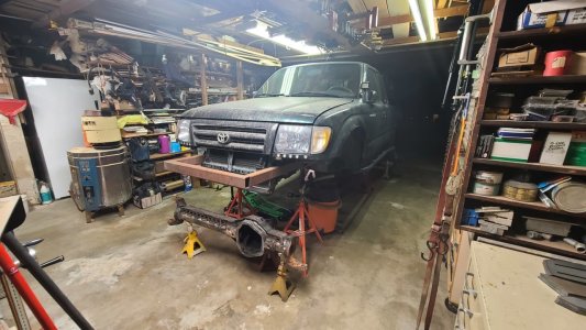

Around this time I decided I was tired of working in the dirt and moved the Taco into my grandparents garage after spending about a week cleaning it out:

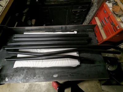

Got the rear axle mounted with some Chevy 63's. The goal is to run 14" shocks with ~5" of up and ~9" of down travel in both the front and rear:

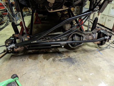

I was pretty happy with the rear so I moved on to the front 3 link. I started out making the links out of PVC pipe to get the angles and lengths figured out before I made them out of steel. They ended up needing quite a few bends to dodge the 5VZ but I was happy with the setup:

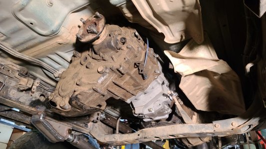

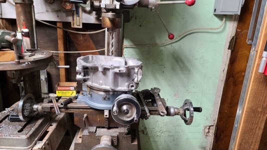

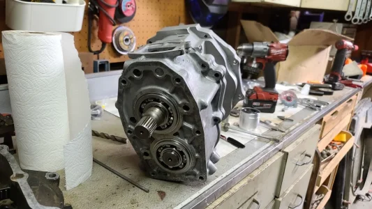

Got the Trail Gear crawl box with 4.7 gears built and installed. I had to machine the OG Toyota box a bit to fit the larger gears:

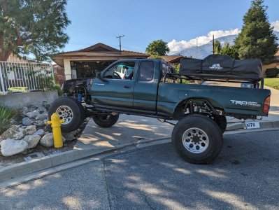

After ~1.5 years I FINALLY got the thing running and was able to take it for a little test drive. I glossed over so many details with the SAS including rear bump stops, shock mounts, steering components, braking components, radiator, front gears and lockers, you name it. You'll see why I did that in a bit. On top of that it was getting harder and harder to work at my grandparents. I moved into a shift working later in the evening so by the time I was off they were already asleep which made it hard to do anything that required noise.

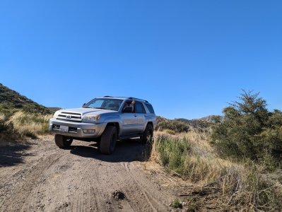

I was also missing wheeling so I sold my Honda and got the 4th Gen 4R which was taking up any free time I had to work on a personal vehicle:

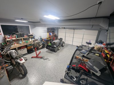

We were here for probably 6 months getting settled in, setting up the garage, and all that comes with a new house before I had time to get the Tacoma up the hill. Surprisingly, I drove it from my grandparents up the 18 without any issues, even after sitting for so long. In fact I think it drove better than the 4Runner! Due to it sitting everything was rusty, and there was so much I learned working in the shop that I wanted to apply to the Tacoma so, back to the chopping block it went!

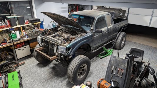

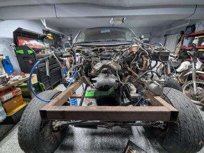

And that brings us to 2025, the restart to the SAS!! 1st things 1st, I wanted to do it right. Now with my own place and the ability to work into the night I didn't waste any time pulling it apart; and I mean completely apart:

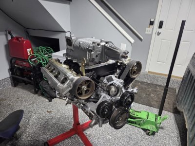

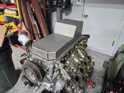

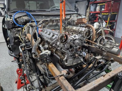

It's also the perfect time for an engine swap! I'm going with a 1UZ out of a 1997 LS400 along with a Supercharger from a 2004 Mustang Cobra:
Peep the DIY rear sump oil pan:

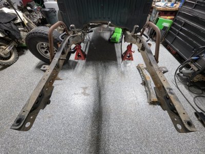

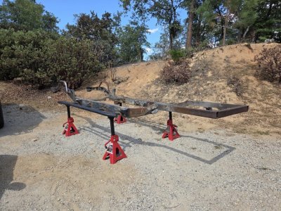

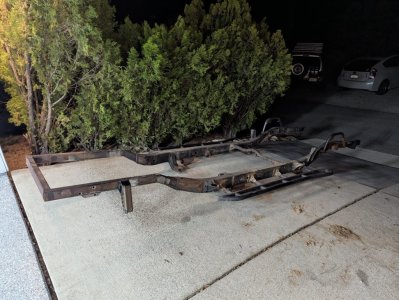

And currently the frame is sitting outside, waiting to be sand blasted and painted:

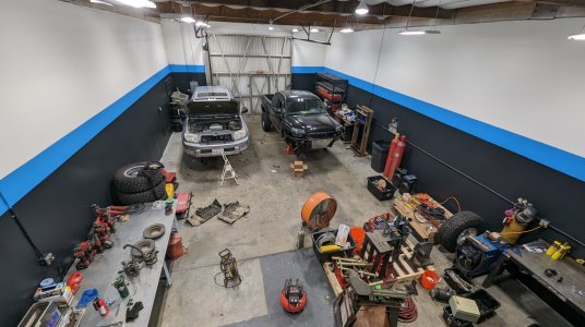

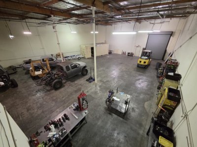

I'm still working in our shop which is now located in Pomona and in a MUCH bigger space:

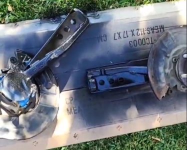

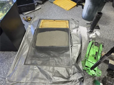

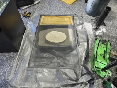

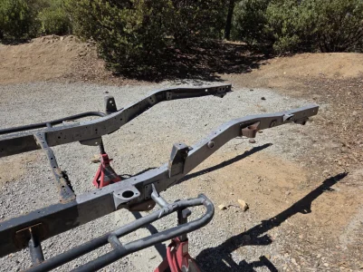

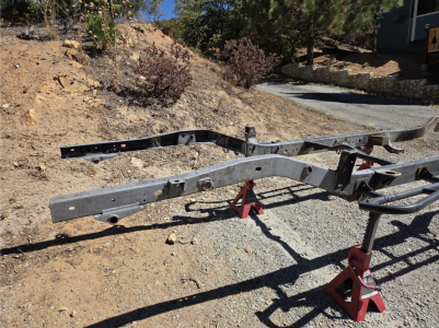

Finally got started on sand blasting the frame! I started off by filtering all my sand. Even though these are brand new bags they still have impurities in them that need to be filtered out before loading into the sand blaster. If you don't remove these you'll spend more time than you want unclogging your sand blaster. I originally had a small sifter but due to having over 200lbs of sand I needed a faster setup. I ended up finding an old screen and set it up over a bucket. Then I just poured the sand on the screen and shook it around. Then I just poured the large pieces on the bucket lid to throw out. It surprisingly worked really well and I got through all 200lbs in about 10 mins.
After I had the sand sifted it was time to get to sand blasting. Setup takes about 30 mins and getting into the mask I have is a huge pain. I was ambitious and thought I would be able to get the whole thing done in 1 day but I quickly found out this was going to be a multiple day process. Due to the amount of rust and loss of power when the air compressor runs out of pressure progress is slow but still faster and better than the DA sander. This is the progress after a full afternoon (about 2 hours of actual sand flowing) and a full tank of sand.
I also needed to stop every 15ish mins to let my mask air out and the air compressor catch back up. I have a larger 80gal tank but it still isn't quite enough to keep full pressure the whole time I'm blasting. I have an air inlet on my mask but it still fogs up. I also realized after the mask starts to get scratched and foggy I can barely see and I can only work in areas fully lit by the sun. Not pictured are also tarps I laid out so I can collect my sand to filter and reuse.
If you want to do this yourself ask yourself 2 questions:
1. Is your time worth more than your money?
2. On a scale from 1-Anakin Skywalker, how much do you hate sand?
If you can afford it, have a shop do this for you.
If you hate sand in every crevice of your body, have a shop do this for you.
I think I will go buy an EZ-UP before I continue but overall I'm happy with the progress and am gonna crank this out as quickly as I can.
