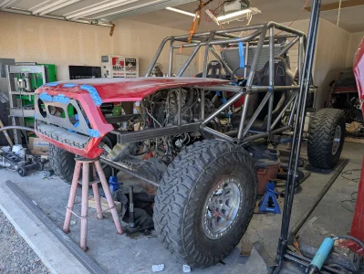

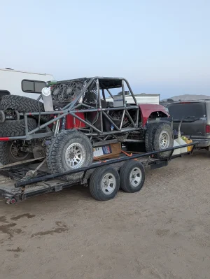

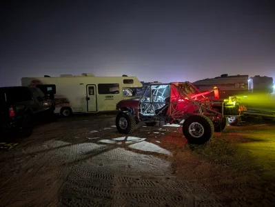

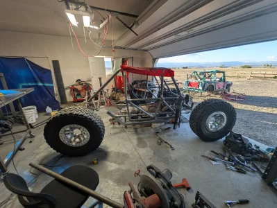

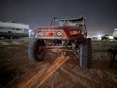

Well, here it is. The 4522 car. While built around the rules for Ultra 4, the car will see more local desert races with BOR and VORRA than ultra4 stuff. But I built to that spec in case I decided on hammers.
There's a lot of terrible tech in here. This is my first raw material to completion build. I've always just added parts to a production vehicle. I wanted to build this for a few reasons - 1: I wanted to learn the processes I needed for layout, chassis setup, weld order, and general fab. 2: been gathering pieces for my wife's truck that will shame this one, and wanted to rough draft some ideas on mine first. 3: I wanted to have zero excuses about limited by factory this, can't make this work with that, etc. If this works I want it to be my fault. If it doesn't I also want it to be my fault.
As with anything it's a compromise on what you want vs what you get. Performance here at the cost of performance there.

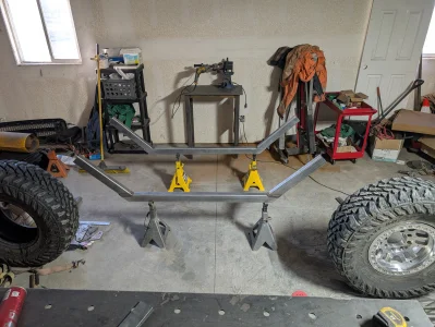

I've always been a crawler. 4low, deep gears, underpowered, and usually full body. I love ifs stuff, newer toyotas especially because I feel there's a lot of room to develop there. So I set out to build a car more geared toward go fast, but keep the rock side. So for 4500, that's live axle, lower belly, 14" shocks, and mechanical steering.

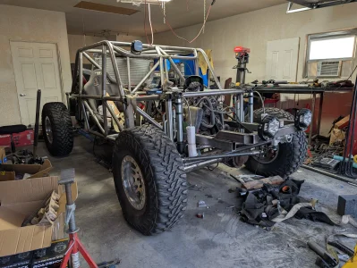

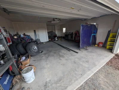

Here's where it started. My small garage being mostly empty and clean (I'm a mess, total scatter brain).
PXL_20250315_001011896.webpPXL_20250317_005444701.webpPXL_20250316_002418386.webpPXL_20250316_002411024.webp

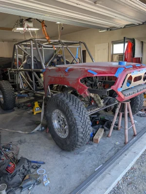

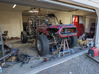

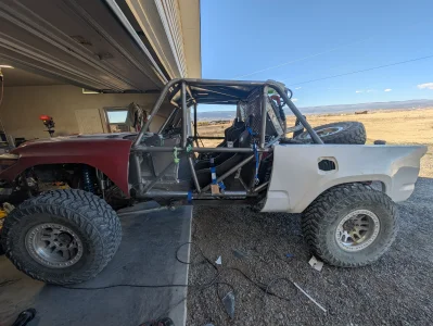

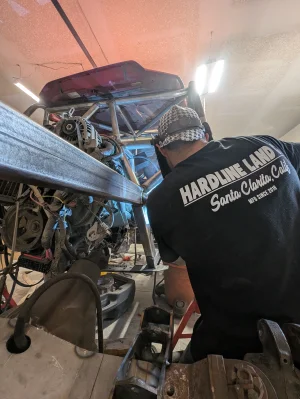

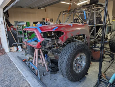

And here's the most recent shot of progress as I try and get the body all mounted up.
I'll drag this through the progress as I can.
No cad, no real plan other than some key ideas I had in my head, and some tape and parts.

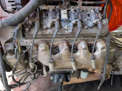

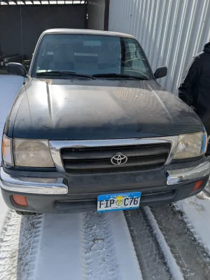

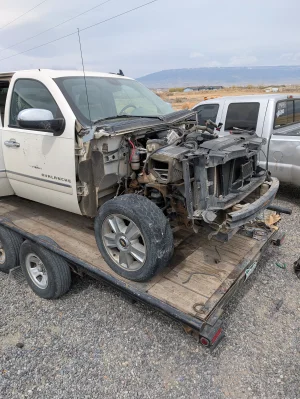

First thing first was drivetrain. Found a great donor candidate with about 120k and a bad lifter on #6. We knew we were doing can, lifters, springs, did delete, and general refresh anyway, so this wasn't a big deal. Guy sold me the "non runner" for $1600. Swapped the battery and drove it on the trailer.
These L76 are a great option for builds as the LS2 bottom end leads itself to some good power. Kept the truck intake and aluminum heads, but I'll get into more of that later.

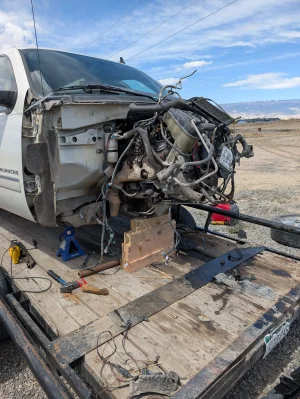

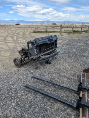

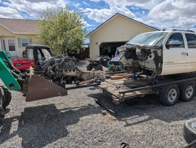

Basically cut the front of the truck apart to pull the drivetrain complete. Added some scrap into the bed before taking to metal yard where I got 500+ back. 1100 into a drivetrain isn't bad. PXL_20250423_165938524.webpPXL_20250331_184818471.webpPXL_20250421_194155624.MP.webpPXL_20250306_001323488.webpPXL_20250323_211112589.webpPXL_20250408_024515687.webpPXL_20250421_171623447.webpPXL_20250421_184939798.webpPXL_20250421_184933229.webpPXL_20250423_170925873.webp

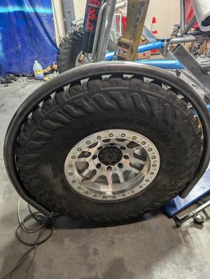

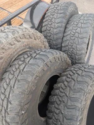

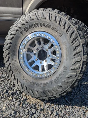

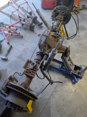

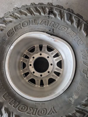

At this point I've been collecting some parts and pieces and getting planned work down. Wheels and tires, set of 05+, some brake pieces, and the atlas.

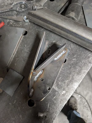

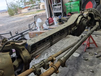

I plan on keeping the 6l80 with the stupid low first gear so I can run a slightly shallower tcase and axle ratio. So far that's panned out well. I did weld on histeer for now and even added another layer up top to keep things as high and controlled as possible.

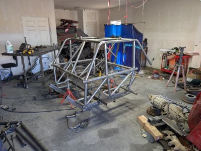

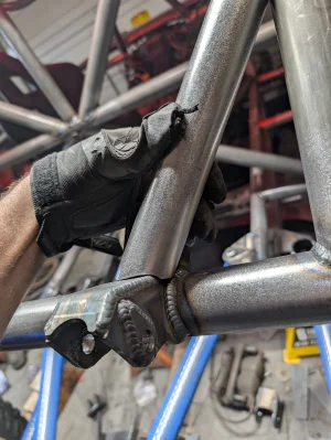

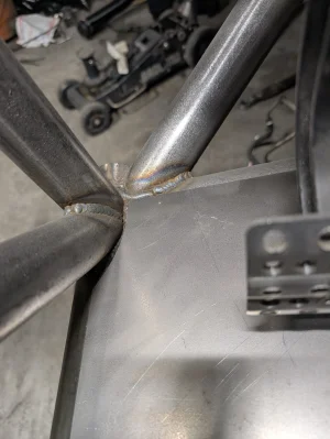

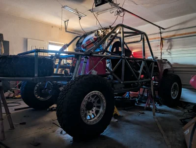

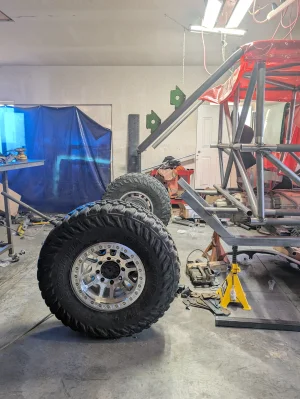

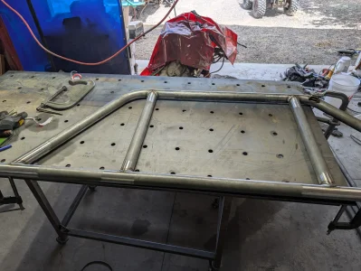

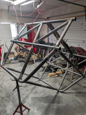

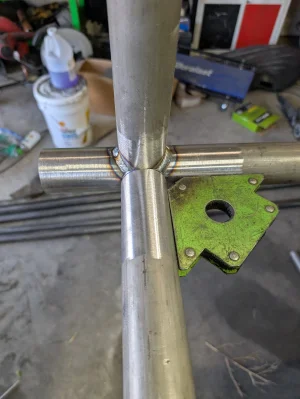

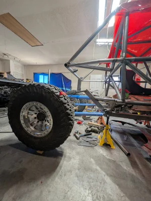

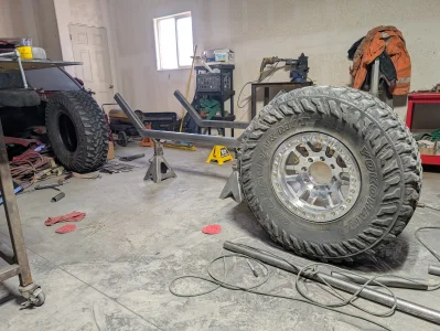

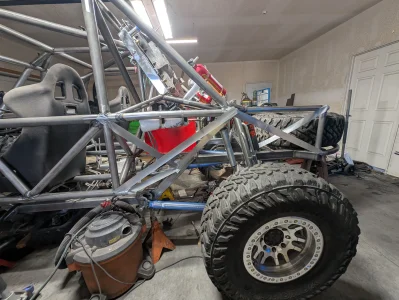

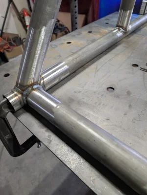

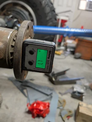

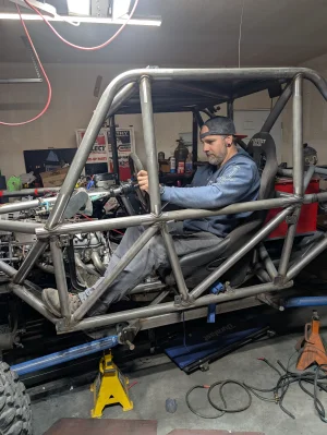

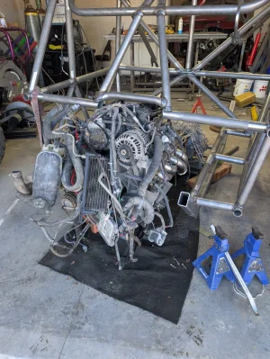

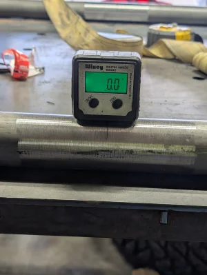

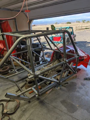

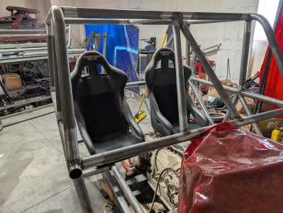

Then it was time to finally start putting the chassity together. My basic goal here was to shoot for a wheelbase. I wanted, the motor sucked back as far as possible without keeping the drive shafts too short or violating the rules of 4500. Then I wanted to keep the cab as small as reasonable but still have enough room. I roughed in some measurements based off of my old TJ chassis and just widened it slightly. Otherwise it's roughly the same interior space as the TJ with the cage, with the exception of the motor sitting where the transmission used to be. A lot of tack and remove to fully weld all the tubes underneath coped tubes and realigning things. Throughout the weld process, I was able to keep everything within 1/10 of a degree of parallel. So for a garage floor build and hand notching I don't feel too terrible about it. In hindsight, I should have built the cab a little bit larger, it is very snug in there currently. But it's growing on me.PXL_20250510_232514919.webpPXL_20250521_010325471.webpPXL_20250521_010458945.webpPXL_20250521_010438646.webpPXL_20250430_184304151.webpPXL_20250509_231557447.webpPXL_20250520_232812464.MP.webpPXL_20250429_221841740.webpPXL_20250429_215805105.webpPXL_20250429_215013174.webpPXL_20250511_210946816.webpPXL_20250429_215903509.webpPXL_20250512_024409156.webpPXL_20250510_233319465.MP.webpPXL_20250429_214949888.webpPXL_20250510_233250234.webpPXL_20250510_233240470.webpPXL_20250429_202748201.webpPXL_20250510_221158423.webpPXL_20250521_010558307.webp

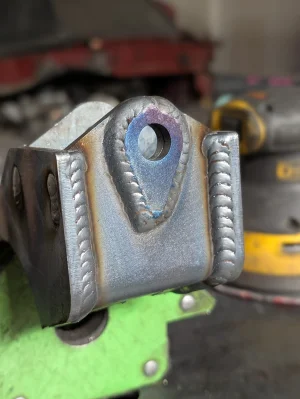

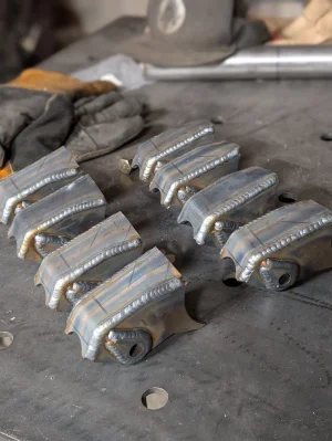

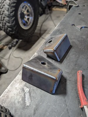

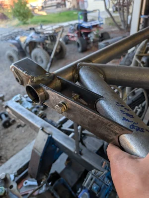

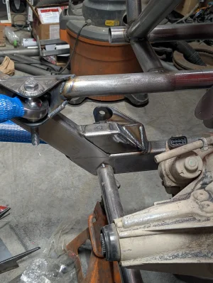

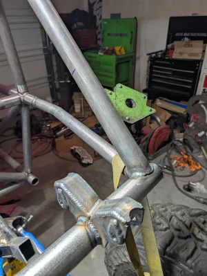

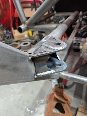

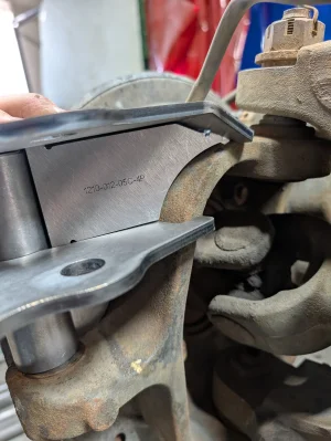

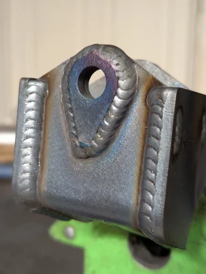

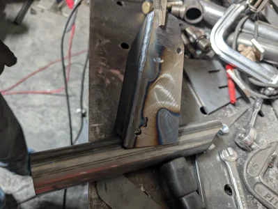

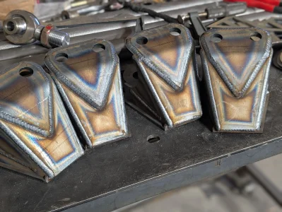

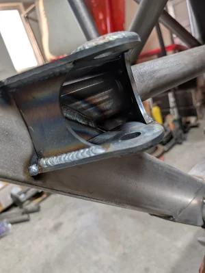

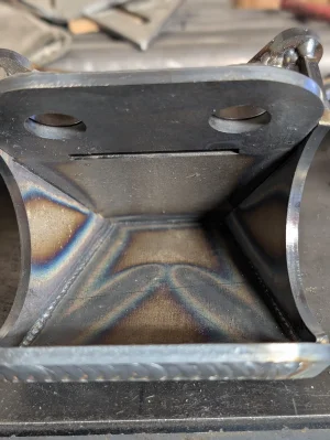

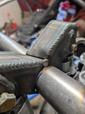

Then it was time for a lot of brackets and tabs. Some of these were tabs I had already designed to use with some links I had done on tacomas. Others were some parts from TMR customs. And some others were some brackets that I really liked from jehc who had helped us with the center mount setup for my wife's truck. Lots of tie-in stuff and trying to get mounts to touch on more than one piece so that everything is tied together because I am very hard on things. Also through in a couple photos of some parts pieces and progress for my wife's truck. Was awesome to be able to get my kiddo out in the shop to give me a hand marking things as well.PXL_20241106_050535867.webpPXL_20250612_022803011.PORTRAIT.webpPXL_20250727_022717303.PORTRAIT.webpPXL_20250611_025009174.PORTRAIT.webpPXL_20250611_025024271.PORTRAIT.webpPXL_20250720_000114416.webpPXL_20241106_050206551.webpPXL_20250713_215941307.PORTRAIT~2.webpPXL_20250712_002003796.PORTRAIT.webpPXL_20250724_011939615.PORTRAIT.webpPXL_20250712_012307320.webpPXL_20250724_020309527.webpPXL_20250725_012609443.webpPXL_20250731_222632452.PORTRAIT.webpPXL_20250413_010102324.webpPXL_20250731_222616715.PORTRAIT.webpPXL_20250402_030836778.webpPXL_20250706_222738865.webpPXL_20250725_012558881.webpPXL_20250725_012602645.webp

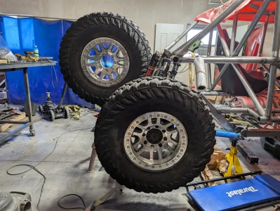

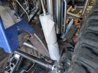

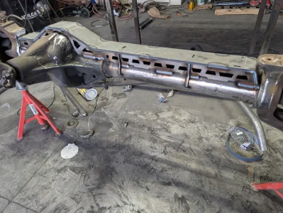

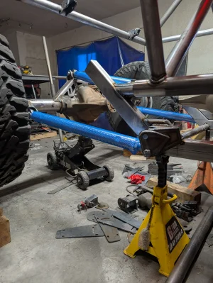

The next plan was to start sorting out axle location and shock mounts. I decided to lay out the axle and use the mounts on the axle to lay out where the shocks would land on the chassis and build the rear chassis around Those mounts. Seems kind of backwards but for free handing it, I felt like this was the best route for me to go. I wanted a setup with as flat of links as possible, minimal pinion change, minimal drive shaft plunge, and ultimately being able to use the same link as a spare anywhere. My lowers have the heims pretty much sucked all the way in and the uppers have the hiems about halfway through the threads. This let's me carry one spare and since all the joints are right hand inch and a quarter, I shouldn't have to worry about that as much either. I added some bracing on the chassis side Shock mount just in case we blow through the bump stops and just because I love tying everything together.
PXL_20250803_164350866.webpPXL_20250803_210713259.webpPXL_20250803_173306648.webpPXL_20250801_224900614.webpPXL_20250803_212215561.webpPXL_20250803_210729967.webpPXL_20250803_210726700.webpPXL_20250801_231534206.webpPXL_20250801_230702444.webpPXL_20250802_024113612.webpPXL_20250802_021203290.webpPXL_20250803_215138061.webpPXL_20250712_014036358.MP.webpPXL_20250803_163040015.webpPXL_20250803_173200192.webp

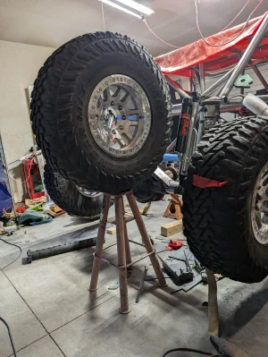

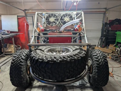

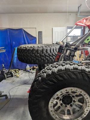

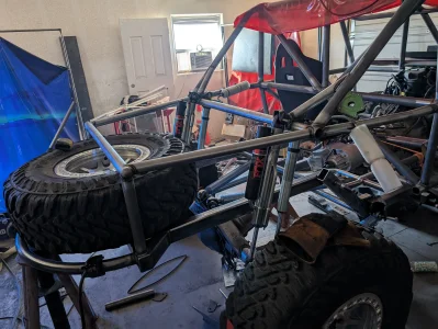

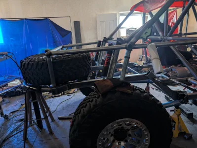

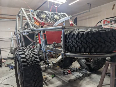

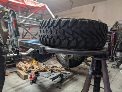

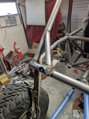

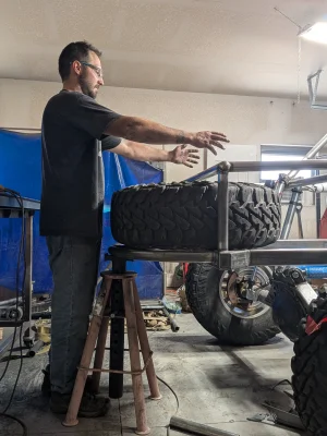

After the axle is in place I wanted to get the spare mounted. I was torn between single spare or dual spare. And I was also torn between horizontal Mount and vertical mount. Ultimately, I ended up deciding on a single horizontal Mount with the Jack and tools and other spares on top. At this point I know that is going to change. I have been dragging the rear bumper around the spare quite a bit and I want the additional weight of the second spare on the back for shock tuning. So I'm going to cut a bunch of the back and go to two verticals with the Jack and some tools in between them. Ultimately the way I plan on doing it should put the center of gravity for that in the same spot as it currently is but gain more clearance as well as about 150/200 lb of weight on the back which is just about exactly what I want. While I do like it being down low and pushed far back like this for the desert, ultimately the car needs the rear bias because that front axle is a house worth of weight, and in big climbs. I need the clearance. But that's the beauty of testing it out and seeing what actually works the way we thought it would.
PXL_20250817_222554319.MP.webpPXL_20250814_221420619.webpPXL_20250816_231619303.webpPXL_20250816_231615580.webpPXL_20250817_171018878.MP.webpPXL_20250814_214912252.webpPXL_20250816_213435960.webpPXL_20250814_221006362.webpPXL_20250816_213352894.webpPXL_20250814_221406869.webp

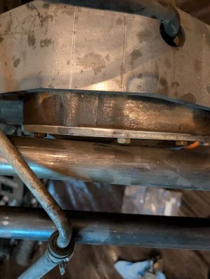

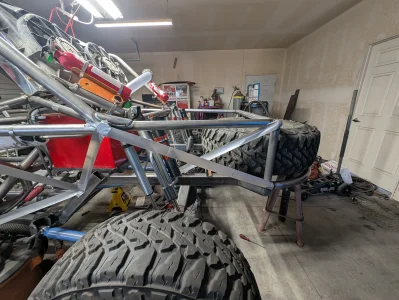

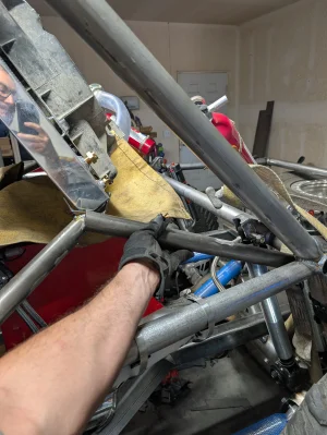

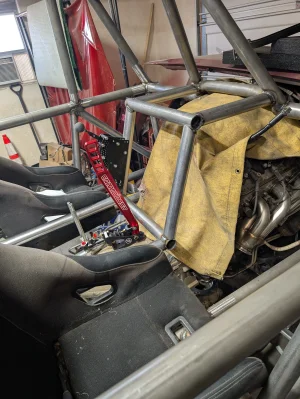

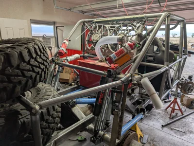

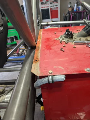

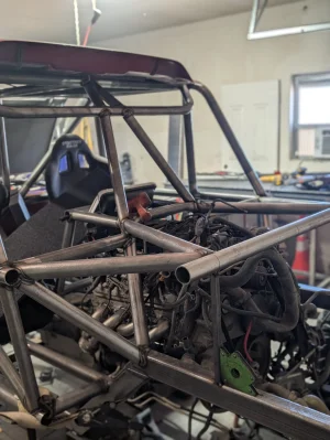

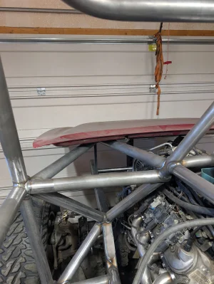

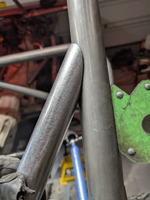

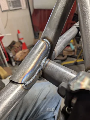

I started moving forward. Laying tape to sort tube placement. Mounting the fuel cell, radiator and laying the console tubes. How I set the tubes in the cab has been my biggest regret and will be reworked soon. Just so much lost space and no reasonable way to panel it or set seats and harnesses. Huge regret.

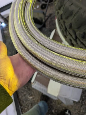

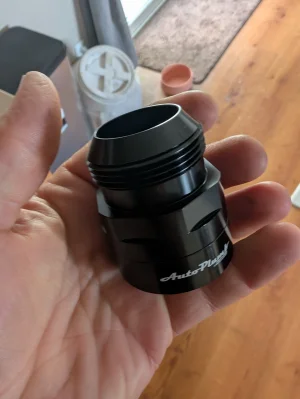

Radiator is an aluminum 3 core "stock" radiator running stock fans off the PCM. Cell is a 25 gallon circle track cell. I moved the hard pickup to lube from the pass rear corner to the center of the cell floor, put a hydromat to it, and foamed the rest. I had great luck with foam before only ever running ethanol free. We will see how 91 treats it.

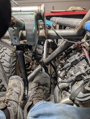

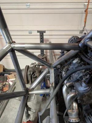

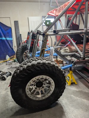

On to the front. The front was going to be very busy and very tight. While I knew moving the motor back would give me great room in front of it, it meant. Ext to it in the foot well would be crazy tight. Mix in dual shocks, a trussed boat anchor Dana 60, mechanical steering, panhard, etc and it was going to be a packaging nightmare. Plus sinking the body down on to the tube work and getting the tires to fit the body and not be in the headlights, or have a craY tall front clip. It's the opposite of the rear.
PXL_20250901_164738372.webpPXL_20250901_164140767.PORTRAIT.webpPXL_20250831_212328898.webpPXL_20250831_211644023.PORTRAIT.webpPXL_20250831_212322504.webpPXL_20250901_165915918.webpPXL_20250901_200300334.webpPXL_20250831_230212458.webpPXL_20250901_200050296.webpPXL_20250902_012545863.webpPXL_20250901_230617056.webpPXL_20250902_011520200.MP.webpPXL_20250907_215559047.webpPXL_20250902_011512172.webp

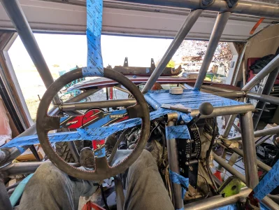

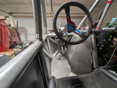

A few notes at this point.

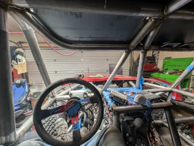

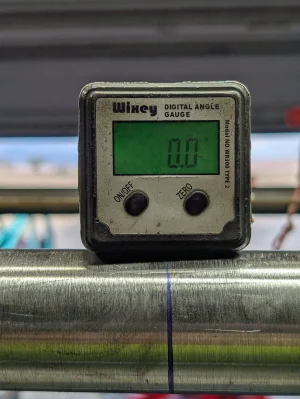

1- looking back I wish I had added a few more degrees angle back in the front shocks. They are almost vertical in the current setup, some more slope would have been nice, although much harder to package.
2- The steering wheel needs to go up a couple inches. It is roughly how I sit and fill the 3rd gen Tacoma cabin, but a touch higher wheel would be nice.
3- a better brake pedal mounting height would have made life easier as well. Both pedals actually. I may go to a shorter pedal length for brake and am sort of stuff as far as gen 4 electric pedal setups. But I think a heel pad will make that better.

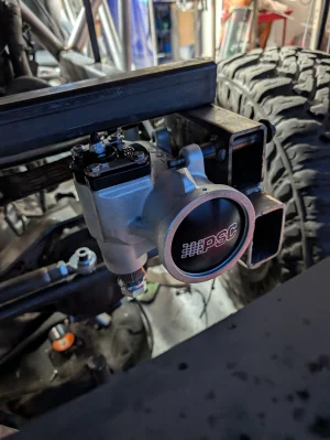

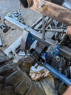

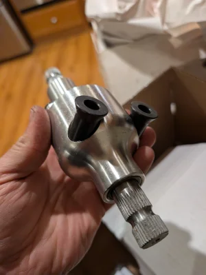

Having raced the stock class jeep, and wheeled a bunch of jeeps with tons and 40's using this box, I went right back to the psc big bore box for this setup. Already set for hydro, 4 mounting bolts, bigger bearings and piston. Seems like a win win.
However.

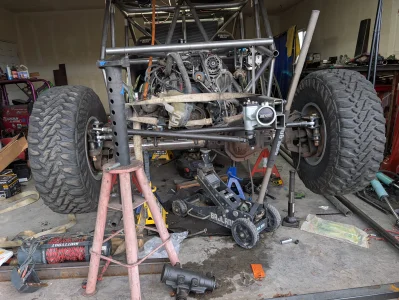

Now that we've been out in the car. It's the wrong box. It's 3 turn lock to lock and it's just too slow at speed. It needs a 2 turn max. I tried using a quickener like we use in circle track, but it just cavitated the pump and make the box terrible to drive. I reached out to power steering solutions and psc for options. Psc offered a jeep speed box. Be much faster like I need for the speed but I lose a little power in the tight stuff. There really isn't crawling in this car so losing that is ok. The downside now is despite saying it'll ship the following Tuesday, were now a month in and no shipment. The frustration is real, but may reach back out to power steering solutions and see if fitting one of their boxes might be the better move, or just the move that gets me a box. PXL_20250905_014202964.webp

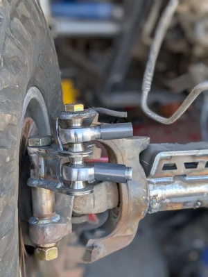

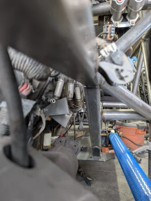

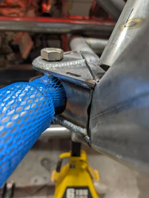

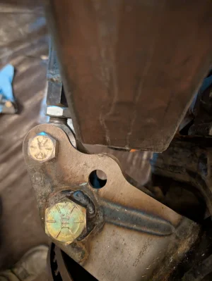

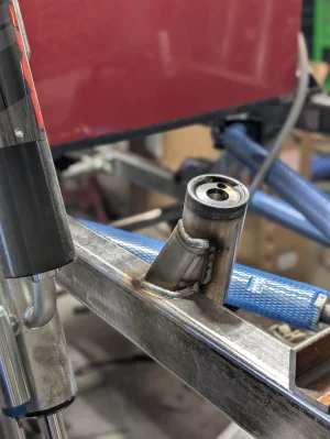

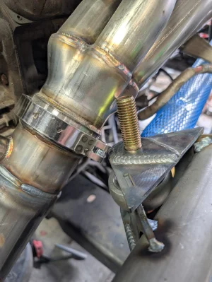

On the front, I went with an offset joint on the axle side of the drag link to prevent interference. I wedged all of the steering super tight to each other. The coilover has less than 3/8 of an inch between it and the panhard hardware. The panhard has less than a quarter inch of diff clearance at full bump and the tie rod is right up against the panhard mount at full bump and steering. And then the drag link actually runs in front of the tie Rod at full bump. It's a lot of freaking packaging. And then ran the bypass as a connector between two of the front structure tubes, and put the coil over off of its own Mount off the front. I still need to tie these two together with a brace, but they are holding up fine for now. Ignore the bent temporary panhard bar that is in there, it was just mockup.

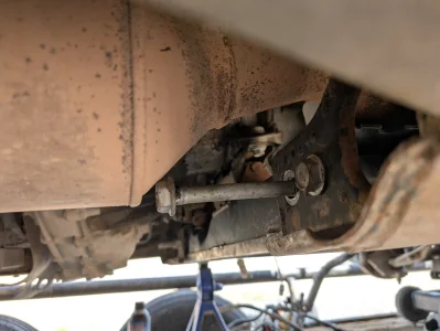

You can also see the ridiculous struggle bus of trying to clearance the exhaust and the front drive shaft. And how tight the passenger side upper link mount is to the exhaust as well. It is a wild amount of packaging.PXL_20250928_211716897.MP.webpPXL_20250913_163747888.webpPXL_20250923_231742756.webpPXL_20250928_211411041.webpPXL_20251003_001702129.webpPXL_20251010_001118586.webpPXL_20251003_001705174.webpPXL_20250913_163807916.webpPXL_20250928_211438401.webpPXL_20250928_211757228.webpPXL_20251006_000339755.webp

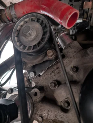

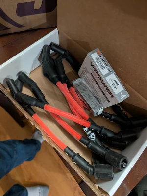

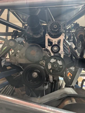

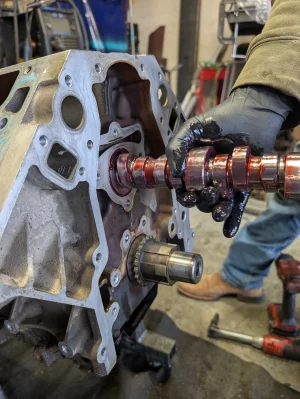

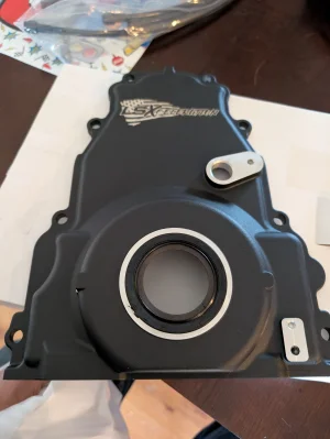

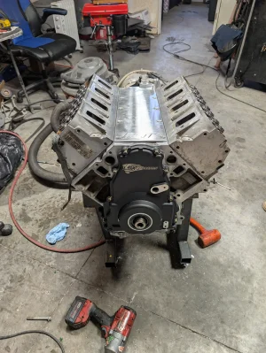

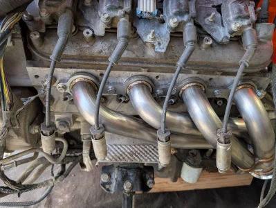

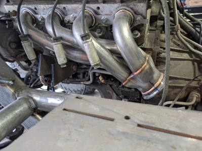

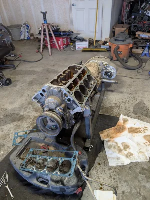

Next step involved a lot of learning for me. I am not a motor person by any means. I am generally just a monkey that glues things together with some bubble gum. So we tore into this motor just to replace things we knew were problematic and wanted to change, only to create some others and require some other changing. So the initial thought was DOD delete, cam from Brian tooley, new lifters and pushrods, suggested dual valve springs for the LS3 heads, new front cover, and then just overall inspect everything. Were going to just do new head bolts but stripped the block on the last bolt in the torque sequence. Or the second to last bolt. So that required getting the tick performance jig drilling everything out to half inch and doing studs. I needed more clearance next to the power steering so I did a power steering and alternator and idler pulley relocate bracket from ICT. And also converted the coolant later to -20 an line, but that created an interference between the straight forward port and the belt. Belt. So I had to make a small bracket to angle the tensioner and then shave the same quarter inch off the back of the tensioner to keep things in line. We also went to the PSI harness to use the factory ECM. The goal was to use HP tuners to get everything set up, and a buddy of mine up the road had a HP tuners dongle to let me use which would save a chunk of cash not having to buy a new one. Unfortunately, this decision would come back to bite me down the road.
Other new items include all new sensors, new power steering pump and reservoir and pulley, new crank pulley, new oil pump, new oil pickup and new steam port setup. All new gaskets and seals and fancy parts and pieces. We kept stock injectors and fuel rail and throttle body due to the drive-by wire setup.

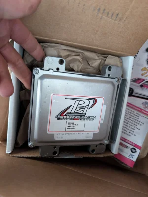

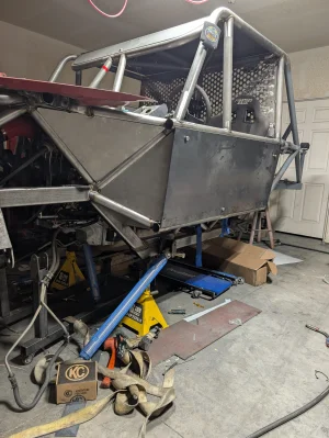

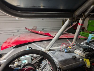

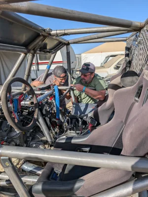

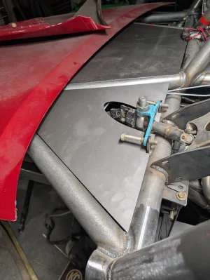

This is about the time where I started making really poor decisions. It was right after Christmas and I was still convinced I was going to finish this car and go to hammers. We were getting the car to fire up but we weren't getting a crank signal. Reading. RPM was purely coming off of the cam sensor. All the sensors and gauges read perfectly fine before we pulled the drivetrain and swapped everything around. So we weren't sure where to chase. We started doing continuity testing and checking pin outs on the PCM and just having a bunch of issues with the motor running correctly.

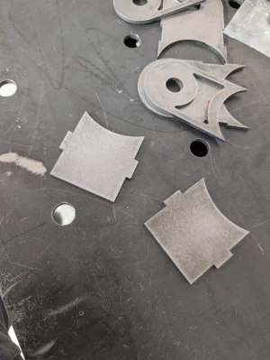

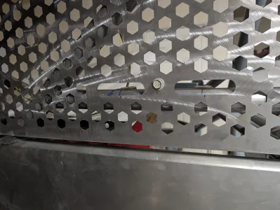

Then we were also starting to work on templates and panels for laser so my brother could cat and cut the parts for me. This actually went pretty well, except for the dog house around the motor. That ended up getting way more complicated than it need to and really is the driving force behind redoing that hole in cab setup.

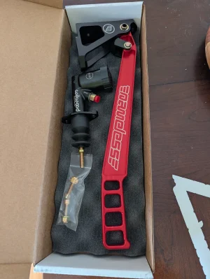

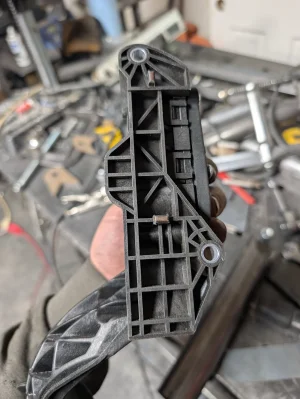

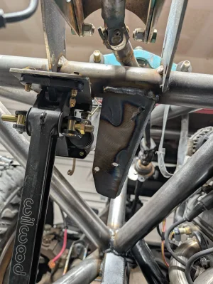

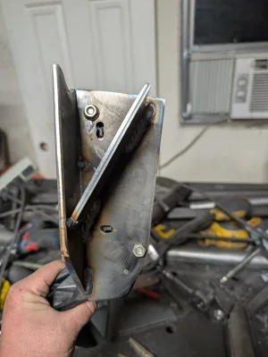

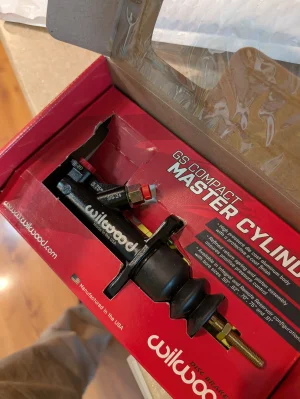

I also had to build some handmade mounts for the throttle pedal and brake pedal assembly. Went with a 16 to 1 dual master wheel wood setup and then just the factory truck electronic throttle assembly. It's a pretty tight fit in there, but it does lend itself to work pretty well all things considered. I do want to make a heel stand which should make the throttle pedal inserts substantially better. At this point. We're also starting to lay out lights and running electrical line and building the harness for the switch panel controller and all of the accessories.

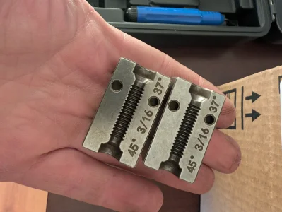

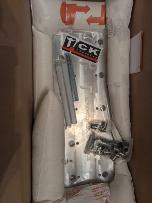

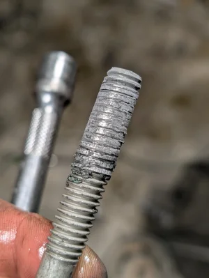

Side note to this. If you're doing LS studs. The tick jig really is awesome and makes it pretty brainless to do. Definitely recommend it. If you're local to me and need one just holler.
