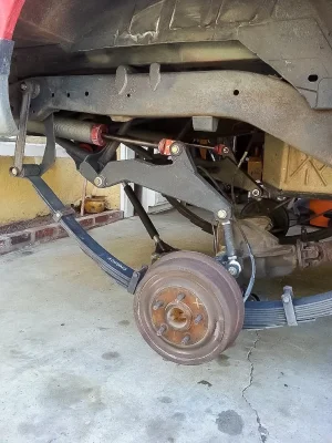

After doing a ton of wheeling and exploring in the XJ it was time to go fast. So with the help of @the_fablab_ we built a 1993 TTB Ford Explorer. It was everything we wanted....for a while. It had coil-overs up front with 16" of wheel travel and working 4x4. In the rear it had a cantilever set up with 20" of travel, this little expo worked great!

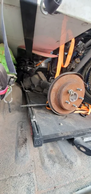

Collecting parts was fun, basically the whole drive from Minnesota to Southern California we were collecting parts. Both the Jeep and the Ram were packed tight! We had the frame of the roof of the ram, got an 8.8 in Oregon and a 4l80e in Northern California and also had a transfer case from Nebraska, and the beams we in there as well.

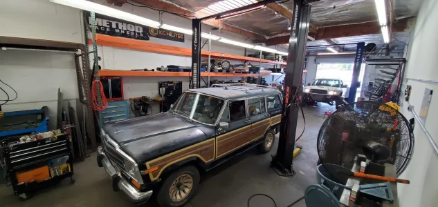

We finally made it back to Southern California and the build was getting ready to start. @the_fablab_ was going to be doing most of the build and the fabrication work obviously. But I had to prep a bunch of stuff before I brought it over to Mike. The time line was originally 2 weeks, to do all the suspension, and a LS/4l80e swap. We know it was very ambitious.

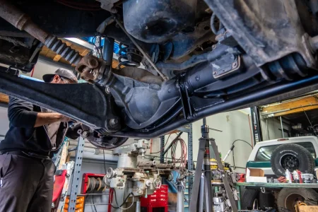

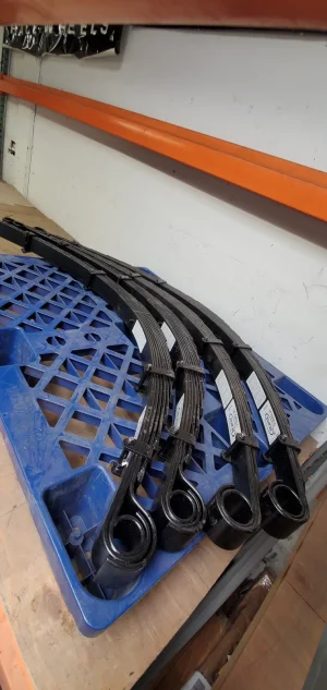

The Wagoneer is a little on the hefty side so Mike ordered custom leafs from Deaver. We weighed the Jeep before the build, 5100 lbs stock with gear in the back.

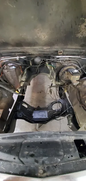

After getting most of the parts and the Jeep over to the shop it was time to cut into this thing. @the_fablab_ and myself had a great idea of cutting the front frame section off, dropping the motor, transfer case, front axle and transmission all out at once and it worked so good.
It was a TRUE frame off restoration!😂
Here's a full video of that process, it worked so well!
