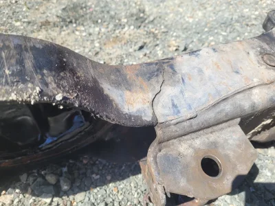

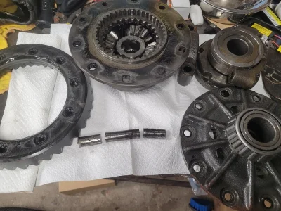

Well, I dropped the front end out to give it a "full prep". I knew the pivot bushings were toast, but holy shit, i picked a good time to dive in. The cross shaft in the front ARB was broke into 3 pieces. Luckily the ring gear kept the broken pieces from ejecting themselves from the carrier and wrecking the whole deal. The diff still worked fine, locked and unlocked properly. $35 for a new cross shaft and i'll be back in business. But thats not all, apparently I am not as nice to the truck as i thought and the driver side beam was cracked all across the bottom. When i built this set of beams for the truck 5 years ago i had intentions of plating them and beefing them up, but i never did. I guess now is the time. lol.
Here is everyones reminder to not wait 4 years between front end rebuilds. lol.
