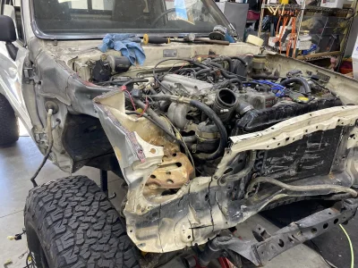

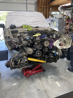

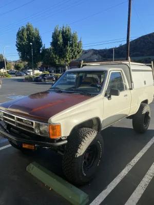

on another note here are some pictures of my truck i crashed it a few years ago and got it back to stock so now i have no excuses lol
How wide are the frame rails on your truck and the axle width? If you don’t want to go through the bed there are a number of ways to run shocks under the bed. Relocating the shocks to outside the frame gives the best overall performance but the longest shock you’ll probably fit will be a 10-12” without a body lift. Check out “Freel Good Performance’s” shock relocation for 3rd Gen 4Runners or Solo Motorsports shock relocation for Taco’s / 4Runners to get an idea of what you could base one off. A shock tower could also work too.
You’ll need a wider rear axle to relocate the shocks outside of the frame (which is why I was asking about the frame and axle widths) or at the very least 2” wheel spacers but even those won’t work to keep from rubbing the shock at full articulation. Potential axles could be a 1st Gen Tacoma (or 3rd Gen 4runner but more brackets to cut off and the 8” diff vs the 8.4 in the tacos) at 60” wms to wms or a Tundra 66”), but that may be much to wide if you’re far less than 60” axle width already.
