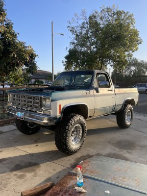

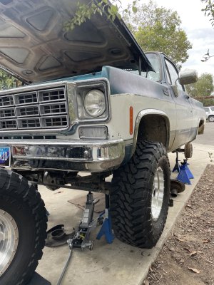

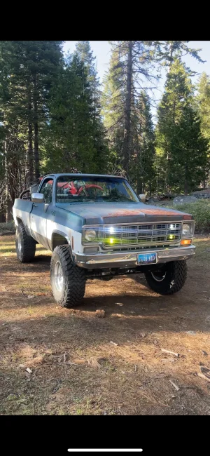

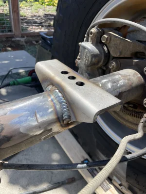

Got the old brackets cut off and of course nicked a hardline in the process. New perches are on just need to get new hard lines sorted plus shock mounts and its all sorted.

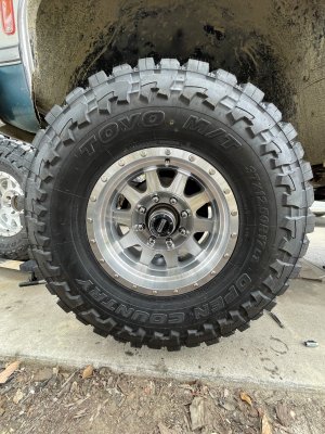

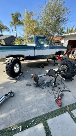

Found time to finish the 8lug swap up front and threw a tire on to see how the new wheel offset would look. Still waiting on brake lines and shock mount stuff for the rear end to go in.

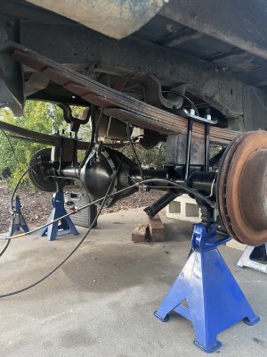

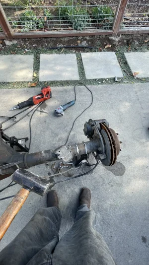

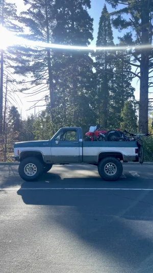

Finished the rear end swap (SF 14bolt out of a 1500hd), got crossover steering done and all the stuff and things inbetween. New brake master cylinder and booster too. Littlest sister helped bleed the brakes and finish up all the smaller finishing touches going through the new rear end.

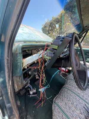

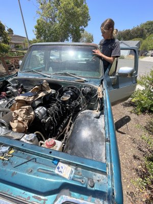

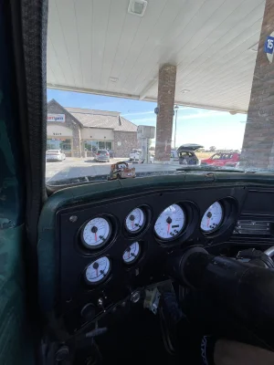

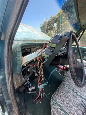

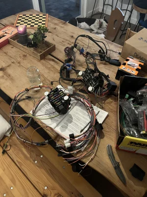

Immediately after wiring the new dash, sent a 5-6ish hour roadtrip SB-Sequoias. Alternator ground somehow came loose at the very end but no issues otherwise. 12-17mpg all the way was nuts loaded down. Little sister gave me a tow mater figure for the dash “in case you break down”
