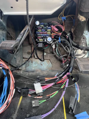

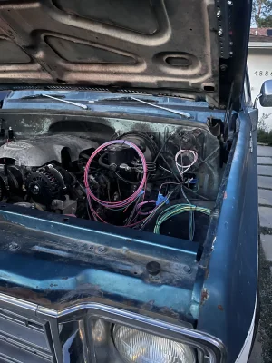

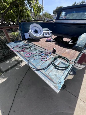

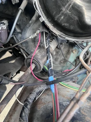

Found an absolutely atrocious splice in the old harness. This was what was supplying battery power to the factory fuse box. I gave up taking pictures towards the end of getting the engine side of the new harness done, but I got it started last night at like 11 and woke the neighbors up. Also found a pretty bad leak on one of the AN fittings at the fuel rail. No idea how that worked itself loose but it did somehow

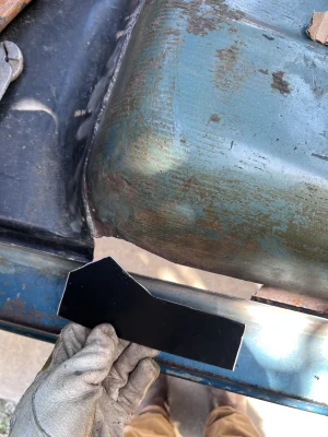

So the front end rides like absolute crap and I haven’t really given it much thought other than that at some point I should get an alcan or deaver pack for the front if I don’t link it but anyone have thoughts on relocationg the shackle pivot? It appears to be just a bushing sleeve attached to a plate that’s riveted to the frame so it would t be hard to just move it forward, drill some holes and mount up a longer shackle. What should I consider if I did something like this? The pack is already flat enough that I don’t think pulling an overload would do much good for it.IMG_4294.webpIMG_4295.webpIMG_4296.webp

When I was building a K5 of this vintage, I installed the 56” springs from the rear of a 2500 of the same square body vintage with the overload removed. The 52” springs are also a popular swap. The longer springs help with the shackle angle and will definitely help the ride quality. That project never got finished, but I definitely wasn’t the first to do a spring swap like that.

Yeah I’m thinking since I’ll likely link this thing in the front at least down the line I’ll do that with ORD’s hanger kit and try and use their shock towers for their coilover kit with some 14s just with no springs on em and the valving set more for leafs. I’m already pretty tired of how it rides as is lol
