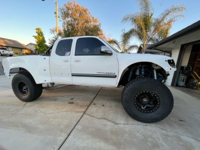

Starting this thread to try and get idea's for my next build. Currently I have a 2001 tundra Prerunner that's 2wd with 3 full size seats. I am just about done with the rebuild on the front end and will most likely be looking to sell it once competed. Reason being I now have 2 little boys and a wife so we will need more seats. On top of that I do not like the idea of only having 2wd on solo runs with the family. I personally am leaning towards a Bronco because I love the aftermarket support from mild to wild and ease of building. They also look awesome IMO. Major con is the cost of finding a stock or mildly built one. Whatever I build need to be able to confortable cruising In the desert at a moderate speed and be able to run trails like big bear or whatever with ease. I will NOT entertain the idea of a razor or any SXS mostly because I like women, also my wife hates them more then me!

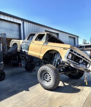

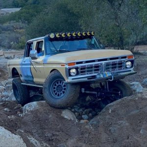

In 2007 I sold my 2 seat Ranger and I went back and forth on a few trucks to build(Supercrew, Bronco or a 4 door F250). I wanted needed 4 full size doors and knew that I’d be towing to and from the Dezert. I had just bought a new Titan and was never planning on buying a diesel, so a 4 door full-size was my original plan, but I knew it was going to be WAY to heavy for a gas truck to tow with. So I was started looking at 4 door midsize trucks and ended up going with a Sport Trac. 4BA5681C-1C9B-44B5-9C01-AC83AC9BC579.jpeg
With that being said, I’ve never really had the need for 4wd, and only put my Raptor into 4wd twice before. But if I did I’d sell my current Motorhome and buy a Diesel pusher and I’d love to build a F250 4 door 2F3953E7-8168-4584-B8B2-6937F6126E4D.jpeg2767E3B1-B322-49B4-AA82-98C51ED8777D.jpeg8FD8EF4B-4239-4260-BEED-D033D704A683.jpeg

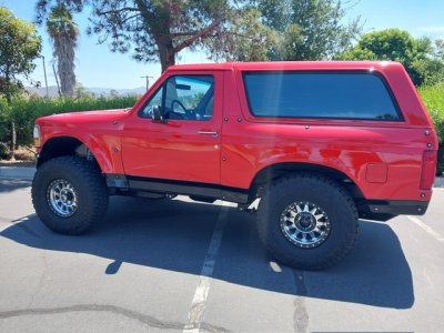

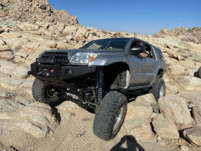

I built a 1st gen 4runner and if I had to do it all over again, in order of preference, I'd go:
-Bronco
-1st gen Sequoia
-Dbl Cab Tundra
-V8 4runner
The Bronco platform has been proven and theres so many companies out there that offer almost every part and configuration you could imagine to build it just the way you want, its a no-brainer.
All of the toyotas above would be built with TTB, no more plowing crossmembers into the ground at bump.

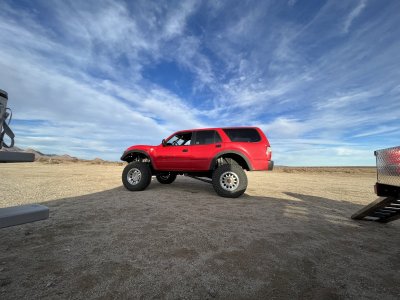

I'm currently in a similar boat of trying to figure out how to off-road with a family of 5. This limits me to crew cab full size trucks or full size SUVs. Raptors have not dropped in price nearly to my level but a Fraptor is easy enough to build and should work well enough with mid travel standards. I thought about beaming a crew cab truck but the road manners make me pause every time. A solid front axle makes a capable trail rig but does not ride great at speed and are typically super tall. I tried the Jeep thing and did not like going slow. I'm trying out the long travel IFS thing on my current truck to see if it could be scaled up and open the possibility of using later model reliable vehicles with a ton of fab work. Ultra 4 cars seem to work pretty well with the same technology. At this rate I'll probably just build my wife's second gen Sequioa and deal with the huge body.

My truck currently has a 2wd camburg race kit. Don't have any experience with the solo 4x4 kit. Been in a couple tundra's with the chaos 4x4 kit and they were a little lack luster maybe because of the stock location single 8" coil over idk. The tundra platform is pretty good but they get stupid wide mine sits at 93" front and 91" rear track width. Really to big for most trails not in the desert.

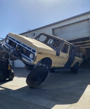

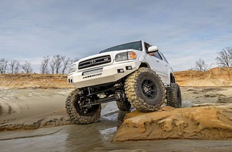

That damn @fablab got me thinking about this again over the weekend. An FB marketplace voyage shows that 1st gen Sequoias are stupid cheap even in 4wd and V8. I daily a 1st gen Tundra so am comfortable with the not quite full size package. The frames are too wide, steering is terrible, and spindles are too weak to keep 4wd arms but a super duty axle fits well up front and race take-off 40s could fit all around with slight trimming. I can fit two buckets in the second row and stagger a third into the trunk for the kids. Bonus is if it wads up I can just build the rock buggy I've always kind of wanted. Three link front, four link rear with coilovers and airbumps at every corner. Cut body liberally to obtain low ride height with decent up travel and it should be a decent mid speed overlander. I can always put fiberglass fenders on front to preland it up.
