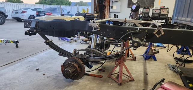

Okay got some work done,

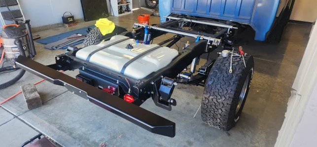

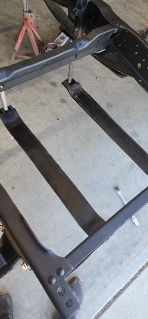

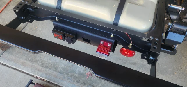

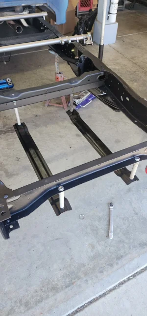

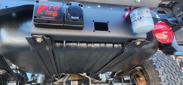

Starting with the fuel tank, currently I'm using the LMC spacers to install the larger tank, I definitely have something better in mind for this.
For the lower chafe protection I used VHB tabe, this stuff always works good:

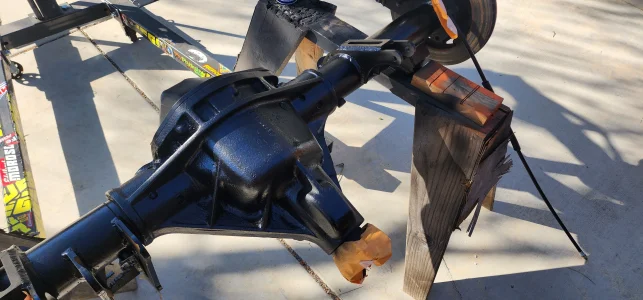

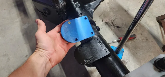

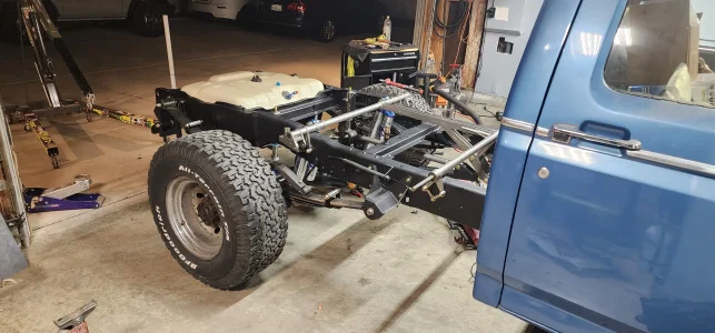

I sprayed the rear axle with some rubberized POR, I like how it came out.

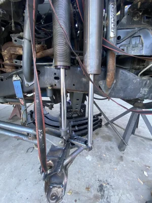

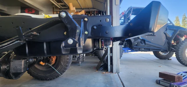

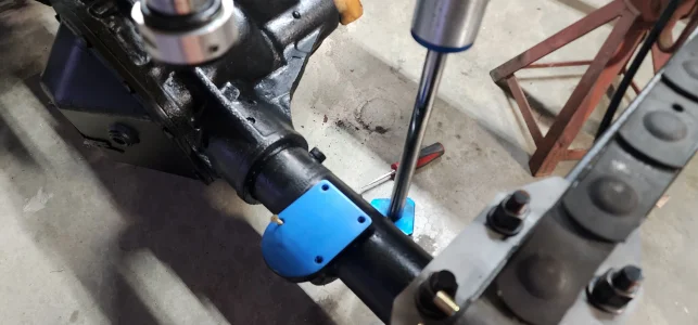

I did a quick adjustment on the rear bumps by removing the top out spring and replacing it with a spacer to convert the bump from a 4" stroke to a about a 3" stroke.
Shocks and axle bolted in:
Still need quite a bit of hardware adjustments

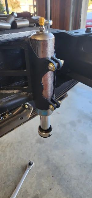

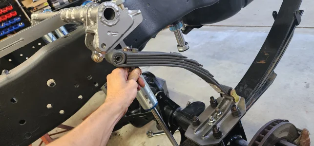

The overload springs turned into limit straps, I knew this was gonna happen but needed everything assembled to figure out what length shackle to make.

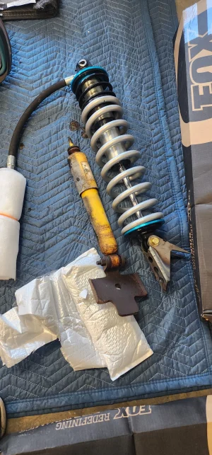

Travel looks promising with the oem 1g shock, maybe I can switch to a 2g or bolt in raptor upgrade later.
Gotta have the bling strike plate!

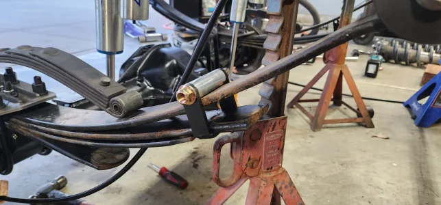

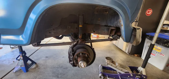

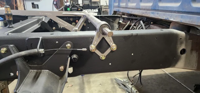

For this truck, it's a manual transmission, so I NEED a parking brake, I installed a lugnut4x4 rear disc conversion for the D60 with the catty calipers. I hate the long passenger side cable that crosses over the axle... so I am using 2 driver side cables and a bar to pull both sides equally, you can pretty much see what im planning to do here:
Most of the rear stuff on, save for some missing hardware here and there;

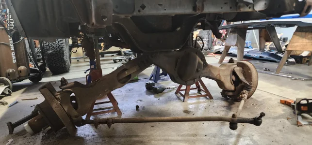

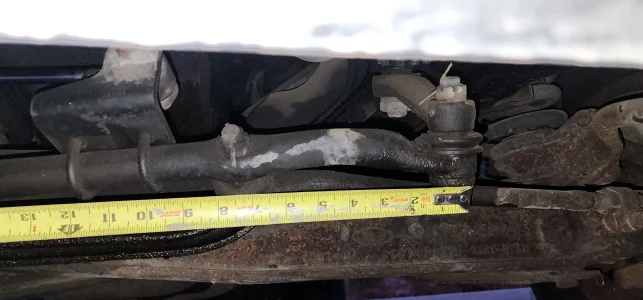

Trying to decide what to do on steering and

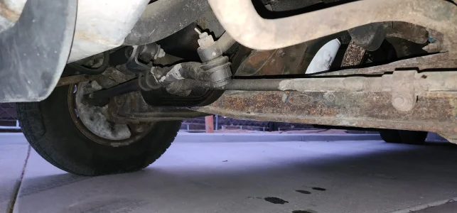

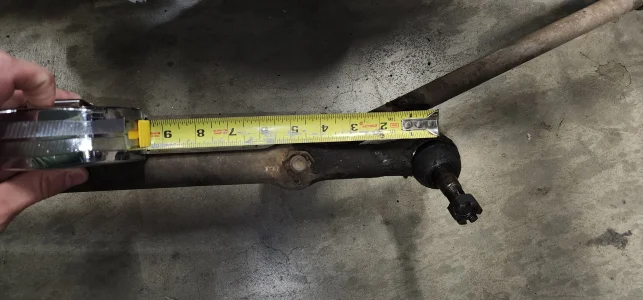

I noticed on my 2wd F350 that the left hand pivot is further inboard by about 2 inches as measured on the passenger long tie rod.
Top 94 2wd F350
bottom 4wd ttb f250
I ordered moog DS1073 to test it out for the 82 hopefully the longer driver side link that will be required will reduce the bump steer. I believe it will.

I'm sure you already know this but... normally you draw a line thru the radius arm pivot to the beam pivot and that dictates where you want the steering pivots. Dana 44HD/50 pivots are different from 2WD/Dana 44 TTB pivots.
There is also van and Ranger steering which had different choices of pivots. There is a moog book that shows all the thread and taper info if you are into mixing and matching stuff. Rangers / F150 / F250 / F350 all use the same steering boxes and if you want a larger sector shaft some super duty boxes are much beefier while sharing the frame pattern.

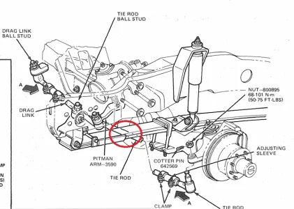

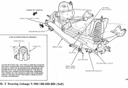

I am likely going to use all F350 2wd stuff. I'm not going to do any geometry work on the steering, this truck wont have that much travel I think just the biggest OEM ford stuff I can get. I do wish I could do turnbuckle style connectors instead of the adjusting sleeve clamp things.
I think the drag link has the short distance on my truck because it is was a leaf spring truck. To clear the leaf's ford moved the Driver tire rod Furter towards the knuckle.

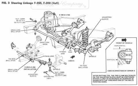

This is 2wd F-seires:
this is the Van/E-1,2,350 steering, note the solid drag link with no adjustment :
Quick Edit to add all of that is from a 1982 Ford Shop manual.

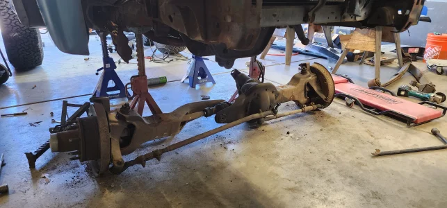

Since I have an 2wd excursion, I measured that stuff and I it will go right on my bronco that close to the same as your truck plus it is way bigger than the ambulance steering and I got everything off rock auto for around $200.
