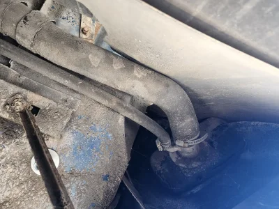

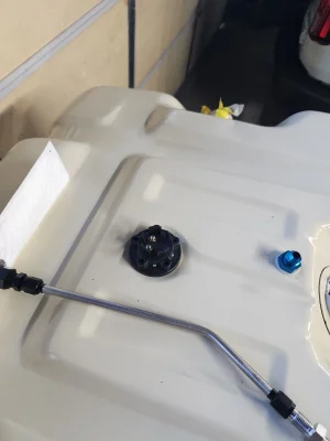

That hole on the top of the tank is for the rollover valve, which many people gut so they can fill the tank without the nozzle kicking off all the time. Last time I messed with the tanks on my Bullnose I used some brass PEX? fittings that fit the grommet, Y'd them together and installed a filter on the end. If you use that for the send I'd add another vent somewhere at the very top of the tank. FTI there is a factory tank for the rear that holds like 40 gallons. Google F26 tank swap.
Yeah this is that tank, or the LMC version it's 37gallons. I'm going to add the extra vent like you suggested. Makes sense. I was looking on my diesel and the vent goes into the fill port so I may try to find a diesel filler and do the same to this truck.

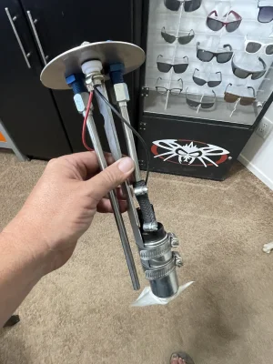

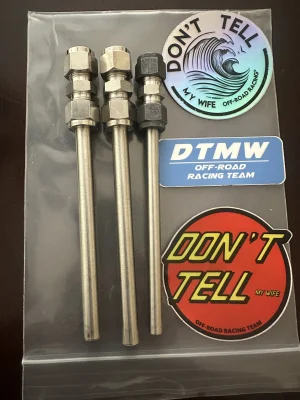

bumping a bit of an old post here too, but if you still need to do this or arent happy with your current setup, i make a fuel pump extension kit for the f26 fuel tank swap that holds together better than what they give you factory, the issue i found while offroading mine is fuel sloshing can blow the pump apart
DM me if interested i can get you set up with the PN's its mostly off the shelf from mcmaster-carr

bumping a big of an old post here too, but if you still need to do this or arent happy with your current setup, i make a fuel pump extension kit for the f26 fuel tank swap that holds together better than what they give you factory, the issue i found while offroading mine is fuel sloshing can blow the pump apart

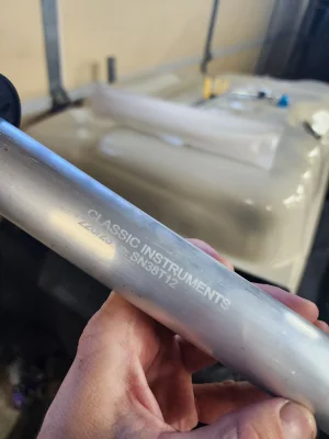

I just make a stainless sender now, this was the first one on my 74 F100

Sooo while I have been slacking big time over the summer ☀️ with this truck I have been picking at it here and there. I am kinda stalling to pull the engine, it needs a rebuild it has rust in the coolant not sure what my best option is.

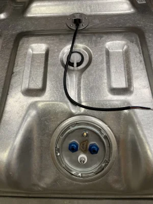

None the less while on topic of the fuel tank I'm basically running a -8 jegs roll over valve that will be vented into the fill hose at the top, it will have a classic instruments fuel sender, and a -6an feed and return, with the feed having a small hydramatt pick up.
For the bottom I coated it with Seymore bed liner in a can, I think it came out pretty good.

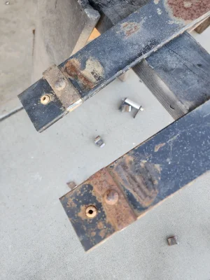

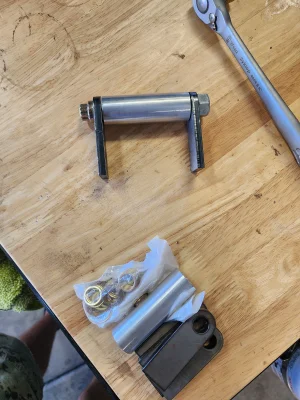

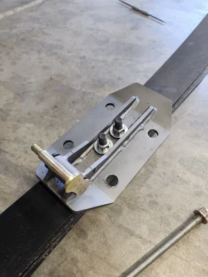

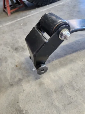

Did a little leaf spring assembly today, not really spending to much time on cleaning or coating these until I try them out, they are the 1g oem raptor springs with a helper spring.
The main item I changed was welding tabs to the clamps so that I can take them apart:
