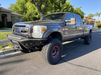

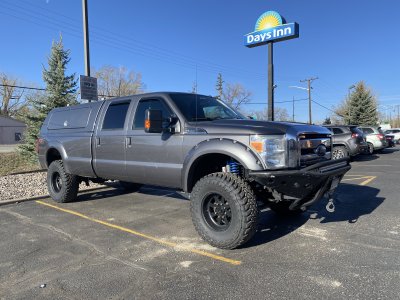

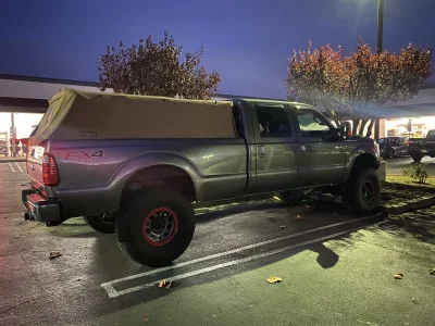

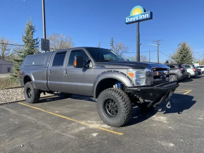

I had a 1999 6.5 suburban that I built with the intention of being a deep wilderness reliable camp rig, so I SAS'd it, put it on tons, PSC assist, then the "might as wells" crept in and eventually the entire thing was redone, including a ppump 6BT and NV4500 swap. I was dallying it for awhile, and it one thing after another, so I sold it in 2022 and found this truck on race dez classifieds.
Had ALL the off-road accoutrements: Carli bypass coilover kit, long travel bags, ARB lockers front and rear, winch, built-in radar detector, stereo, etc. Went to Colorado Springs, drove it back, and it was pretty neglected. Not awful, but definitely neglected. Most notably, a coil was cracked all the way through at the bottom. It took awhile to get my shit together, but it's getting cleaner.
As I got it:

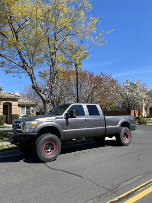

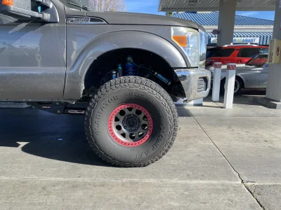

I've been picking away at it more and more lately. Got rid of the Toyo MT's and American Force 18s, picked up some 39" Projects and KMC Enduro beadlocks last year, which changed it a ton for the better.
Mechanical fixes are the standard shit that people just let go too long. New u joints, new rear drive shaft, all fluid flushes, new wheel bearings, new brakes, new parking brakes, got all the shocks rebuilt by Roth Shocks when he was on his Norcal tour last October.
More recently, I removed the front fender flares, I think I kept them on so long because the bedsides are pulled and it'd look weird. Nah, way better without. Fiberwerx fenders are on the list.
Also got new Gladiator AT 40s. They're super smooth and quiet. MTs look cool, but I don't need those beehives in my wheelwells. Projects look great, but they're awful everywhere except the desert.

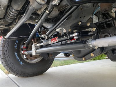

Most recently, I just redid all the steering. PMF draglink, WFO 2.0 .250 wall tie rod, PSC ram, and a box ported by CJ Auto in Southgate. It's so nice.

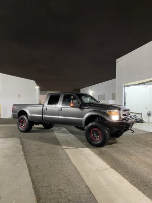

Happy birthday to me. I asked for, and received, this bitchin chase bar from Litt Industries. Was drawn to them because they're super small and can be tucked away and mostly hidden. Haven't seen much about this company, I think they're mostly in the UTV scene, but quality seems to be top notch, so far I'm pleased. Can be wired up to all normal rear lighting functions: turn, reverse, etc. Thinking about mounting it up in that gap between the bottom of the tailgate and the bumper, but I'm open to other ideas.
Will report back with feedback when it's functional.

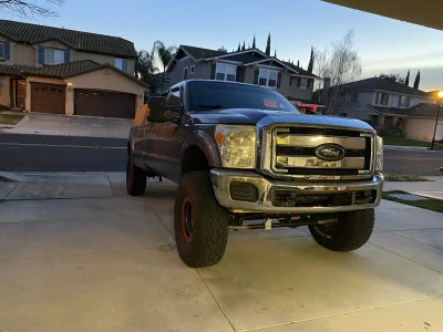

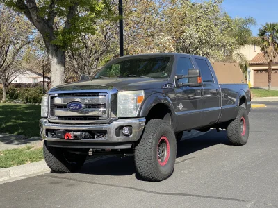

Took off the big ass ADD bumper, it was always a little loud for my tastes, but much better than other aftermarket alternatives. Finally got around to buying and installing an OEM. Found one without body damage for not $900 like everyone likes to believe they're worth. Have a winch mount and light bar on order. Went to get fuel after, immediately learned that it is undriveable, rubs at about 5 degrees of steering angle. Looks bitchin though. Angle grinder comes out tomorrow.
I had to do this to my wife’s bumper in a similar way. I made a poster paper template referenced by holes in the bumper like the two yours has and made it pretty even on both sides that way. Maybe you thought of that already. If you’re cutting it on the vehicle, throw some towels over the hood so the sparks don’t melt into the clear coat and make tiny rust spots (I figured this out the hard way haha).
I started cutting on the truck. But it wasn’t as easy as my old suburban, the bracketry was too busy on this truck, took it all off after I got decent lines and angle grindered it.
Got the light all wired up, super low key and does exactly what it said it does. Mounted the switch on the dash, a switchpro or spot or whatever would be good for all the shit going on, but it's easier to just keep with the theme. And it doesn't look TOO out of place. I'll put up a video after it's dark.

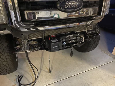

Ordered the Amazon/ebay hidden winch mount for 11-16 super duty, it works on 6.7s, despite the disclaimers. However, I did have to sell my Warn M-15 because the barrel was too large and collided with the radiator. Bought a 15,000lb winch from Carbon Offroad, better specs than a lot on the market for a very fair price.
Finally had some time this weekend to rig it up, and despite “bolt in”, I had to trim a shit ton from all over the new cradle to clear the bumper.
That said, it’s a super compact unit, 7hp motor, fast line speed, wired and wireless controller, less than 60lbs all in.

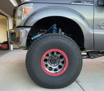

Looking for advice:

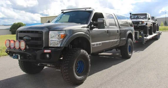

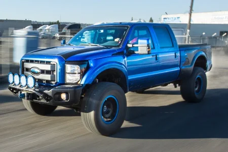

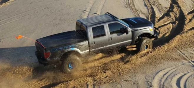

Been going back and forth on fiberwerx fenders for the last year or so. It already has pulled bedsides, and I have about 2.5" of tire poke which is generally fine, but when it goes into the dirt, or even muddy pavement puddles, it blows shit all over. I had bush whackers on it when I bought it, and while they helped, but they're just so gross looking. Clean lines are king. They're 3.5" over, so I'd have 1" of overhang.
I'm really trying to avoid buying them, not liking it, and then having to sling them on marketplace for a big fat dong of a loss. Diesel Power Products built this over 10 years ago. They later wrapped it blue, but coincidentally it's the same color as mine underneath. (I believe it's since been totaled RIP). Is it worth the hassle?
What does the BLGT braintrust have to say?
