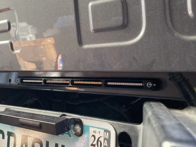

Happy birthday to me. I asked for, and received, this bitchin chase bar from Litt Industries. Was drawn to them because they're super small and can be tucked away and mostly hidden. Haven't seen much about this company, I think they're mostly in the UTV scene, but quality seems to be top notch, so far I'm pleased. Can be wired up to all normal rear lighting functions: turn, reverse, etc. Thinking about mounting it up in that gap between the bottom of the tailgate and the bumper, but I'm open to other ideas.
Will report back with feedback when it's functional.
https://littindustries.com/products/12-slim-line-chase-bar
I posted a picture of a similar bar I put on a ranger in the other thread, but forgot to add that it would look slick frenched into the tailgate above the handle. It's an expensive tailgate to chop up, but would be very unique and functional.

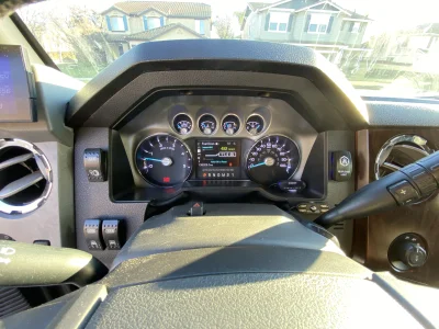

Got the light all wired up, super low key and does exactly what it said it does. Mounted the switch on the dash, a switchpro or spot or whatever would be good for all the shit going on, but it's easier to just keep with the theme. And it doesn't look TOO out of place. I'll put up a video after it's dark.
