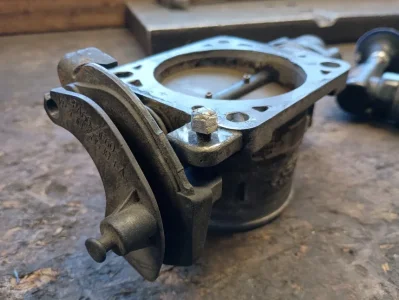

2 the IAC tuning
i can get it pretty good in tuner studios but it will wonder after a while and get either hunting or try real hard to get another 100 rpm while i am on the brake at a stop light. i am cheating for now and going to run the throttle blade stop at engine temp and see if it can just pick up the cold start and in gear need. i welded a nut on the screw....
