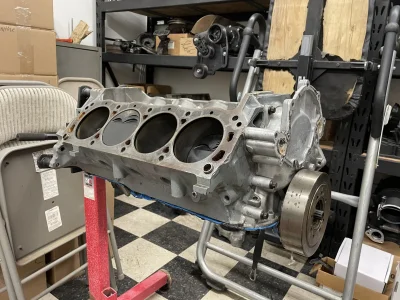

As for myself Iv been slowly collecting parts this past years to build and swap in a new heart for the bronco , only waiting on the final few pieces of the puzzle ( ordering engine parts during Covid has been a nightmare) .
It took me a while to commit to what I wanted build , ping ponging back and fourth between ls swap and staying with the nostalgic Windsor platform I decided to
Go ford .. for a few reasons ,1 Iv already build a few Ls and wanted to experience and experiment with a new platform , 2 I thought it would be cheaper ( it definitely isn’t ) and ,3 I really want to maintain as much nostalgia with the truck as possible ..
Engine break down:
The short block and the only used portion of the engine is a low mileage 347 stroker , scat 3.400 crank and rods with probe flat top pistons . BA862446-3106-4F56-9737-B69CDAB2A5C8.webp395E5432-1C9C-4581-B42A-D2BF62D8F6A1.webpThe engine did come set up with flat tappet lifters and cam but I’ll be swapping those out for some lunati hydraulic roller lifters and custom grind roller cam .32E1B063-F276-427D-98F5-D0B6A915658F.webp

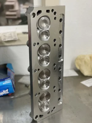

The heads are the pride and joy of this build full CNC ported 165cc AFR renegade heads . Not the biggest port size but should help build a healthy torque curve . I think they flow around 270cfm at 600 lift . Not wild in comparisons to LS head flow charts but should be plenty for this little engine . The head chamber size is 58cc , that paired with the 3.400 engine stroke , flat tip pistons and a .052 compressed head gasket that should put the final engine compression to about 10.6:1 . 64D64E89-48D8-4FB9-913F-CF6E3775D3E8.webp6D622A8F-348A-49DC-A8C7-DEFBC34FFD55.webpRoller rockers are a must6C85E5ED-2F07-4D59-855C-07EB21B3A88C.webp

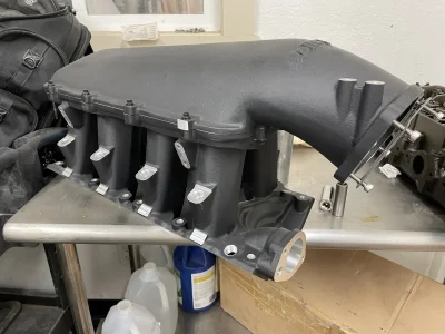

And to top it off I’ll be running a Holley high ram intake manifold .. I’m a little hesitant to see how this manifold will play out .. it’s a pretty large volumed short runnered manifold even though it doesn’t really look like it .. my guess is it might hinder the torque a bit but I just can’t stand the look of any other sbf multiport manifold so I took the gamble .. I also like that it’s set up to run and ls throttle body. 0000553D-9500-4E13-A8A8-195C74BAB222.webpE2DDFA8A-1BB7-48AB-B195-2B5937E7F5FF.webpAnd all of the above with be controlled by the Holley terminator systemD8D256AA-3FDF-4B0E-A9D4-4863F42FD5C7.webp

Dope dude! Should be so much fun with more ponies. Do you have torque and hp numbers you’re shooting for?
Thanks dude ! Honestly I’d guess it would make between 400- 450 hp at the crank and probably 400 ft lbs . Depends on how much I want to spin this thing and how much timing to throw at it . I’d be stoked with stoked with 400hp ! That’s double what the stock 5.0 is !

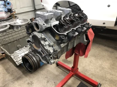

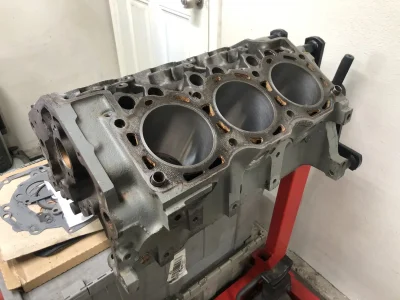

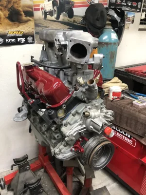

2.9l OHV
This was the most in-depth I’ve ever been rebuilding an engine solely on my own.
Ran a simple ball hone. Replaced all bearings, rings, and seals
Replaced heads with brand new castings from King Cylinder heads. Rebuilt/cleaned lifters. Somebody ported the hell out of the upper and lower intake manifolds.129BC2CA-4D3F-4044-BEB2-E57BA42CF042.webp

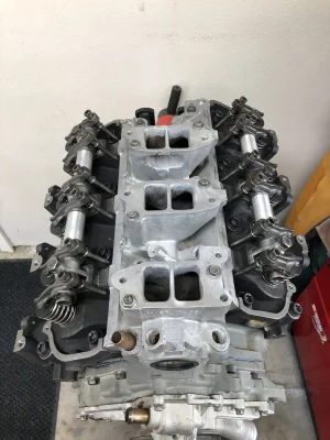

Removed the springs from in between the rocker arms and replaced with aluminum spacers.
All buttoned up and ready to drop inB979EBB4-2F9E-4244-915F-39EDD80028D5.webp

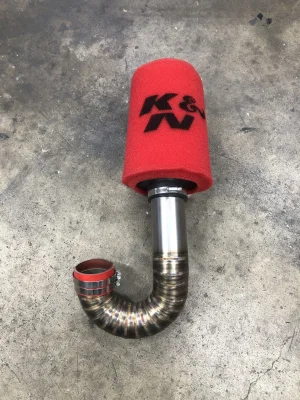

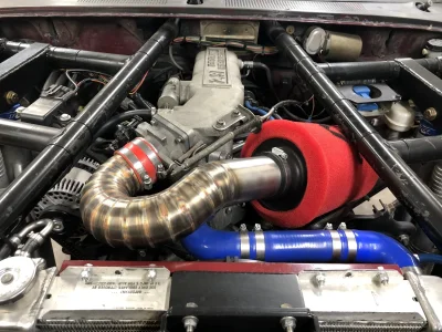

I couldn’t fit a U-bend in with my cage tube, so I opted for the lobster tail look.785E1631-3CB9-480A-9A5B-102A8C2EDB7C.webp

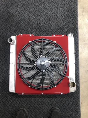

Replaced the mechanical fan for an electric to squeeze out the little bit of HPees this thing has. First time building a shroud. Not too shabby.
2.9l OHV
Replaced heads with brand new castings from King Cylinder heads. Rebuilt/cleaned lifters. Somebody ported the hell out of the upper and lower intake manifolds.View attachment 1260
All buttoned up and ready to drop inView attachment 1262
I couldn’t fit a U-bend in with my cage tube, so I opted for the lobster tail look.View attachment 1263

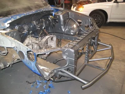

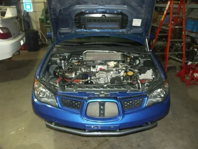

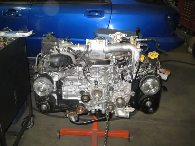

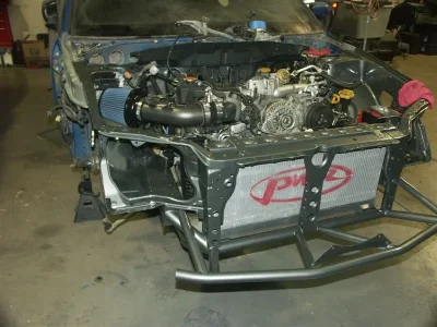

Pics from 2008 rebuild.

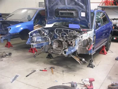

A little lawn dart action from some desert fun munched the front of the car and a torn air filter killed the motor. Pulled dirt in, destroyed the turbo and everything else inside the engine got a not so nice sand blasting.
Ended up with a nice rebuild, forged internals, ported intake runners, head studs and a turbo off an STI. Got a nice solid tune, somehow passes smog with cats on, but it really needs to be torn down again and repainted. Wouldn't be a bad idea to go through the motor again, it uses a bit of oil these days.
IMG_1566.webpIMG_1546.webpIMG_1547.webpP1000008.webpPICT0500-1.webpPICT0501-2.webpPICT0502-1.webpPICT0504-1.webpPICT0509-1.webp

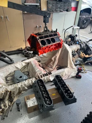

Currently freshening up this 6.0 LS. So far I have it torn down as far as it's going to go. Keeping it stock, just some preventative maintenance via new oil pump, rear main seal, oil galley barbell chingadera, and lifters. Should look good, and hopefully work good, when it's in the prerunner.
