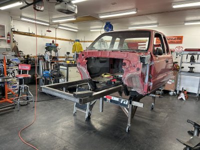

Pretty easy. It’s just a push pull cable from a winters/artcarr shifter. Second one I’ve gone through because it runs so close to the exhaust.How hard is it to replace the shifter cable - are you running a gated shifter or are you referring to the kickdown cable (you even have a kickdown cable - they may have disappeared in 99-00).
It’s not necessarily melting. It’s heating up the Teflon or whatever is inside the cable that keeps it sliding smooth and just makes it hard/sticky. I thought I had a picture but can’t find it. I wrapped this last one I put in with some heat shield but it runs right next to the exhaust (which is also wrapped).Where on the cable is it melting? have you tried wrapping it in dei/whoevers heat sleeve stuff?
If it is at the end, can you grab a threaded rod and use that to push the cable sheath away from the heat source?
