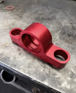

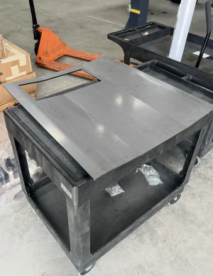

So as I’ve mentioned, I’m pretty over bashing stuff under this truck and killing drivelines. So here is my solution. 1/4” thick belly plate that will hold one of MitchMade’s carrier bearing at the back. Likely going to put 3/8” UHMW on it as well. At droop it picks up the middle of the driveline about 1ft. The opening is for the atlas to poke through, it will be plated in also once I mock it up.
